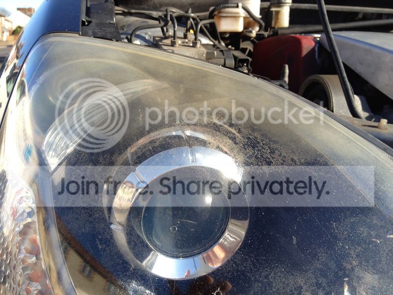

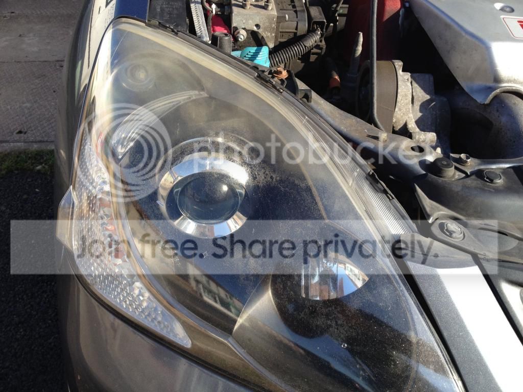

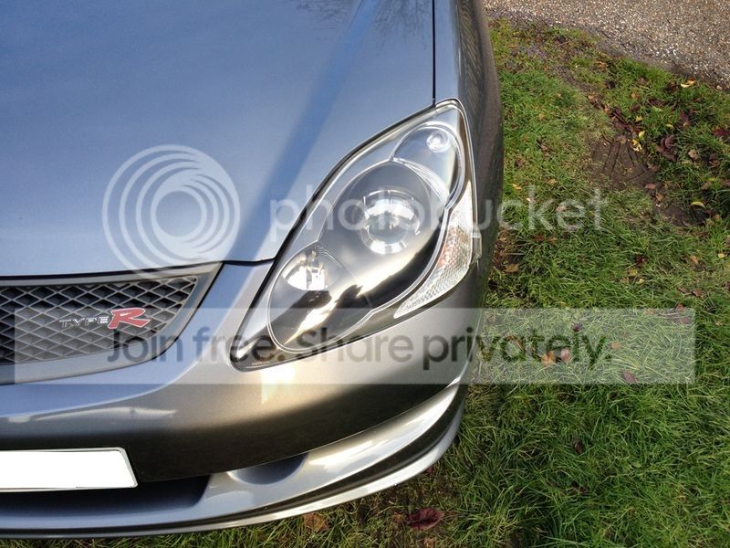

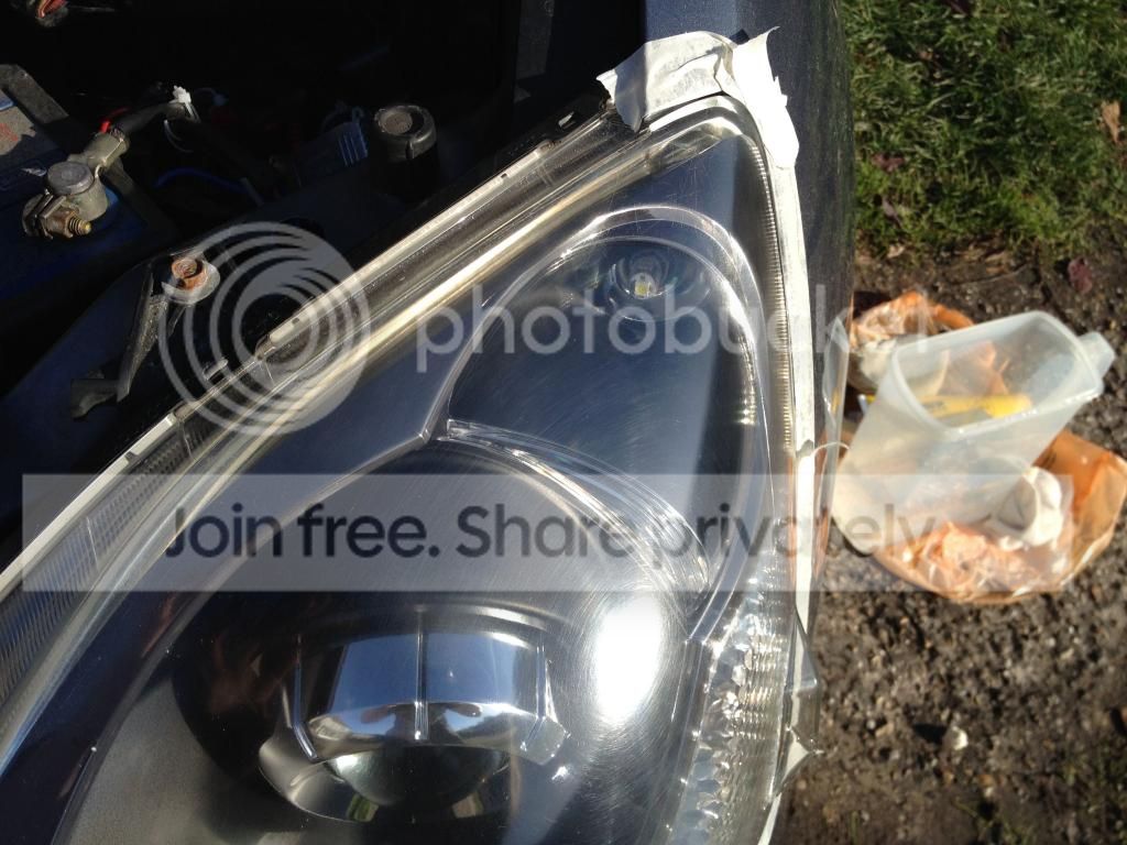

Here is what they were like to start with and a common problem with EP3's (only remembered to get a photo of the drivers side before I started but gives you an idea what they were like):
AND

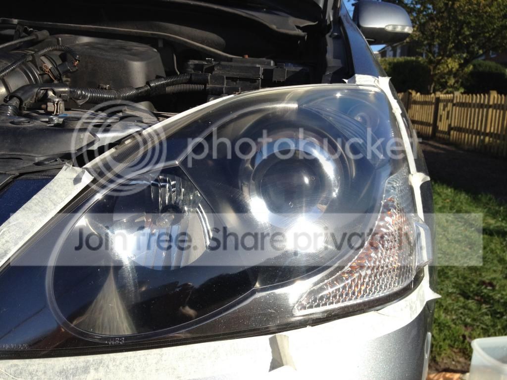

Firstly, I cleaned each light off with clean water and wiped down to get rid of all dirt. I then masked off the lights using masking tape. Apply the Halfords Rubbing Compound directly to the light and using a damp cloth work the compound into the light in a circular motion applying even pressure.

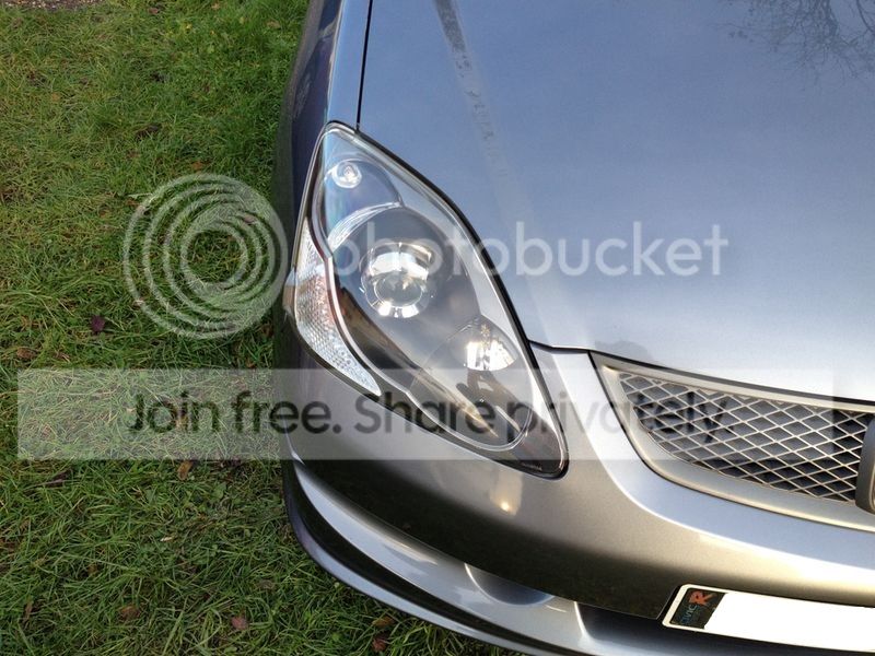

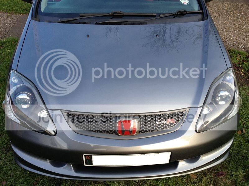

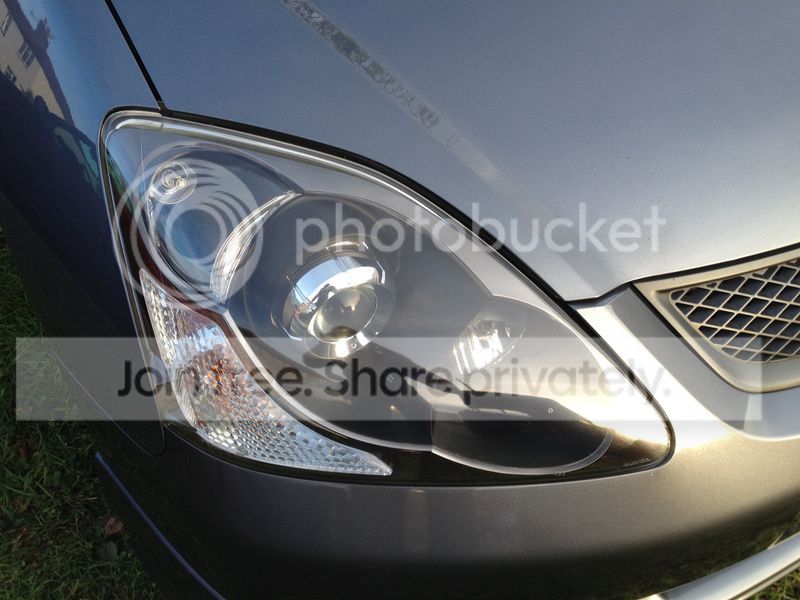

Eventually, when the compound becomes a light powdered layer, remove with a clean dry cloth. At this point, re-assess the affected areas and repeat until the lights look like new! ...see below:
To finish off, I then used car polish to buff the lights off to a new shine.
Getting brand new lights for £3.99 and 2 hours work is totally worth it!
