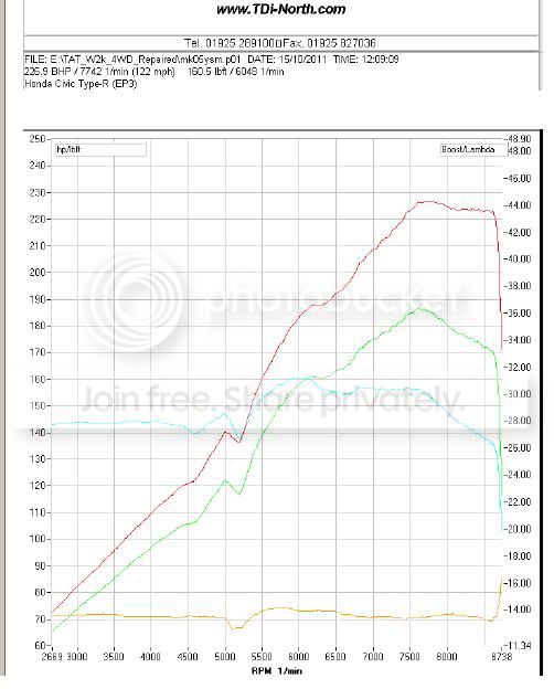

As far as my Mods go for engine, I've installed:
Engine (230bhp)
ITG Maxogen
DC Sports Racing Header
Fujitsubo Rm0-1a
Quaife LSD
Stage 1 Competion Clutch
Hondata k-pro
Apart from the RBC I was struggling to figure out what else I could do, trying to keep in N/A. Cams and Pistons was all else I thought of :scratch:
I will say that, with the K-Pro The car feels great. In my opinion, the best mod that I have done so far is the LSD. Its great being able to get the power down, especially when pulling through a bend!! :smile:

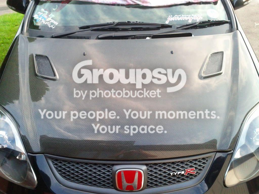

well since our summer finally came even if its in october :eek:
iv bought some powerflex exhaust mounts as iv split one of my oems
i also decided to spray the grills on my carbon bonnet as i dont like the silver mesh
firstly i masking taped the area up and used a newspaper/leaflet to cover the bonnet to avoid any over spray.
then i rubbed the mesh down with some ruff sandpaper to key it
then i sprayed the mesh area lightly with grey primer leaving it to dry inbetween
then i gave it 4 or 5 light sprays of metalic grey paint leaving it to dry in between coats
once dry i gave it 2 coats of clear laquer and left it to dry

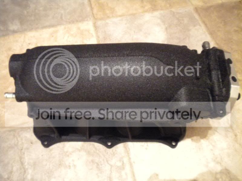

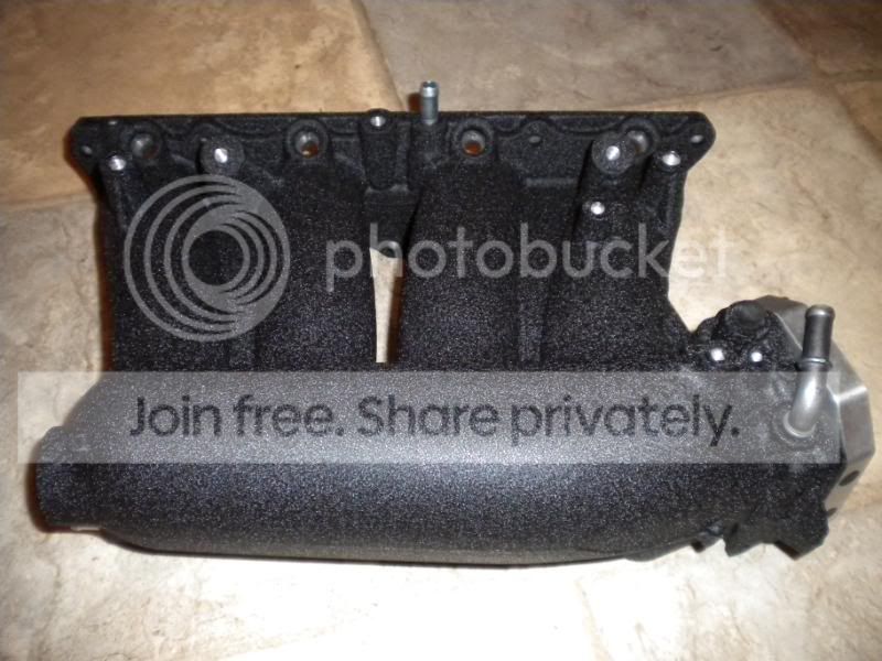

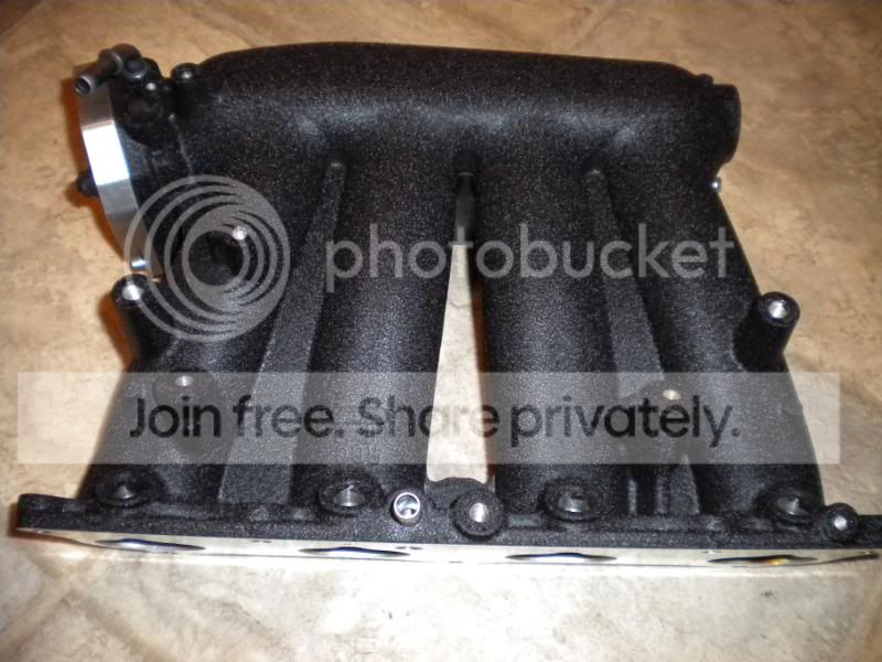

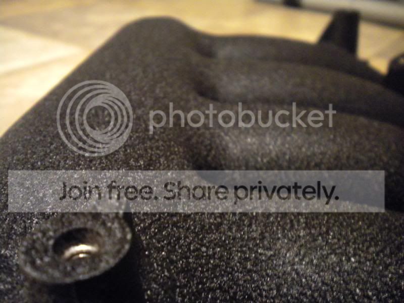

Just a quick update IV purchased a RBC intake manifold, tegiwa thermal TB gasket and a hondata gasket IV booked in at Tdi-north north next week for the rbc and a map hopefully It should improve the car hugely
I bought the rbc 2nd hand off the site and it came full of deep scratches and it hadn't been looked after
so I sent it to bren who's worked his magic and done an awesome job of refurbing it, I think it'll look awesome in the engine bay once fitted
Let me know what you think
