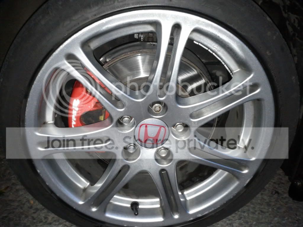

Yes i did it with the calipers still on the car i read the how to-remoce brake pads I removed the brake pads then I sanded down the old paint till smooth, masking tape the brake disc and spray everything with brake cleaner.
When dry I painted two costs of red etech brake caliper paint and left to dry
Sorry its a vague description but you get the jist

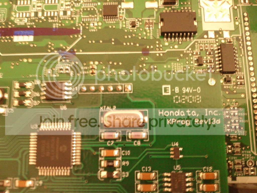

ctr-lib wrote:
Newannaive wrote:Nice one...I also ran the cal. when I first had kpro. :bigthumb:
Cheers fella
Did you ever use any other naps other than the tuned k20?
Ill be heading to tdi-north once IV collected some cams and rbc
I tried the rsx map but tbh the tuned cal. you have on at the moment was the best one.
