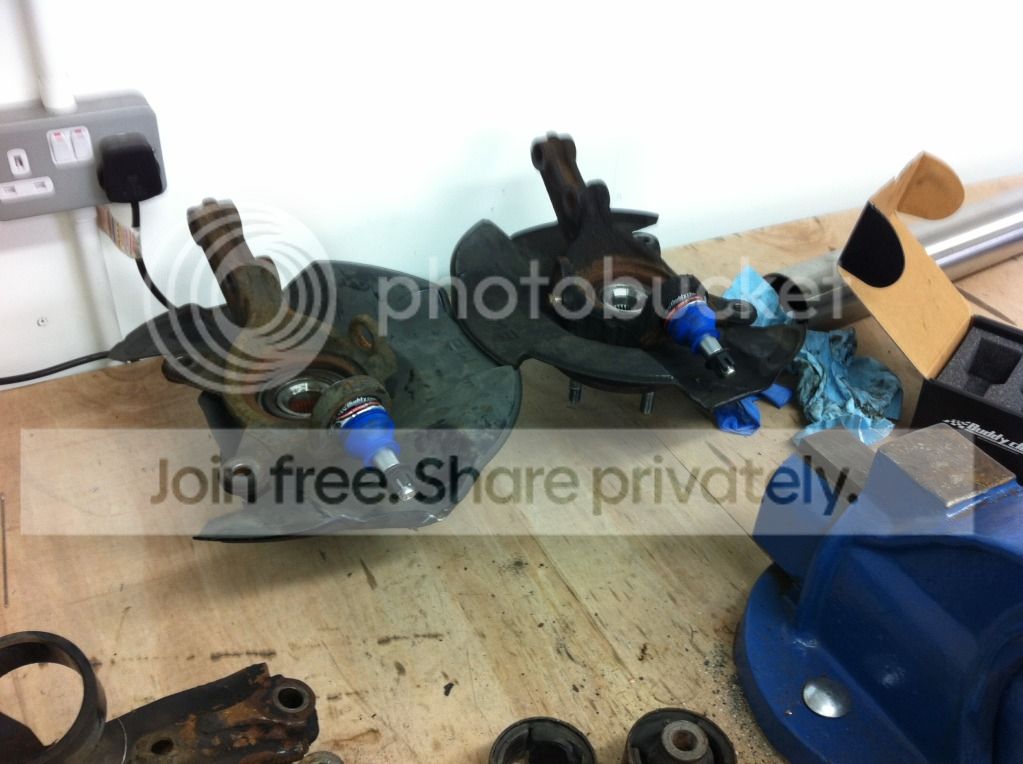

I have the straight steering arm, which will hopefully reduce bumpsteer when its lowered.
The DC5 Meister's come with 10kg/mm spring rates front & rear to eliminate oversteer, whereas the EP3 has 8kg/mm front & 10kg/mm rear as the civic tends to understeer.
I have been in contact with Meister & they assure me I wont have a problem with the slightly harder front spring rate from the DC5.
They can supply me with the 8kg springs if I really want them for £30 each.
I think I will stick with the 10kg and see how it goes, besides £60 isnt going to break the bank if I really dont like it.
Just need to hunt down some DC5 trackrod ends now.. Shame I have just bought some brand new EP3 ones!

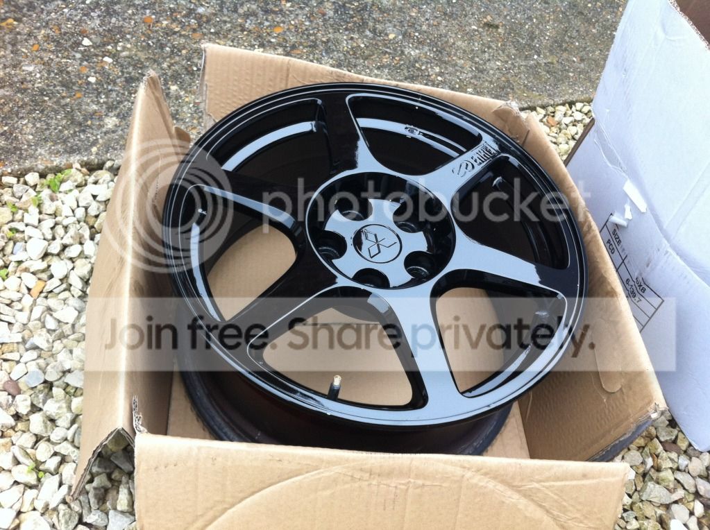

I managed to pick up the wheels from an evo forum & I got the coilovers as a second chance offer on ebay as he was messed about by the winning bidders.
