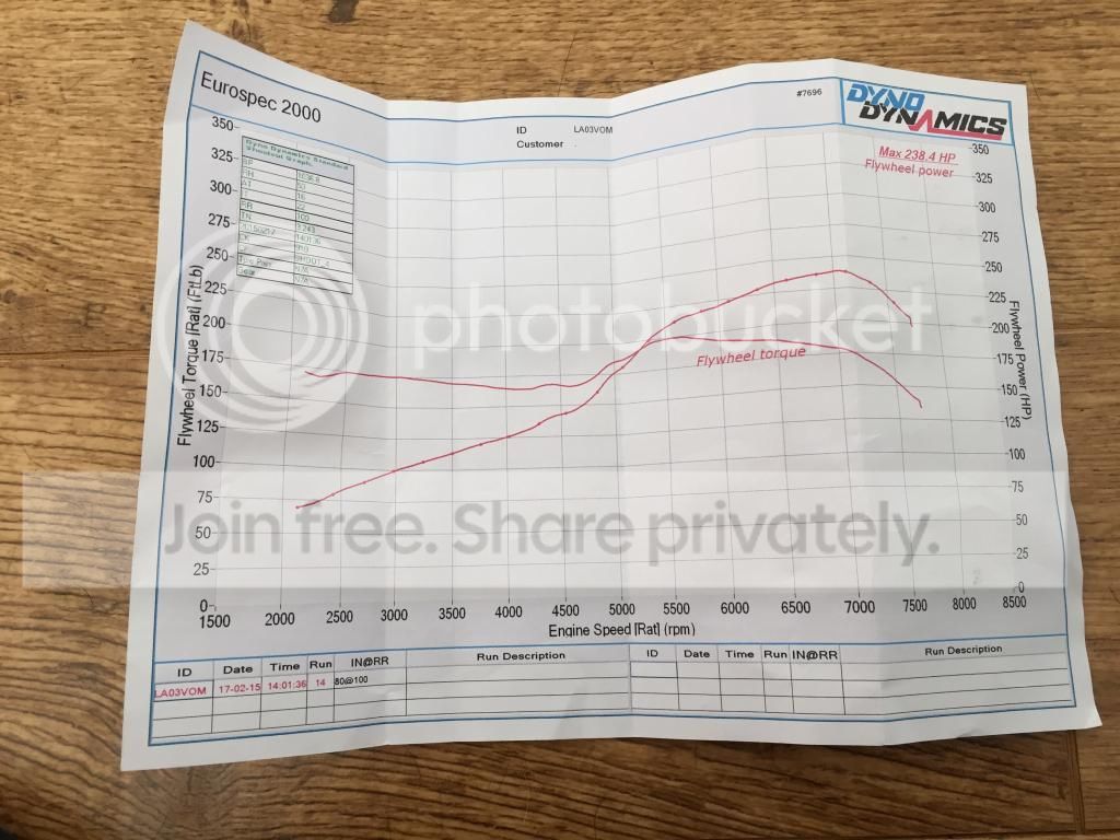

Had my car mapped by Romain yesterday. I'm pretty happy with the results.

You might want to add the build spec?

Oh yeah sorry the spec is
Rbc
Dc header
Silenced 2.5" b pipe
Teg m
K100
By baddohc
#3821602
Good torque figures but there is so much more in this setup!
3" exhaust, Better exhaust manifold, 70mm TB with RBC port matched, Cams
Will be seeing 270ish BHP - 210-215 torque.
What injectors are you using? Got a K24 build due to be done myself soon.

Romain said the oem back box was holding it back a bit. I'm just not keen on loud exhausts.
I believe its on the stock injectors

You may want to go for slightly injectors too, if your happy as it is that's fine but there are ALOT of gains available with this setup. Seems like all the effort and cost to basically get back the least amount of poke!

yeah exactly, my bolt on K20 makes more than this, except for all the low down torque ofc :P

If I was to do anymore to it I would probably just turbo it :cool:
Romain said the k24 rarely makes more power than the k20 it's just a lot nicer with the extra torque.

Issue with the K24 is you lose revs. The peak power here is around 7k whereas on a K20 the peak power is well over 8k depending on set up.
