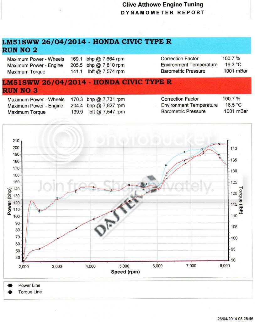

The Ep3 is stock, apart from tegiwa airbox. For those who say it's not worth the money, well it surprised me with it's gains. I was expecting 1 or 2 bhp more than stock, I got 8!

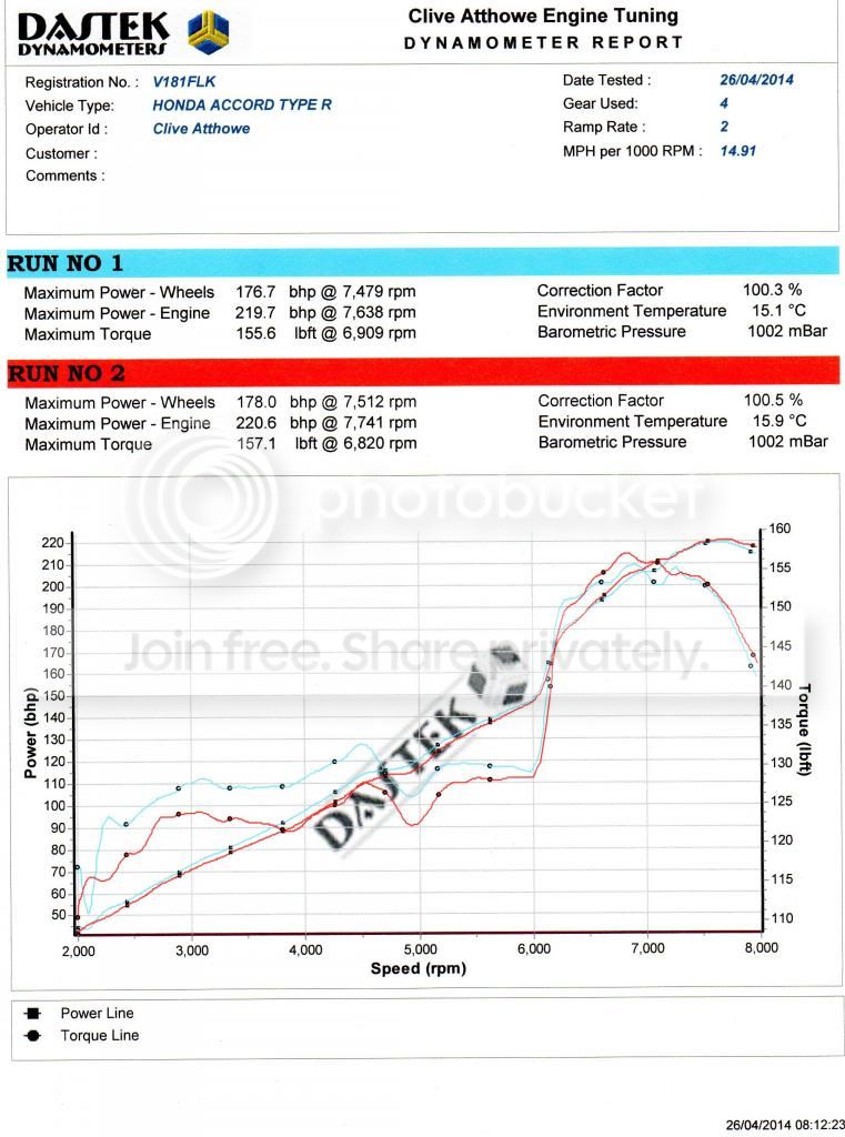

The Accord has a long ram typhoon, solid fabs downpipe, 200cell highflow cat, and a solid fabs catback. Was blowing from a hole in the downpipe, which decided to appear 2 days ago! This didn't seem to affect high rpms much, but did cost it at lower rpm.
