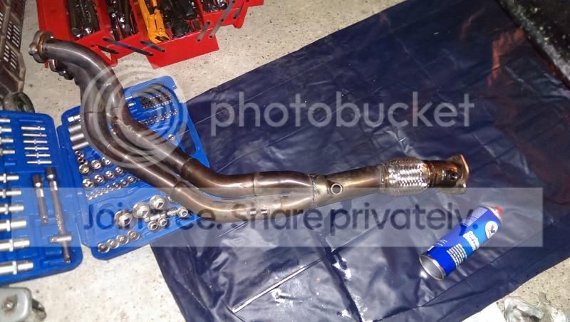

pulpmelon_r wrote:Great to see some serious gains from the bigger header.
As soon as VTEC pops the torque comes in spades!
Cheers Phil [smilie=karls_thumb.gif]
Header worked a treat and completely eliminated the issues I was having with the piper
Still some work to be done with the intake & throttle body but the car feels so much more lively now.
Feels quicker than it did this time round than when the cams were done, massive difference.

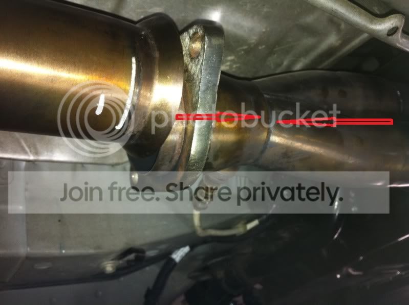

*nub* wrote:2.5" collector?
now, I use this cheap crap cinese header for about 4 years.
performance vs money ok but the build quality is just crap and I had to weld (more money time and hysteria spent instead of buying a proper header) all the parts , even the test pipe to the header to stop the gas leaks from the header gaps, joints, etc etc ....
not to mention the misalignment problems with the rest of the exhaust ....
... but, what`s the point using a true 2.5 collector and catback with this header when it's narrowed down to cca. 55mm in this section?

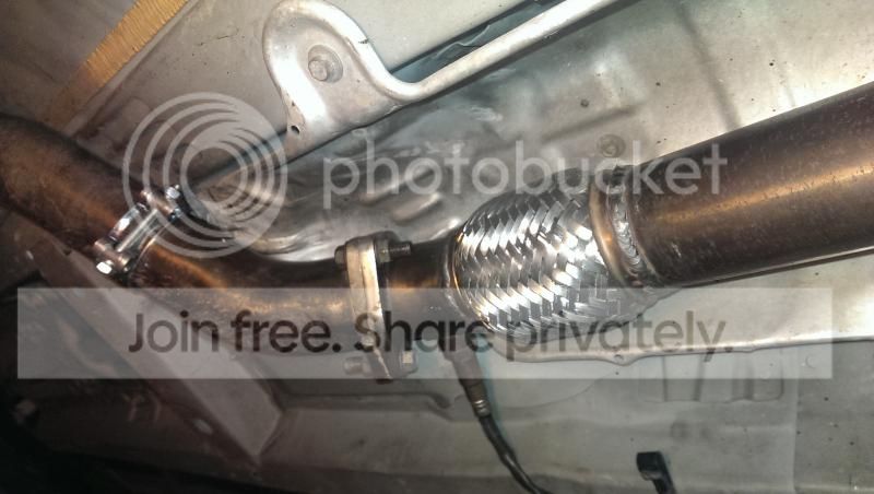

LE
misalignment solved , flexi pipe added and eliminated the 55 mm ring,
