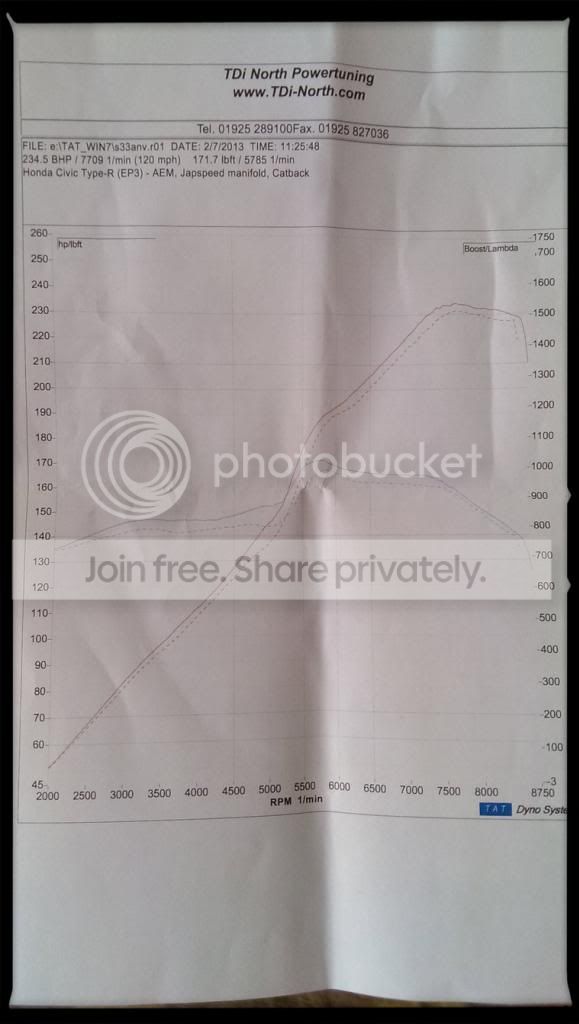

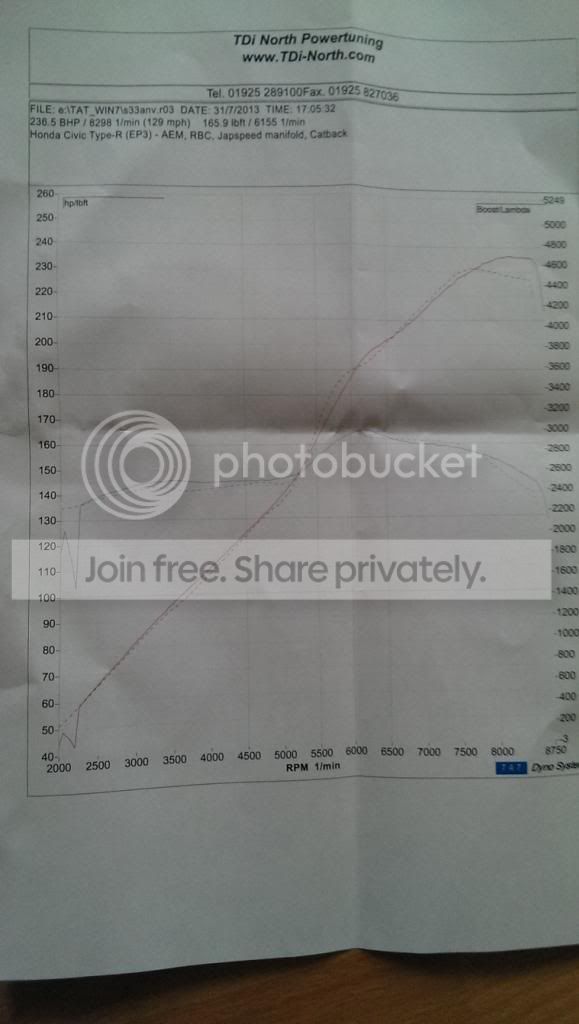

* Buddy Club Spec IV
* Japspeed 4-2-1
* AEM CAI
Might not be a lot but, it does feel a lot better to drive thanks to Paul.
Skunk 2 Intake manifold next on the list!

pulpmelon_r wrote:It has been 25 degrees and mad humid most of this week.would that make them run a bit richer in the summer?
Run it again in january and you'll make another 9hp

Lewisgame wrote:Lost nearly 6ft/lb of torque with the rbc.Lost 6 at peak for a couple hundred RPM but if you look at the curve on both graphs you will see the car has actually gained torque in the higher revs thanks to the RBC
