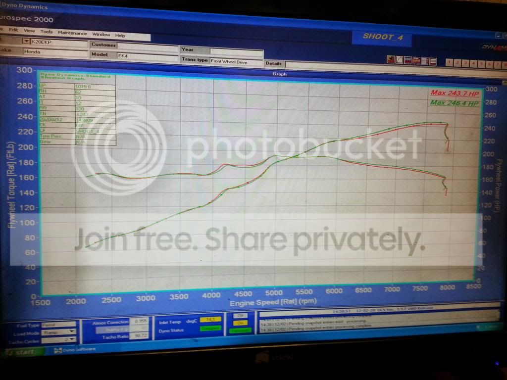

It made 246bhp and 196ft/lb
The mods are standard k24a3 bottom end with k20a2 oil pump, k20a2 head, fd2 cams, rrc inlet port matched to skunk2 70mm tb, pw jdm carbon intake with velocity stack, r crew k swap manifold and 3" exhaust
