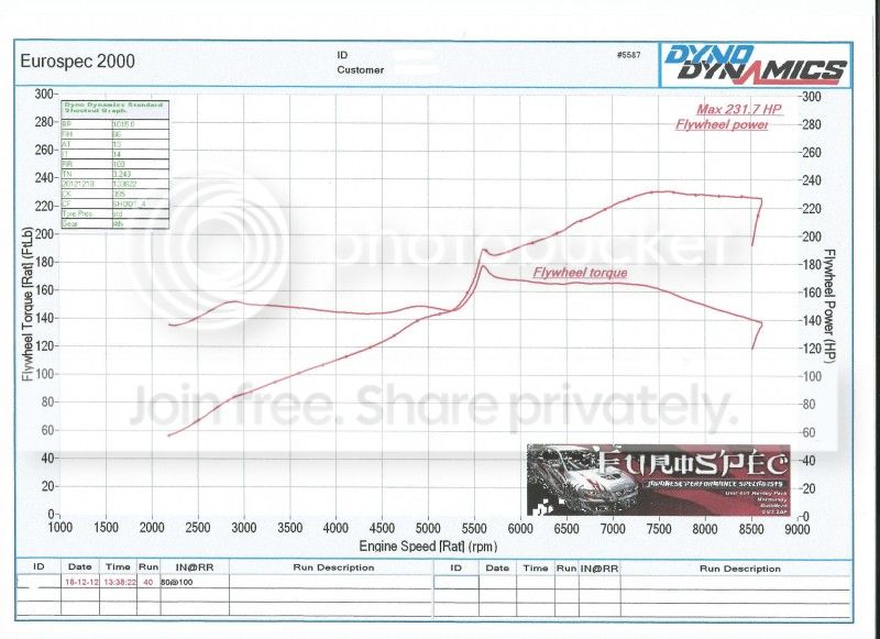

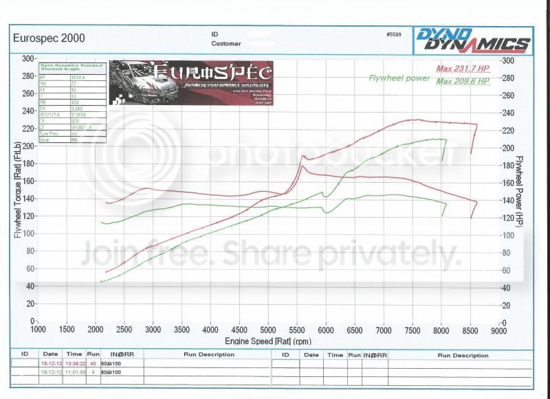

Good result but as T180985 mentioned the torque curve is not very smooth
179 lbs ft is great but you have it for what 100/200rpm and then it drops to 170 and then again to 165ish
Not knocking it but it's all about a smooth torque curve when it comes to tuning, difficult to achieve all the time but I think if you get yourself an RBC intake manifold it should help flatten out the mid-range torque [smilie=karls_thumb.gif]
By TDi-North
#3525714
RBC's a top mod. See where your plot flattens off at 7500 thats where the RBC sarts making power. It looses a bit lower down but shifts power band up and holds torque longer. You will see about 10bhp at peak with that and you can feel it pulling all the way where at the moment you will start to feel it die off at top end.
Get it done then back to Romain for a tweak. [smilie=karls_thumb.gif]

Good results without an RBC, I had similar with my 1st set up without an RBC, 239.6bhp & 168.4 lb/ft, your torque is very good :salut:

Peak torque is good but the curve is fairly poor
Get an RBC mate [smilie=karls_thumb.gif] you won't be disapointed
