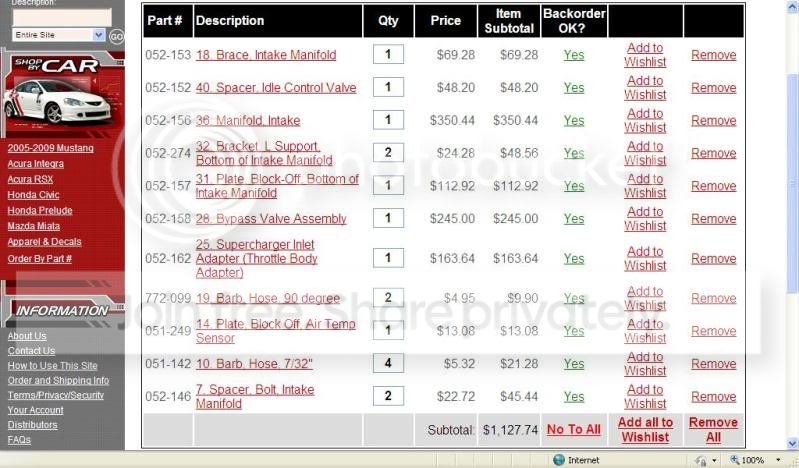

DC5/RSX Inlet
This on it's own, without changing anything else on your EP3 is only worth 3-5bhp @ 8psi, but works well when paired with a shiny new set of cams. However, the outlay to convert your EP3 Inlet to a DC5/RSX Inlet works out to be around $1,127.74 plus shipping (current prices) when you've purchased all the bits you need. You'll have better drive-ability at part throttle due to higher torque at lower revs also. The cylinders will have better etg's due to better flow and the supercharger whine will be quieter.
So with more aggressive cams and the DC5/RSX inlet you can bump up another 20bhp (circa). However, with the DC5/RSX Inlet you can...

For those interested in converting your EP3 JRSC into a DC5/RSX one you will need the following:
Good for anyone who's charger has cracked. :thumbup: Just go the whole hog and upgrade everything.
