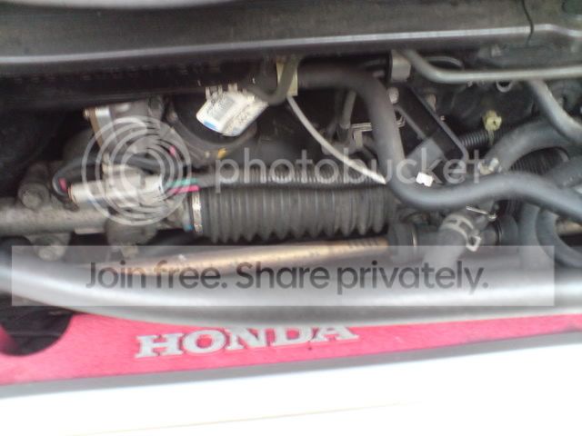

djtopa wrote:Can someone of you please answer quest I asked here?THNX :thumbup:if you look down the back of your engine you will see 2 rubber sleeves on each side of the steering rack...roughly where the 2 yellow lines are below..

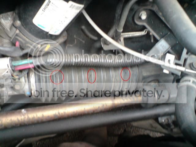

OK,I looked ,do U mean here where I make red cyrcles(sorry 'bout bad English),at the and of steering arms:
RM CYA wrote:if its only rubber that your peircing to lube the inside if the rack , why dont you put a dab of super glue over the hole to seal it up... if worried about crap getting in. it seals rubber nicely!!! good to know this fix chaps :thumbup:theres really no need to glue the slits up or worry about it at all...it will need doing again in the future so just use the same holes.

MattyMcRae wrote:hmmm ok ill do more holes and spray more in this time then like you have.. i have only nervously done one hole each side and a quick squirtaye, more spray matey, really give it a good soaking.

here's a couple of pics of where I pierced the steering rack boots to spray wd40 inside. Turn the steering to full lock so that it opens up the pleats in the rubber boot. This is a couple of pics of the drivers side of the rack, just do the same to the other side. It is best to check with the can of lube that you can actually reach whereabouts you are going to make an incision beforehand, as the passenger side is a bit harder to get at. Each incision was done with a new stanley knife blade and is about 2-3mm, once you withdraw the straw it virtually re-seals itself. On each incision spray towards the centre of the rack and give it a good 5-6secs spray at least.
