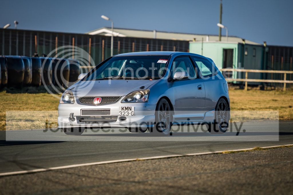

More up to date Spec some items yet to be fitted there are probably still a few items I have missed
Chassis
SW Motorsports Multipoint cage
Welded Seat rails through cills
Recaro SPG Bucket Seats
Cobra Side mounts
Sabelt Harnessess
Flocked dash
Radio Delete
Aerocatches
Thinned wiring loom
Lightweight door cards
TRS Door Pulls
Seam Welded Subframe
Lightweight Cabin Heater
Sparco Swede Steering wheel
NRG Boss Kit
I Shift Shift Light
Jazz Washer jets
Ally Navigators Foot Rest
Ally Foot Plate Drivers
Ally Pedal Extensions
FIA Cutout Switch
FIA Pull Cable Cut out
Lifeline 2.25kg extinguisher
Engine/Gearbox
8psi Jackson Racing Supercharger
650cc Rc Injectors
Quaife ATB LSD
Area Motorsport Mocal 25 Row oil Cooler
Clockwise Motion Baffled Sump
DC Sports Racing Manifold
Supersprint B Pipe
Energy Engine Mount Inserts
Tegiwa Short Shifter
Tegiwa Shifter Bushes
Power flex Gearbox Bush
Hondata K100
Mugen high pressure rad cap
Competition Clutch Stage 3
Magnetic Drain Plugs Engine and Gearbox
Innovative Engine Mount 75db
Brakes
Hel Briaded Brake line kit run inside car
Tilton Bias Adjuster
Compbrake Hydrualic Hand Brake
40/40 prop valve
ABS removed
Brembo 4pot calipers
Projekt K Brackets
328mm Grooved Discs
Ferodo Ds2500 pads
Wheels
17x7.5 Rota Boost
17x7.5 Compomotive TH2
17X7 OEM Wheels
GT27 Wheel Nuts
Yokohama Parada 215/40/17
Nangkang NS2r 225/45/17
Misc
Fully Stripped Interior
All excess brackets removed.
Aircon removed
Standard Brake lines removed
Sound deadening removed
Engine bay trims removed
bulkhead sound proofing removed
interior stripped
Dashboard cut down.
Excess dash brackets removed
Handbrake removed
Handbrake cables removed
Undersealed
Radio Removed
Heater Matrix Removed
NRG Carbon Canards

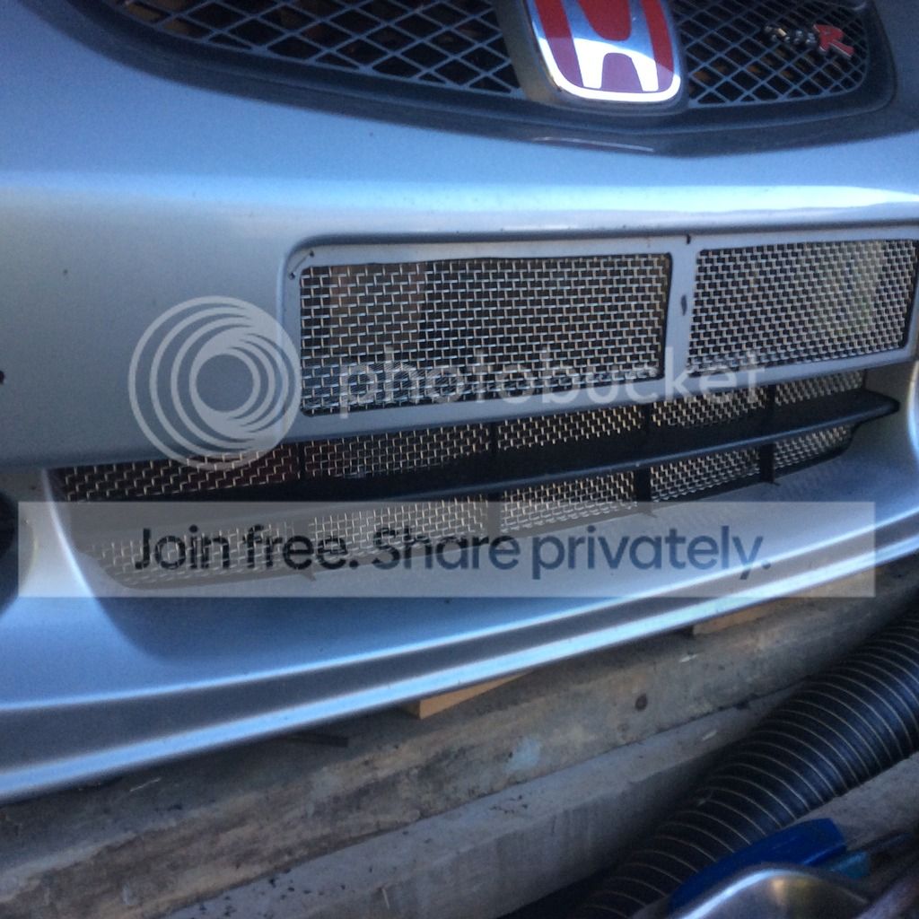

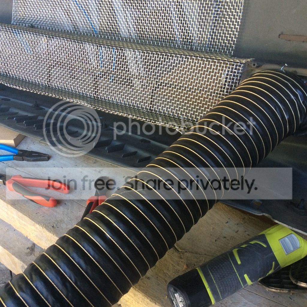

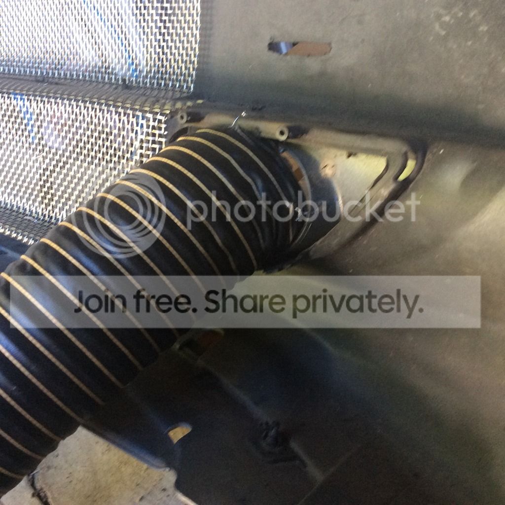

Small update today with a couple of pics
Debadged the rear
Fitted battery cut out switch ready to wire up
Fitted pull chord

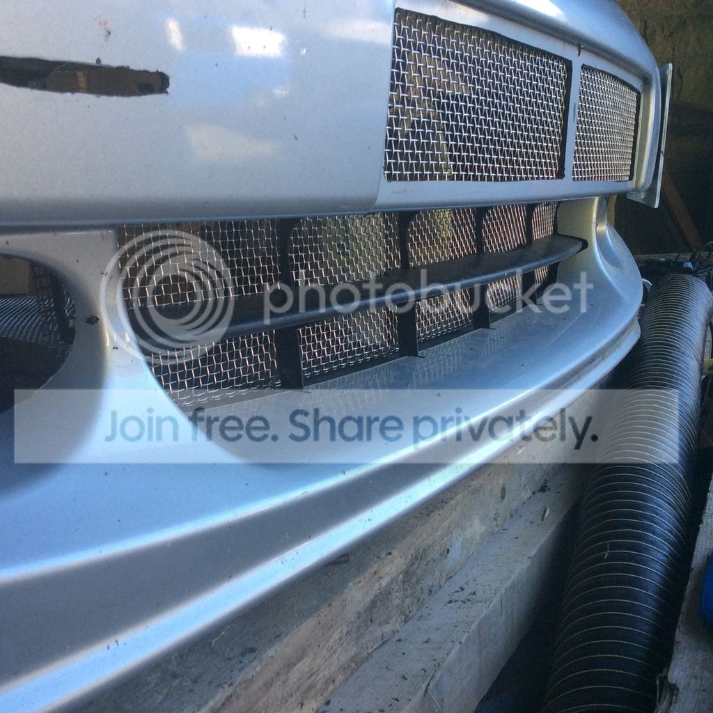

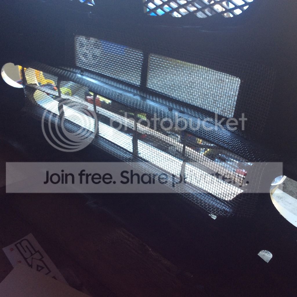

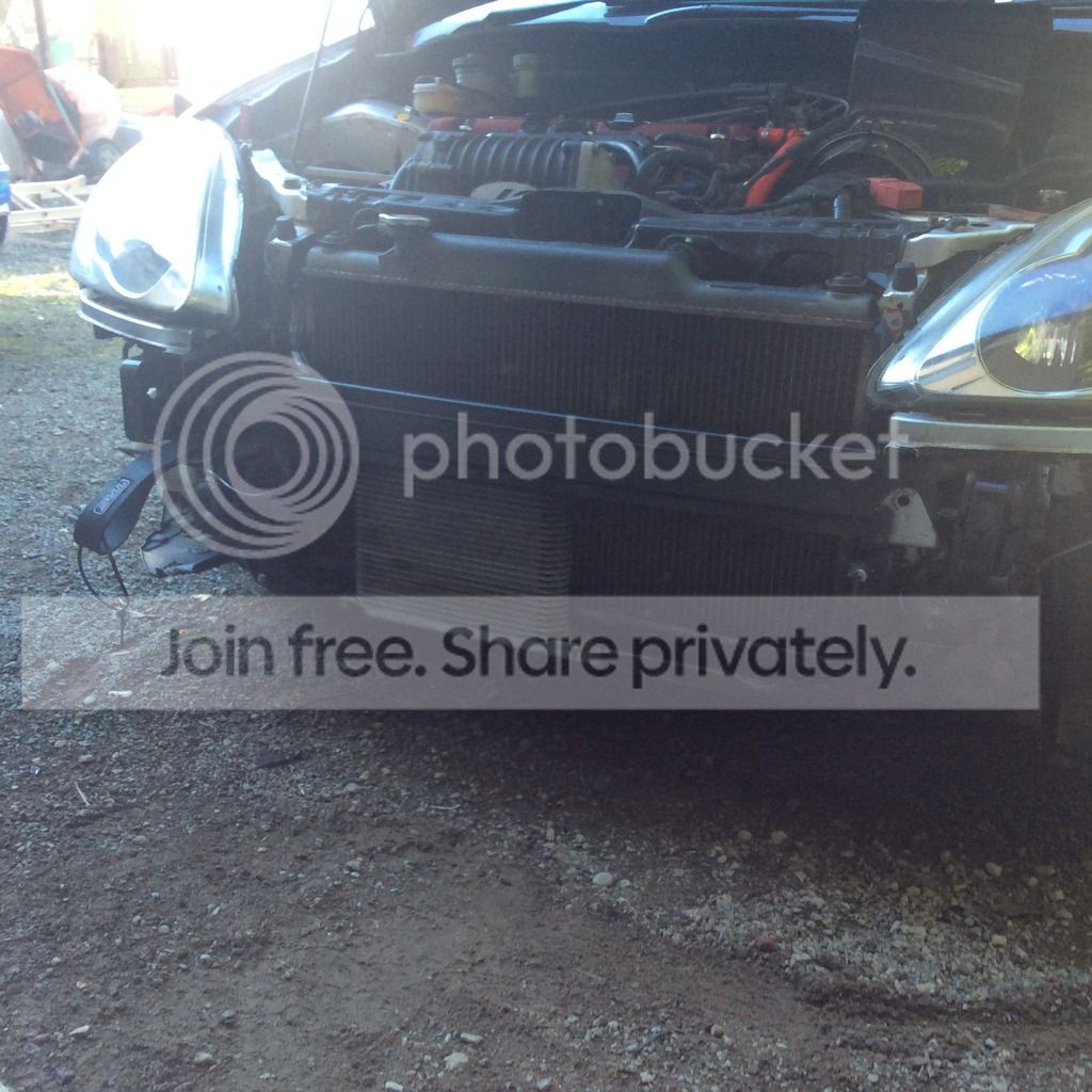

Meshed front bumper to stop the rad and oil cooler getting peppered
Fitted brake ducts
Fitted tow strap
Removed rear bumper ready to cut down and hole saw

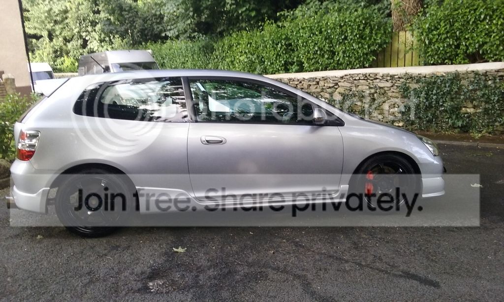

Didn't get any jobs done this week took the silver car out for a run feels so special to drive ace fun
The type r tribe
Couple of poor quality pics before it went back in the garage
