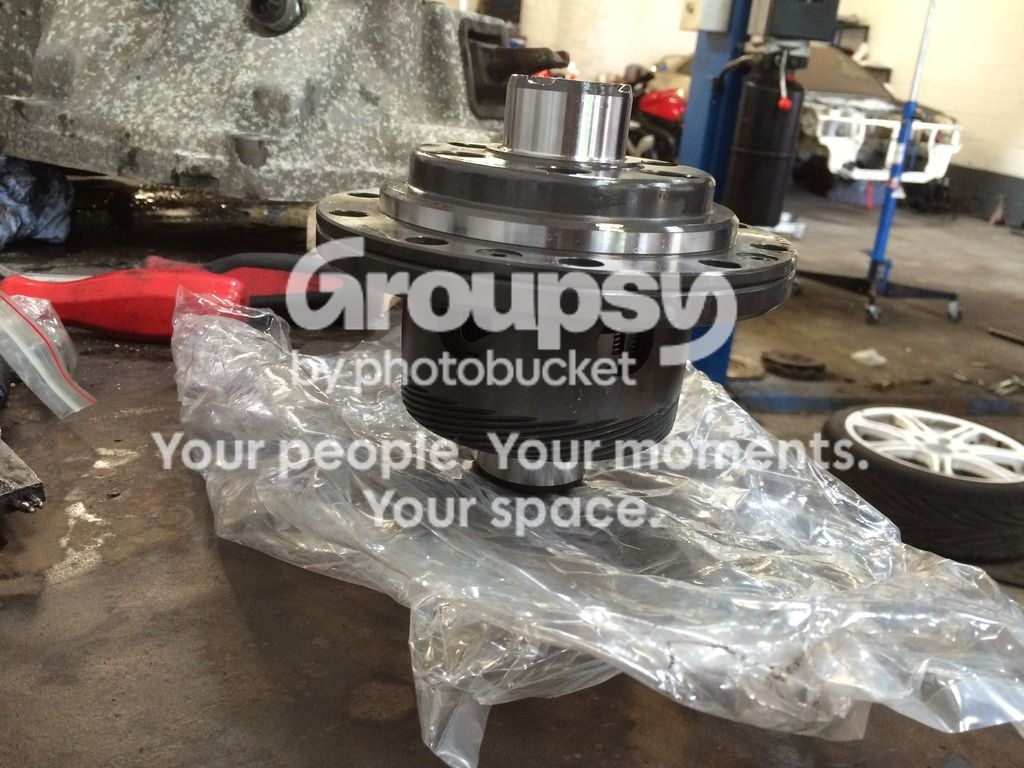

Yesterday I went to Area Motorsports/Brosport for some work-
1.5 Mfactory Plate LSD
Exedy Clutch
Fidanza Flywheel
Full polybush
Innotive engine mounts
Rose jointed tie rods
Tegiwa 24mm ARB
Full geo setup
Unfortunately on inspection of my loud rattly baffled DC Sports cat back its obviously blowing as well, so I've ordered a Tegiwa Catback arriving next week. This should be ok for me to get into UK track days with my manifold.
Still to come is the Safety devices rear cage, sump baffle and I shift lights. They will be ready in about 3 weeks.
Here is the Mfactory LSD
I think my old clutch was on its last legs
