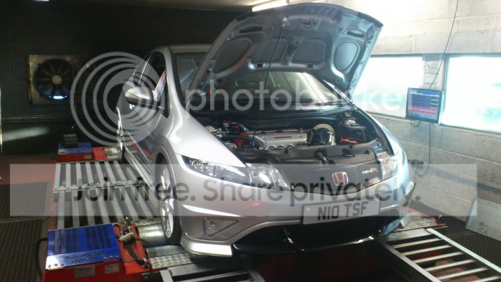

3 cars later my second Honda – a silver FN2 Type R in 2013. This was not staying standard. Tein springs, fast road setup, GP kit, exhaust, intake, manifold and remap! Made 212 bhp with sports cat and 95 ron fuel… at Eurospec’s dyno which is harsh / realistic. 160 lb/ft was good for the K20 too.
