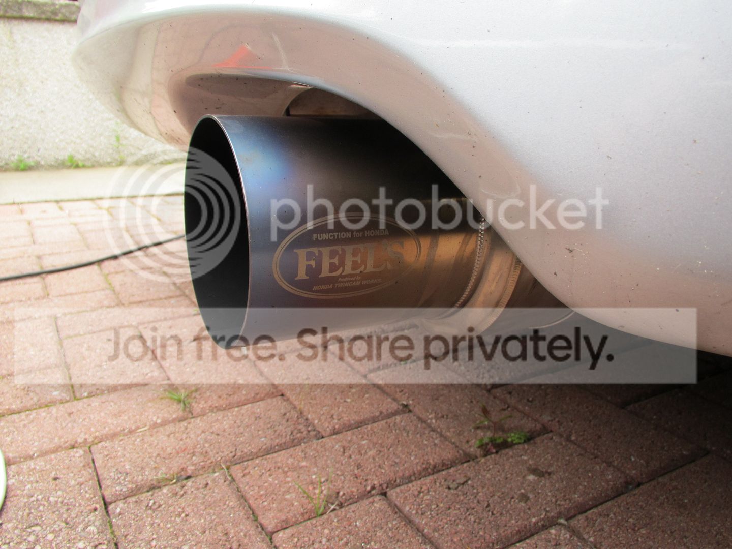

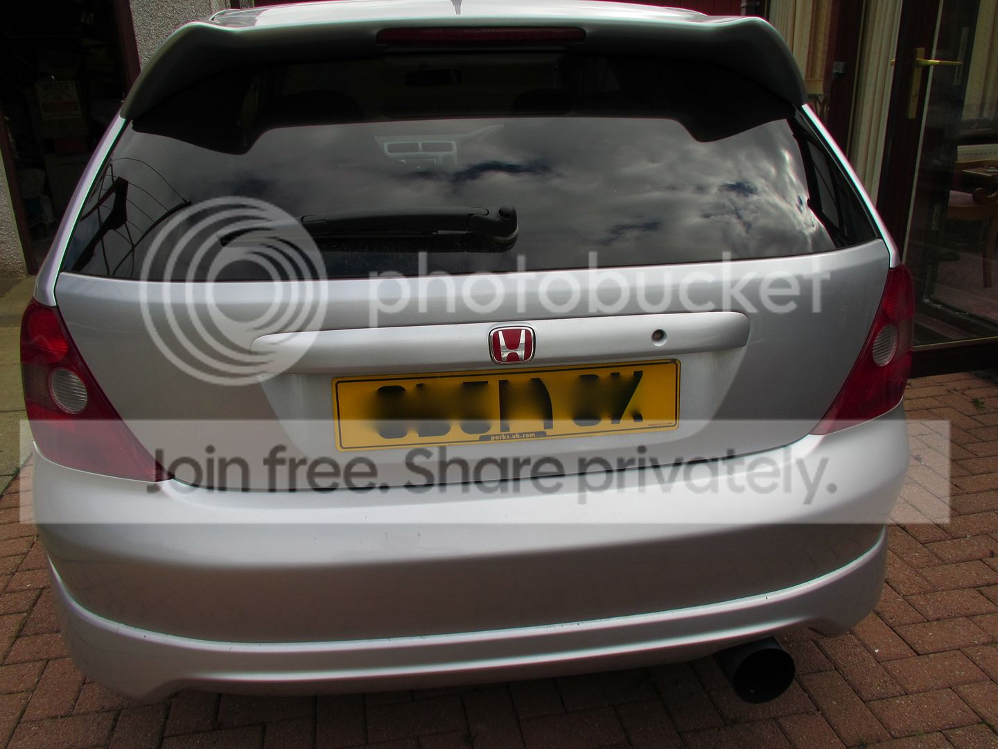

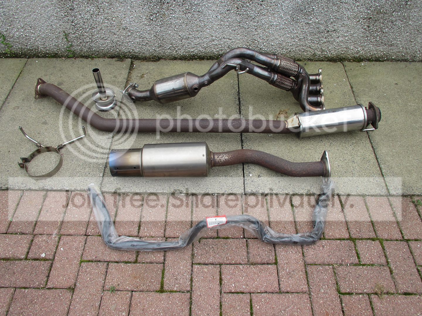

Had a Toda full setup before (never got round to fitting it) so promptly went on the hunt for one. Unfortunately for Rascal69 who had his up for sale and i was away to buy it, Alex-B put his full FEEL's setup for sale and decided to go for that instead. A few PM's back and forth and the deal was done so this duly arrived complete with JDM front ARB....

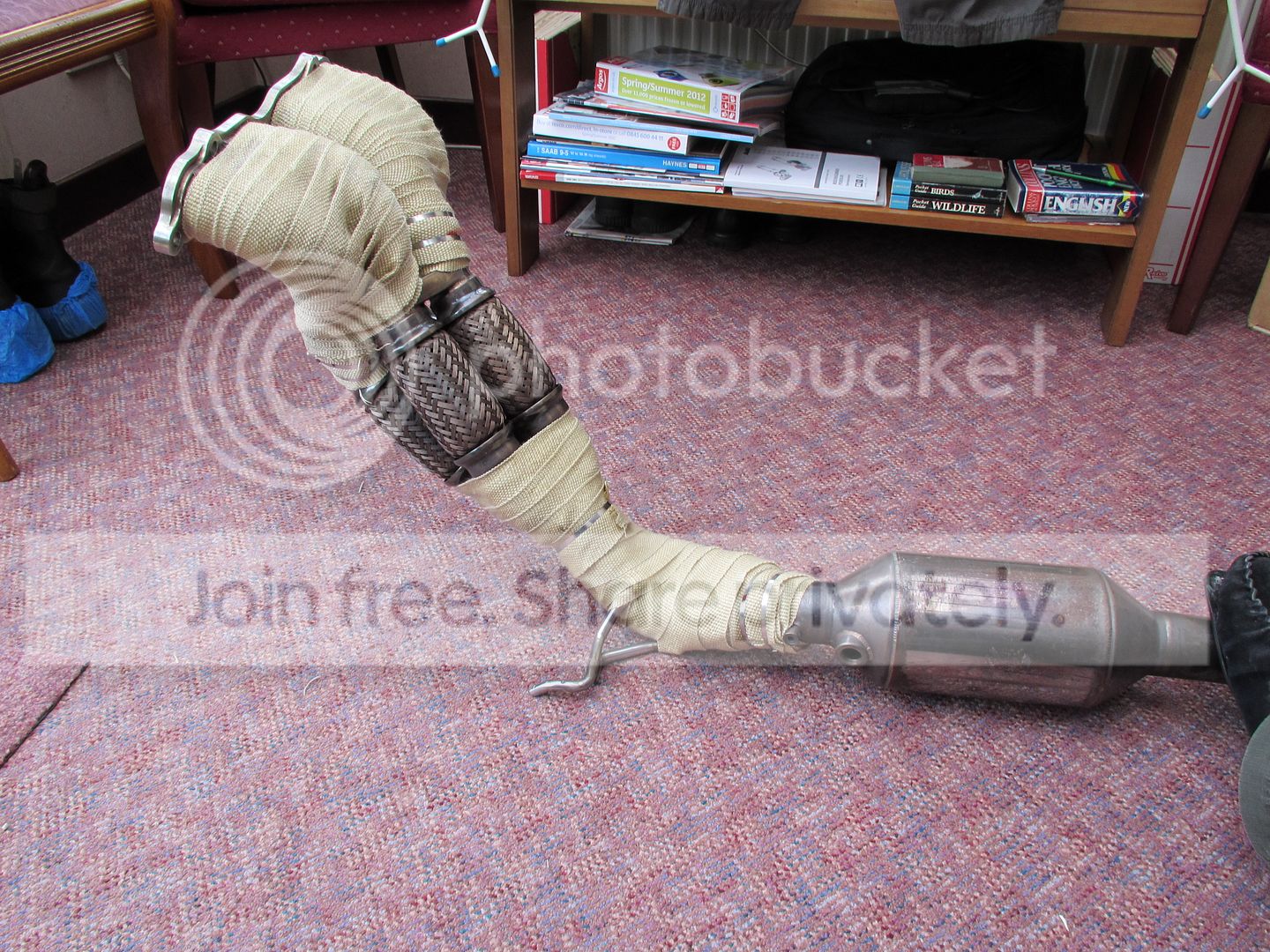

With the std exhaust/mani having done 70k i thought it best to send it back up to the garage and let them have 'fun' swapping it over. Glad i did as the front subframe had to be lowered to get the manifold on and they snapped a stud whilst at it. Also decided to wrap the manifold before it went on.
(Before sealant. CAT punched.)

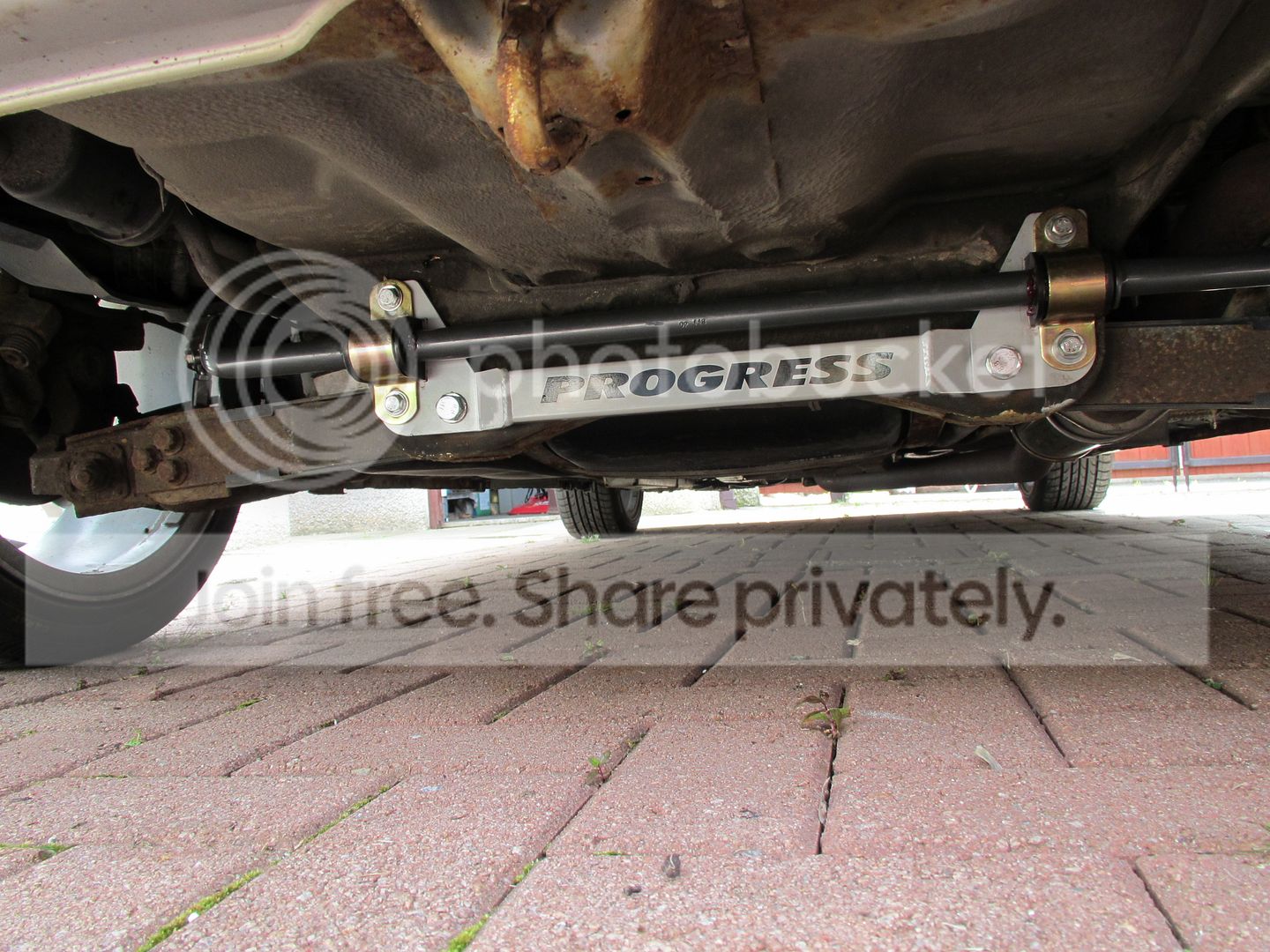

Went and ordered a 'few' parts from Stevie at Eightspeed before it went into the garage as i knew the droplinks would need to be replaced. So up to the garage went the exhaust/manifold/Cometic exh gasket/JDM front ARB/Superpro front ARB bushes/Bilstein front drop links/Progress 24mm rear ARB/ES engine mount inserts/Powerflex gearbox mount.

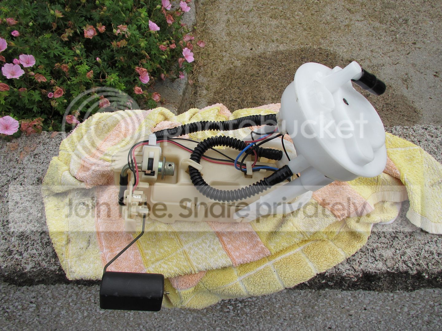

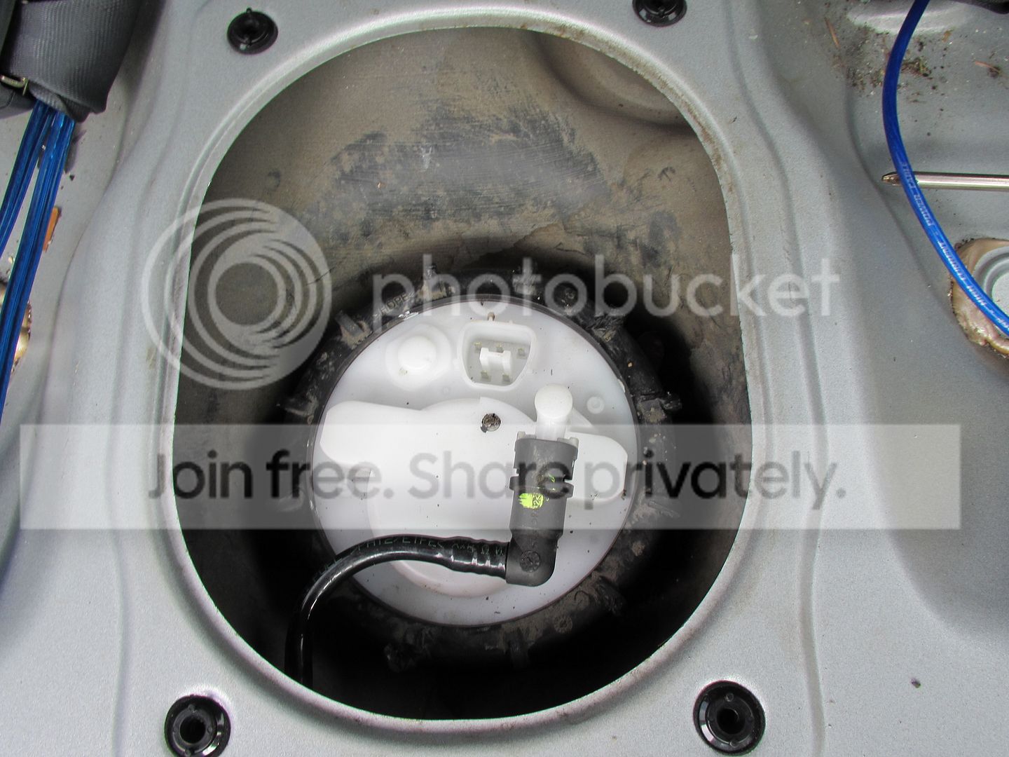

Having hit 70k the car was due a service anyway so instead of forking out for the dealership to do it just so i can get a stamp i went and did it myself. With the oil/filter already done next was the spark plugs so on went a set of these:

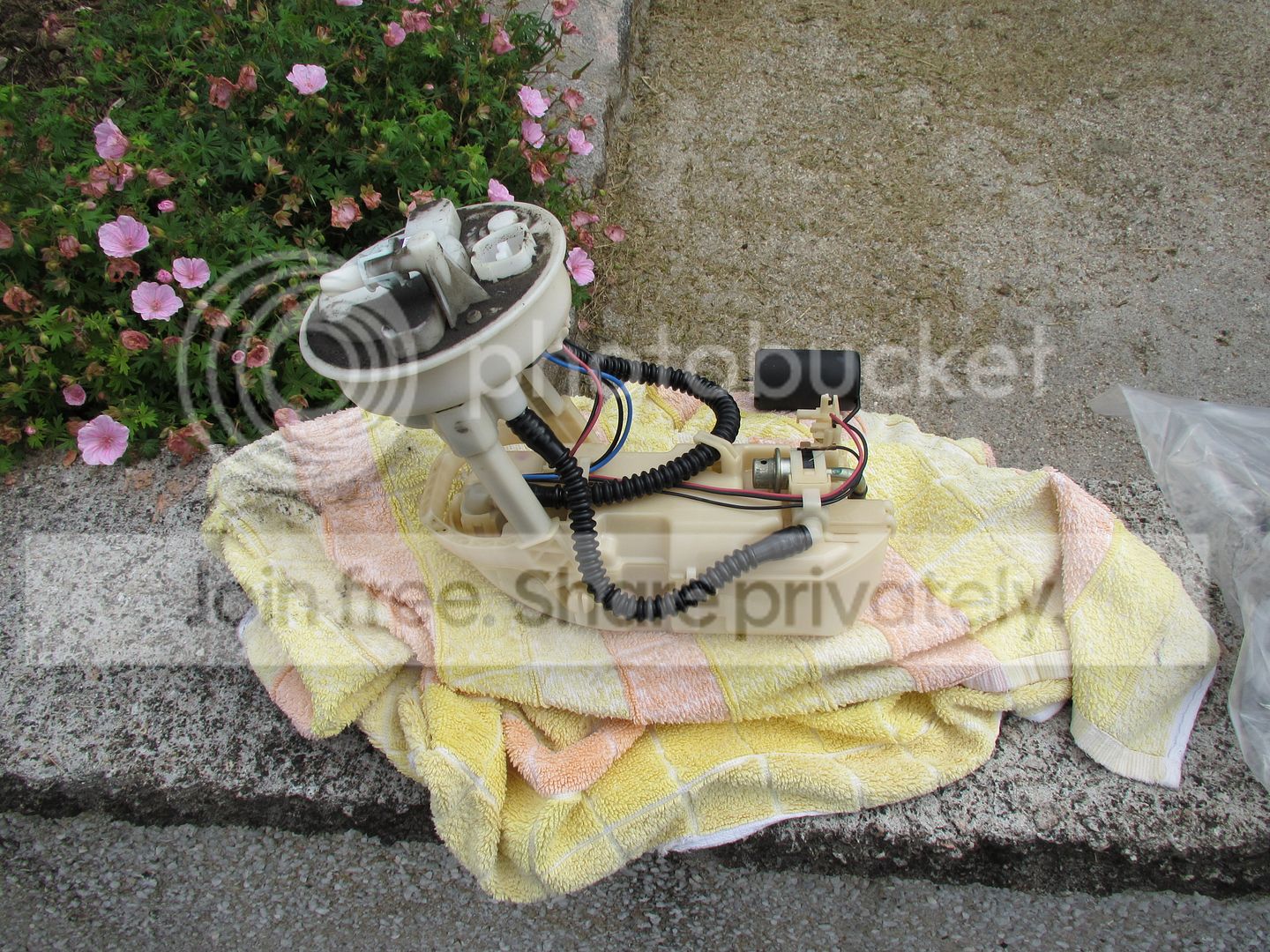

Next was the fuel filter. Heard it was a PITA to do but it's part of the full service so cracked on with it. Turned out to be an easy enough job. Just used a 6 inch extansion and hammer to take the seal off then swapped over the filter. Top tip....remember to put the rubber o-rings in. Ended up fitting it and started tidying up when i noticed two new o-rings still in the bag and only one old o-ring sitting beside them. Back out, o-ring fitted and back in.
Old:
New:
Fitted:

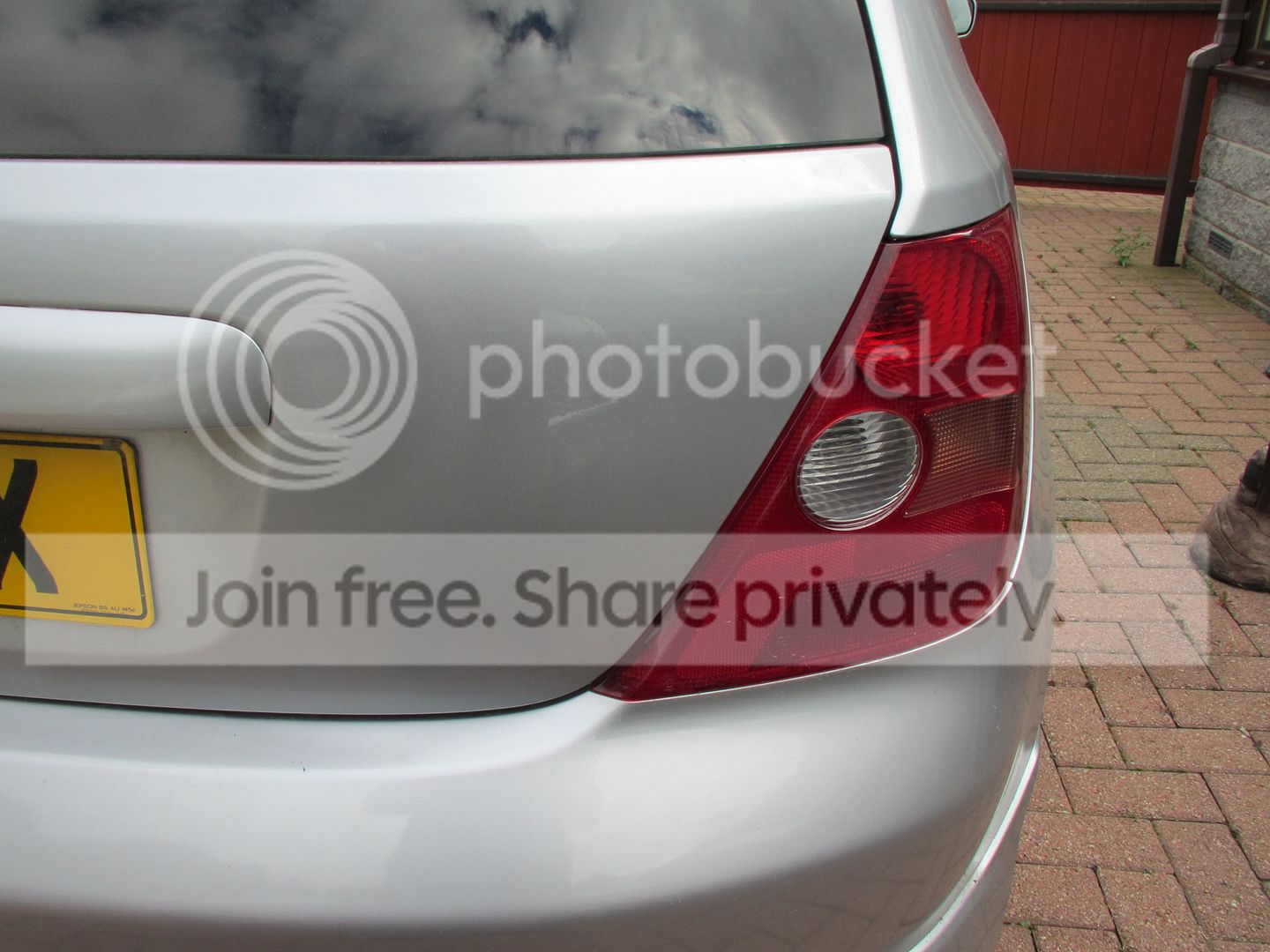

Next job on the list was to sort out a leak i've had on my back window for ages. Took the spoiler off and found out the guy who fitted the Premier rear window had trapped the brake light cable between the spoiler seal and the glass. :bumsmack: Soon sorted that out and used sealant on every hole so there's no chance of water ingress in the future!

Subframe doesn't need to be dropped for the mani especially if it's on a ramp, just need to remove the ARB for future reference [smilie=karls_thumb.gif]

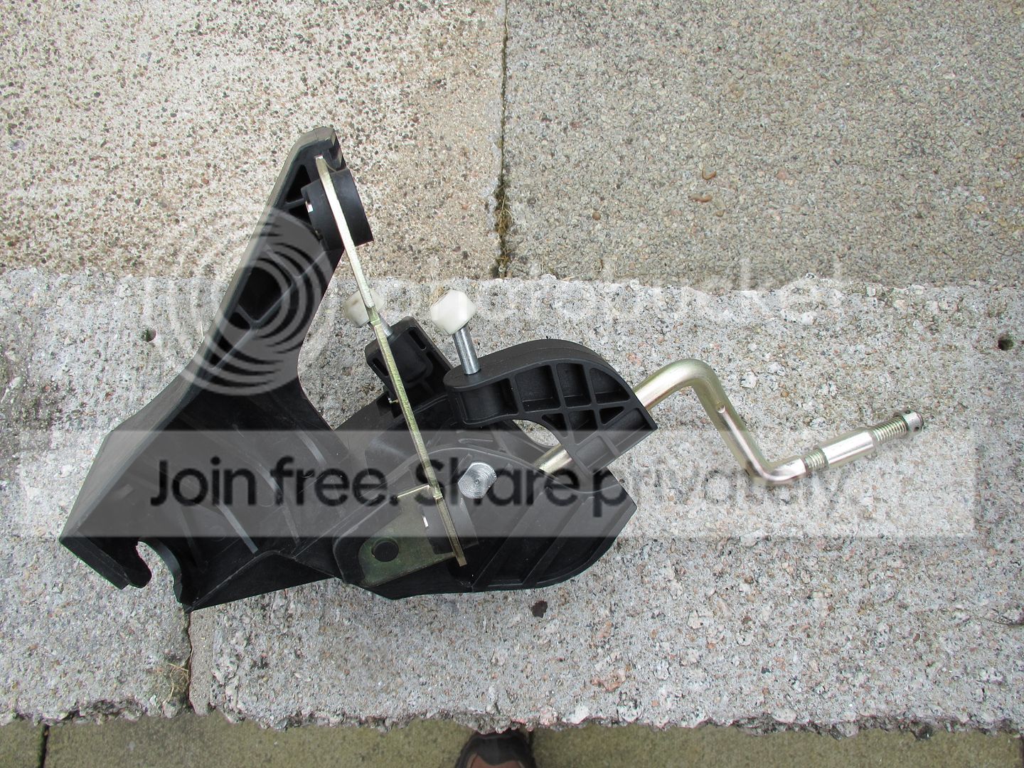

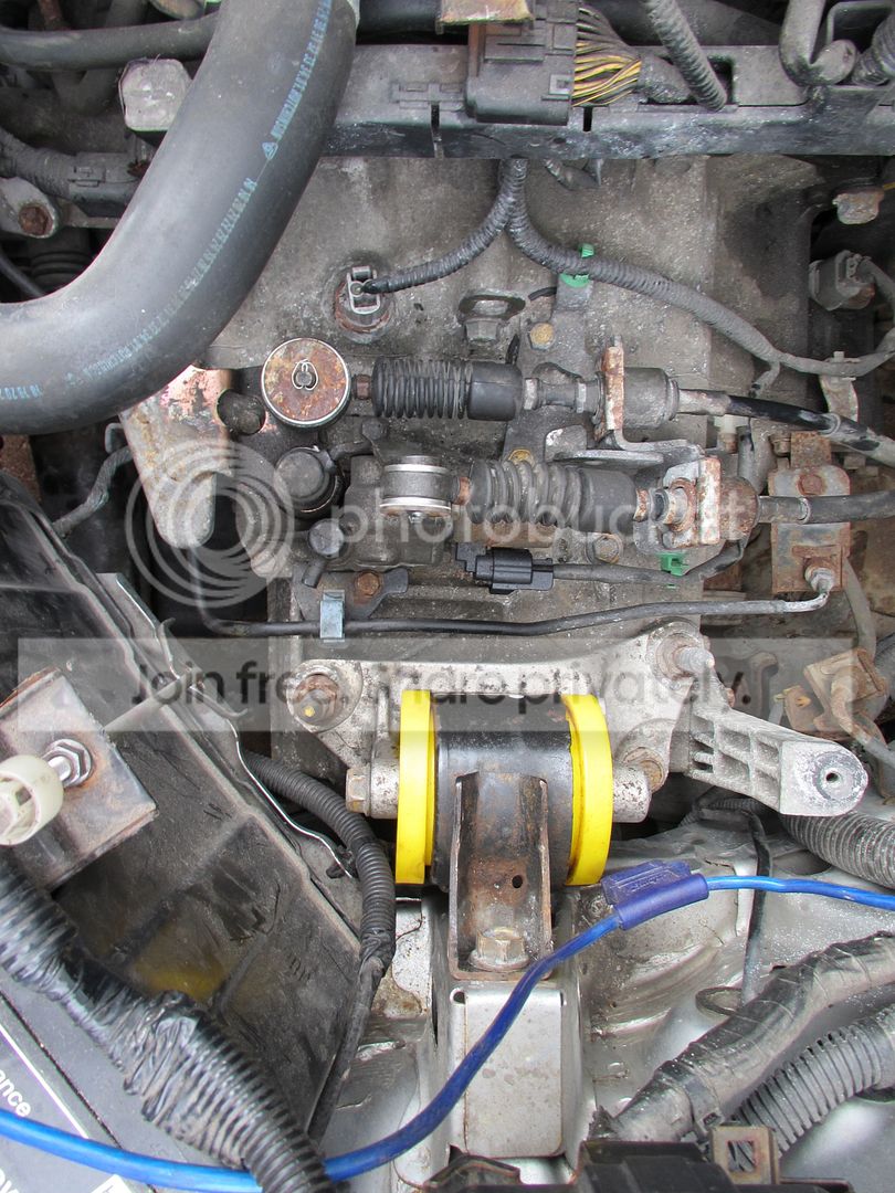

I'd had a Nuspeed short shifter on before and was pretty pleased with the difference it made to the throw of the stick. This time round i decided to go one better so got this from a forum member:
...followed by a set of solid bushes from Tegiwa. Bit of an awkward job getting the cables out of the std unit but 20 minutes later and it was in. Massive difference and highly recommended as the std setup is far too sloppy. Also swapped out the bushes in the front which pushed out no bother with a bit of WD40 soak time before hand :thumbup: :
Note: the box poly bush isn't sitting flush but that'll get sorted in due course.

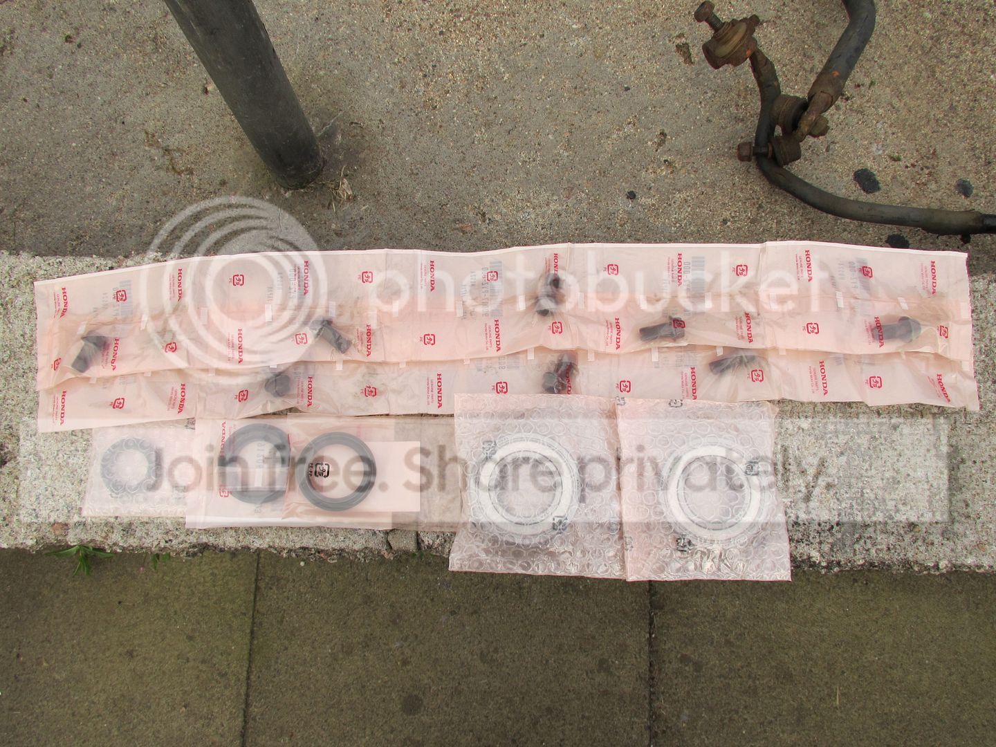

After all that was done it was time to head into town to the dealer and pick up a few oem parts that'll be needed shortly shortly. Sure some of you will have seen these before at some point... :wink: :

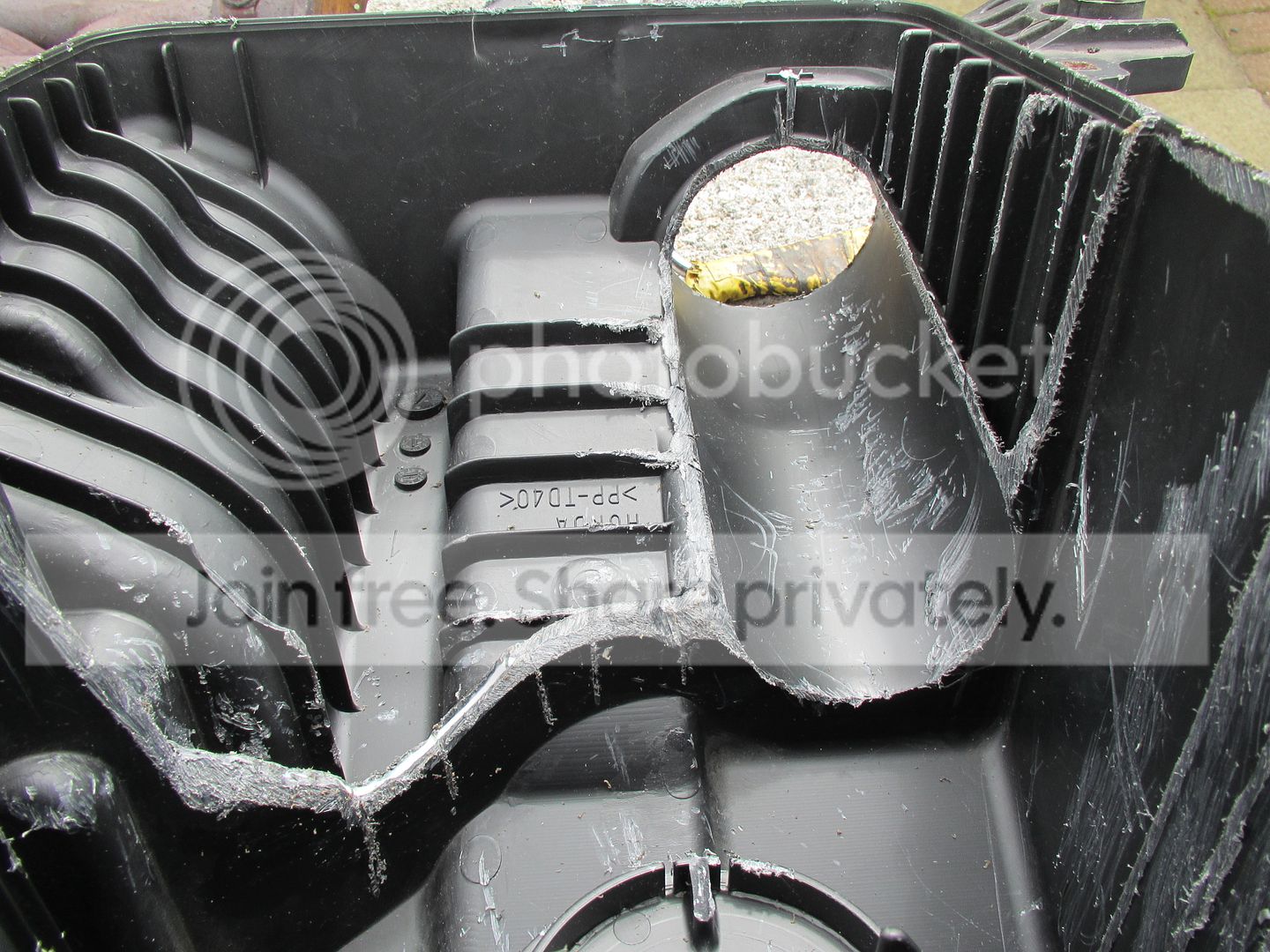

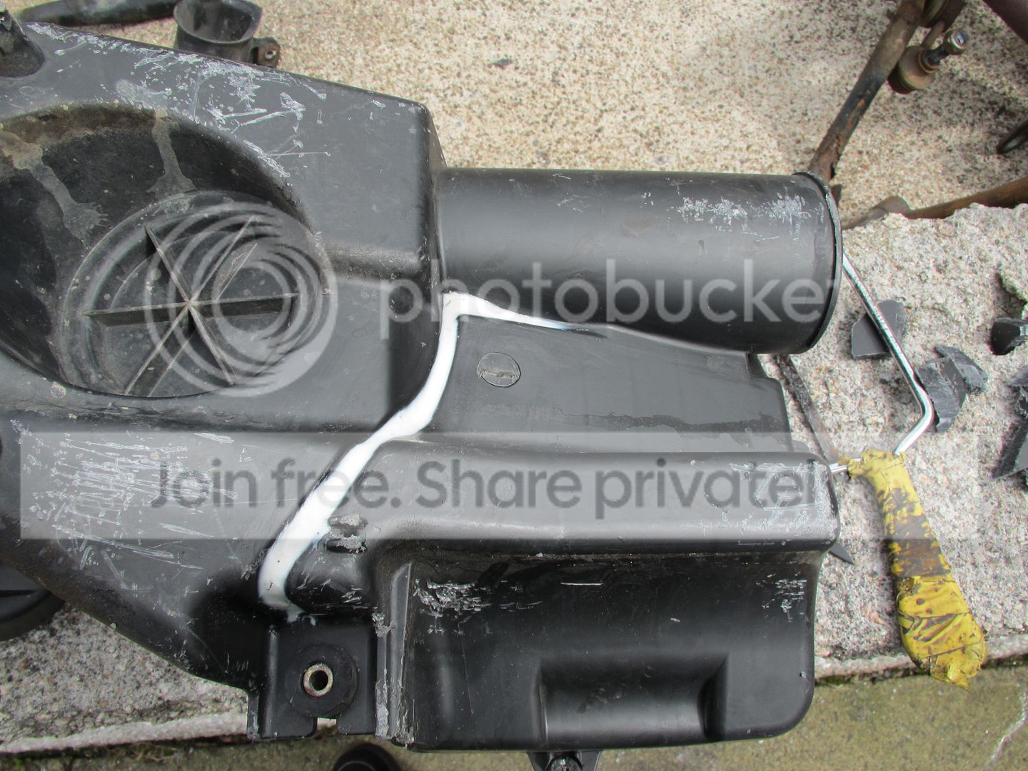

Yesterday i was expecting a GM to arrive but the postie's being a little slow with it so needed to find something to do. Also needed to get the car back running for last night so the airbox had to go back in. Before re-fitting decided to do this:
Can't tell if it's made any difference at all as the car's running in limp mode for now till somebody decides to sell me a K-Pro! :sleeping:

#3413132
Not another feels exhaust, these are becoming so common :lol:
By Alex-B
#3413155
Stevo M81 wrote:Not another feels exhaust, these are becoming so common :lol:
Was mine, still rare [smilie=karls_thumb.gif]
