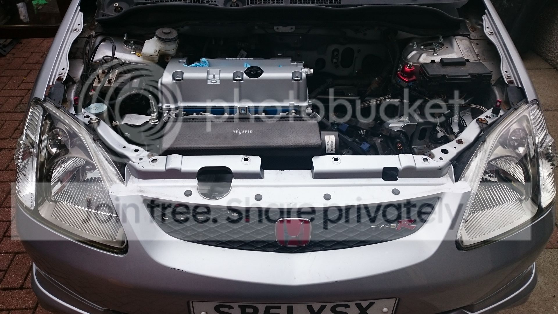

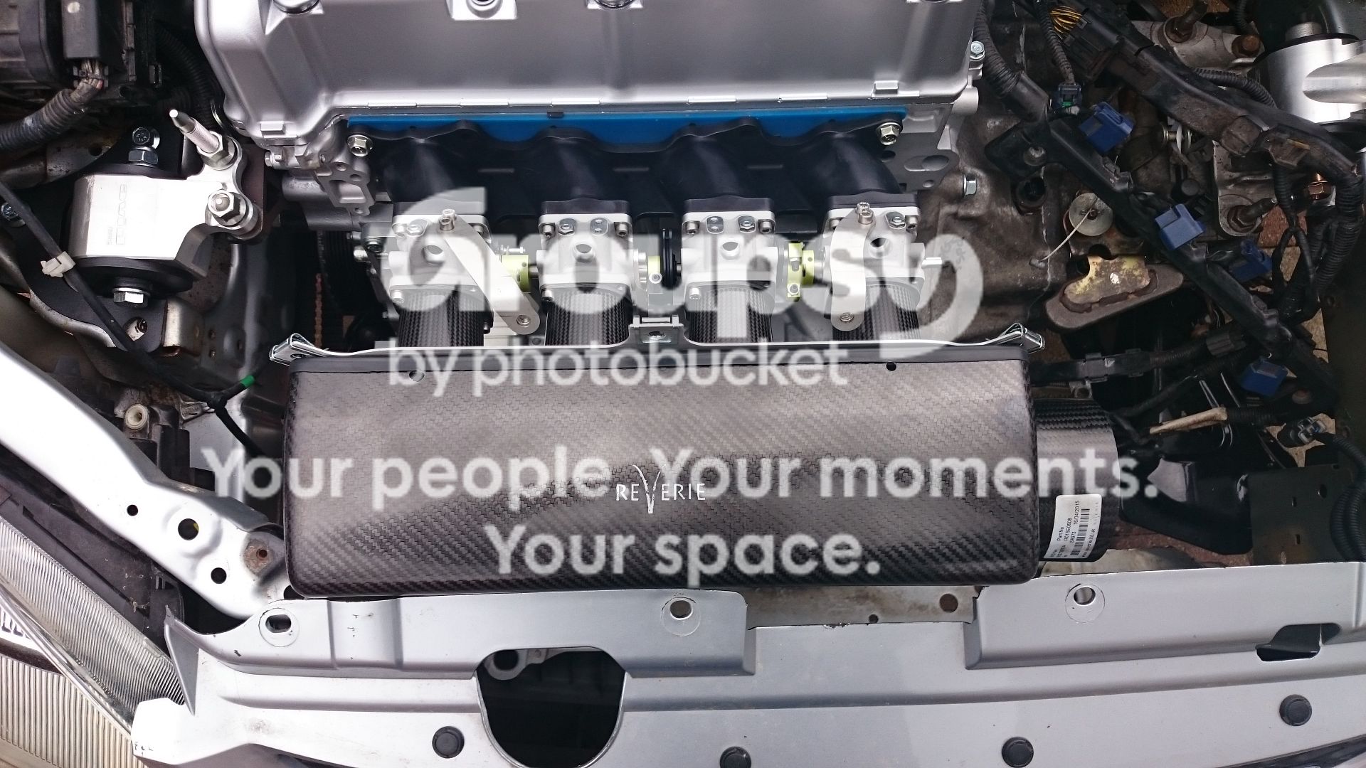

Had to head out the road to pick something up so decided to trial fit the Titan's…

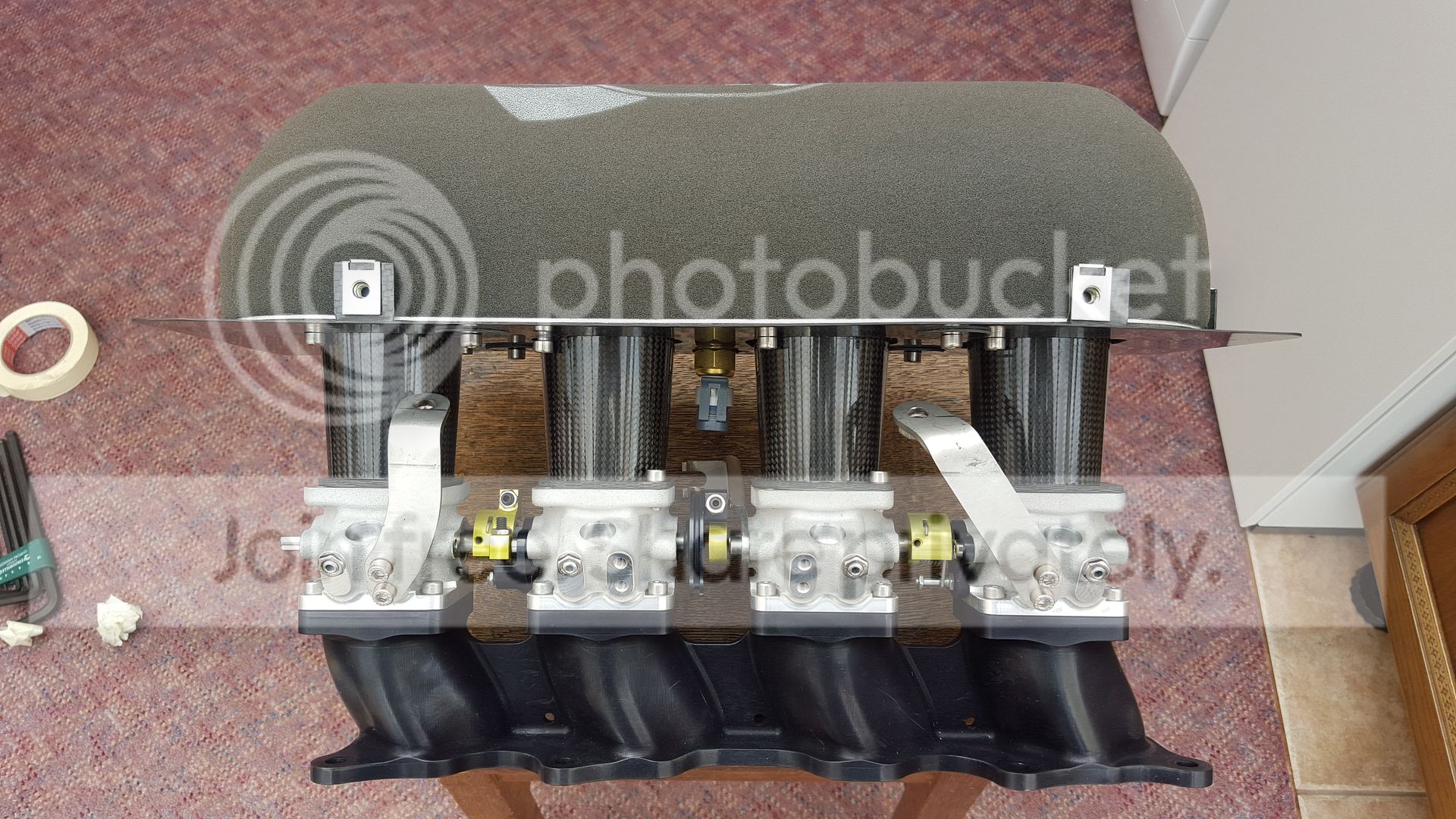

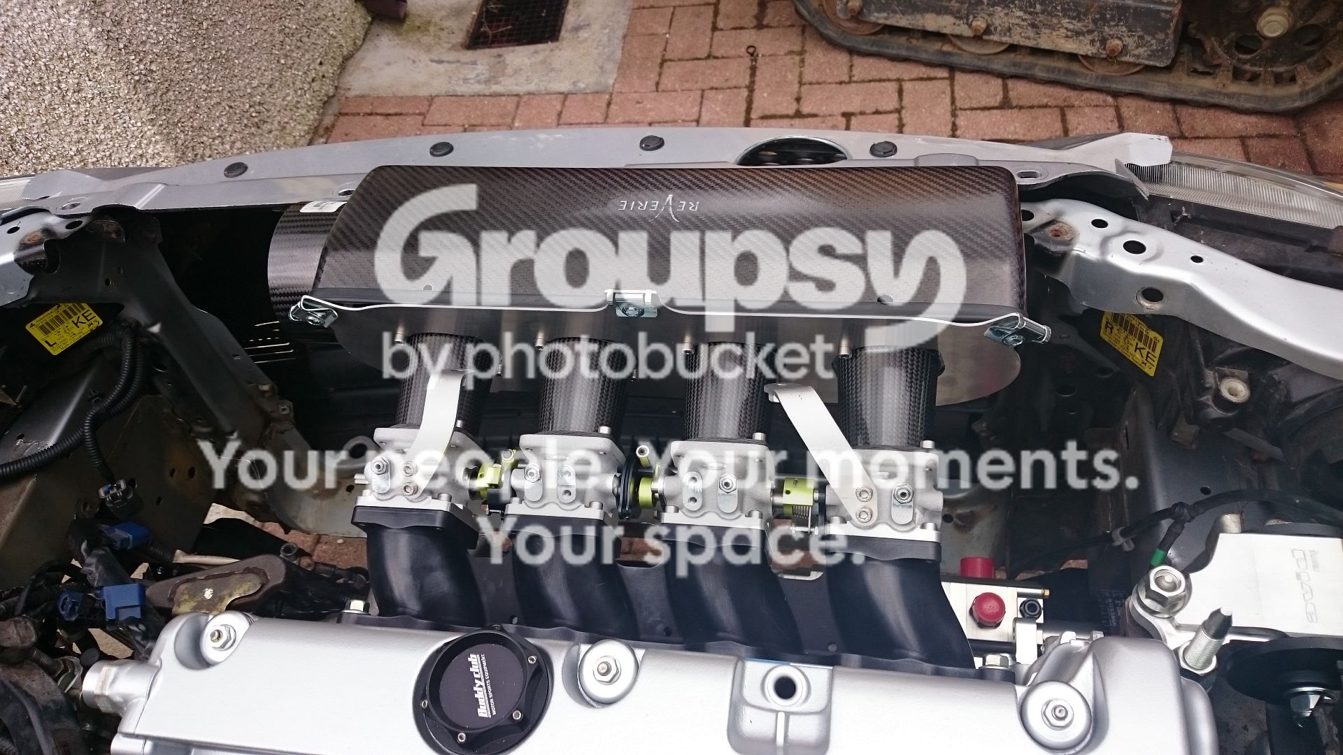

Clearance wise you couldn't get closer if you tried. Bonnet clearance is a couple of mill so i'll put a strip of foam on the underside of the bonnet. You couldn't run the air box with a stock bonnet, carbon is fine if it's single skinned, if using the likes of Seibon you'd need to trim part of the skeleton.
The box is sitting as low and to the drivers side as reasonably practical, backplate will be Reverie flat carbon, not the alu one Titan supply. No way of running front valance and bumper needs a little shave at the top. Ended up being quite lucky due to the offset design of the manifold, air box wouldn't fit otherwise as the drivers side edge is only a couple of mill away from the headlight bracket.
If anyone's thinking about running these and using an air box, i spent ages looking at all of the options and the 'Interlagos' from Reverie is really the best option due to length and height.
Ducting will come from a 100mm snorkel on the bumper, just to the left of the numberplate if looking from behind. Radiator will be full length but around 11" tall. That takes it up to the height of the tabs you can see in the pic above (welded nut on it) which will allow room for the ducting to pass to the front. If just running a dome filter stock rad is totally fine.
Laminova will fix onto a back bar welded onto the rad just below the air box.

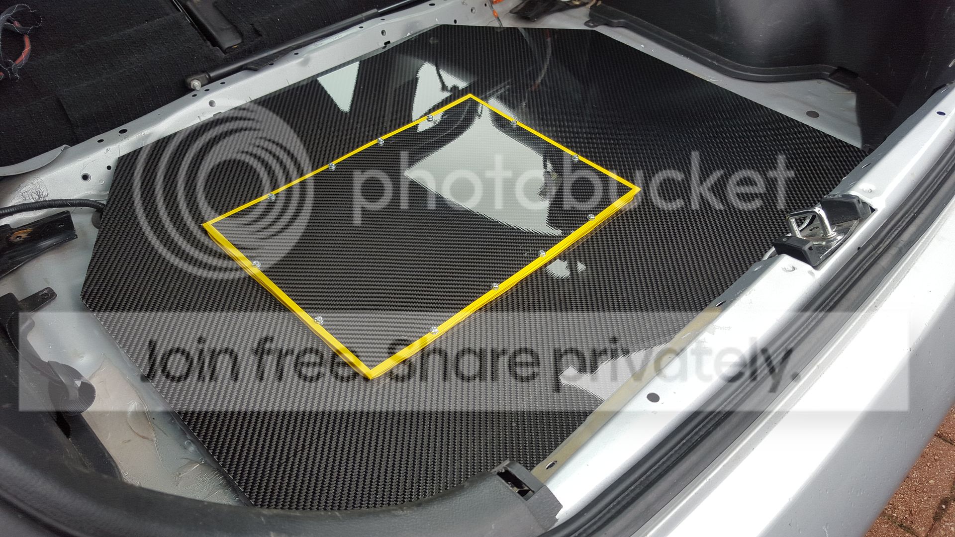

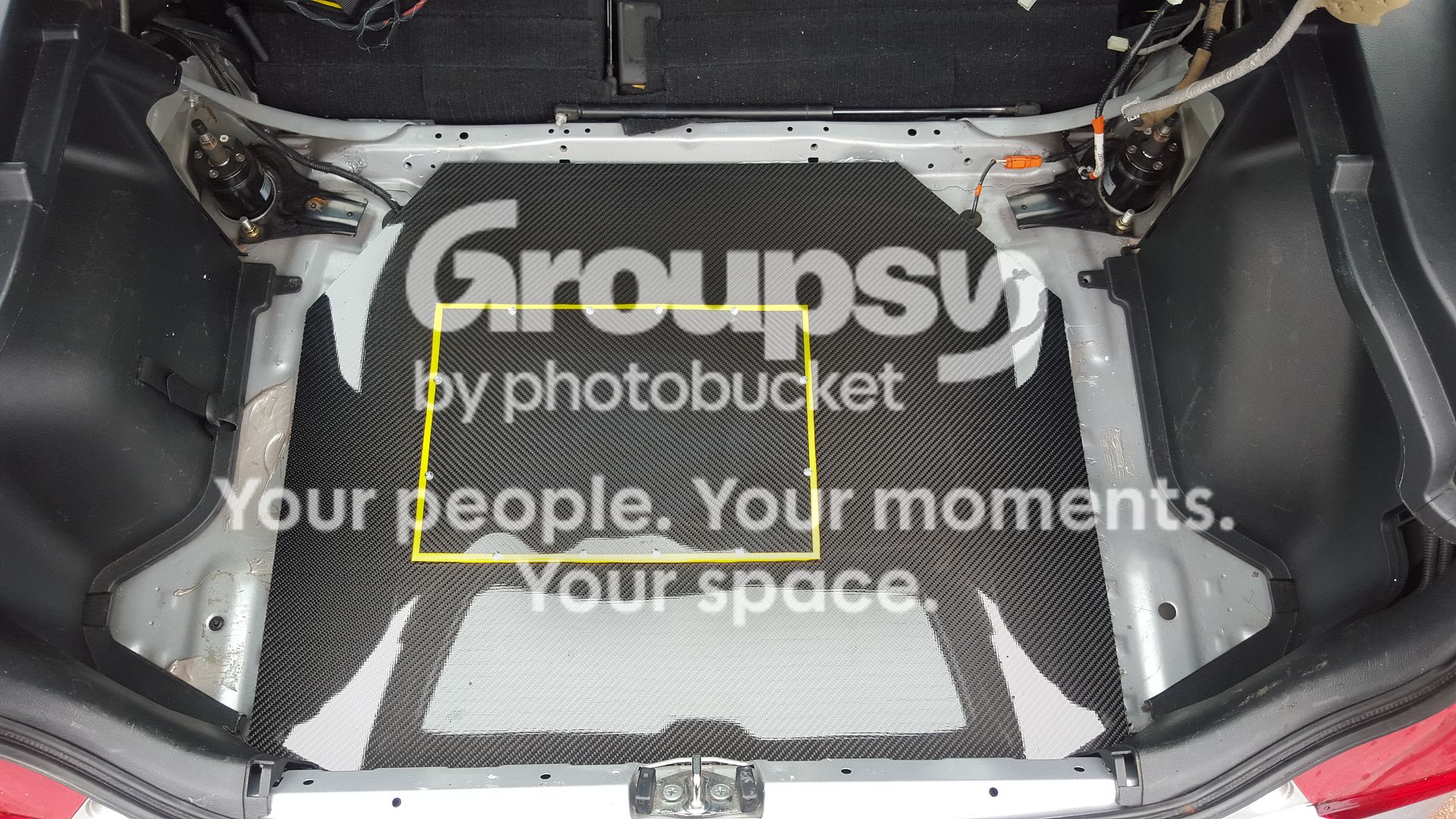

Be back out the road this week to get the spare wheel well lid finished and get a mounting plate fabricated for the oil tank & breather. Should also be picking up the header to send away for coating, been away getting the wideband bungs welded on.

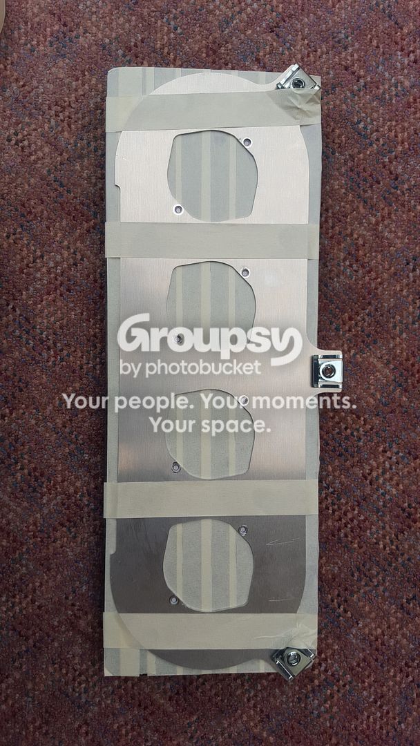

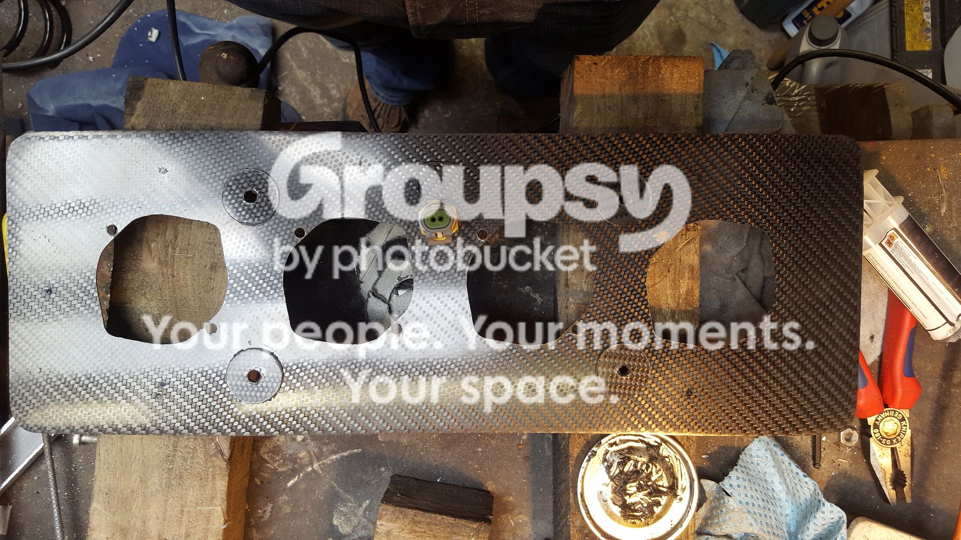

Decided to sort the back plate for the air box today. As usual, nothing goes according to plan…
First thing was to use the existing back plate as a template. Holes for the trumpets are quite a specific shape so just masked off the carbon, fixed the alu and marked it out. Took 20min with a hole saw then the dremmel to cut them out. Easy job.
Marking the holes for the ITG was a little more guess work as was pretty much marking them blind. 2 were slightly off and needed filed out. Used the round cut outs from the hole saw to cover them up, bonded on. Also cut a hole for the IAT and bonded on the alu boss that came with it.
Looked like everything was spot on but when mounted and put the bonnet on it wouldn't shut. When i had the filter and box sitting on the trumpets they weren't central to the trumpets. Cutting out the back plate central has raised the filter and box by about 10mm i reckon. I'll need to get another backplate ordered up and re-do it all again but offset.
Had an hour to kill and started thinking about making my own box direct to the grill. Out with the cardboard again and very rough mock up done. In two minds now which route to go down, just waiting to hear back from a guru on his thoughts between the two. If anyones clued up feel free to chime in!

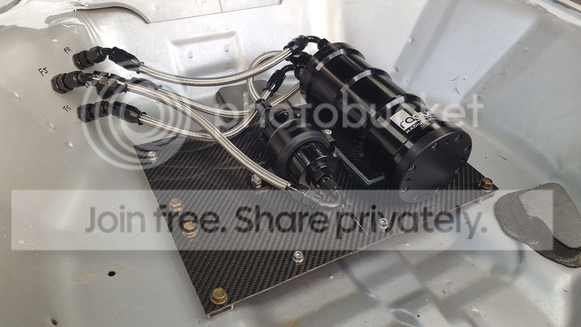

Pissing down rain today so left the front end and finished the fuel setup. Just need to put a hole through the frame for the pump wiring and seal the main plate on. Luckily managed to use the fittings i already had, after ordering all the oil/coolant fittings i think i'd be sick spending another penny on them! :lol:

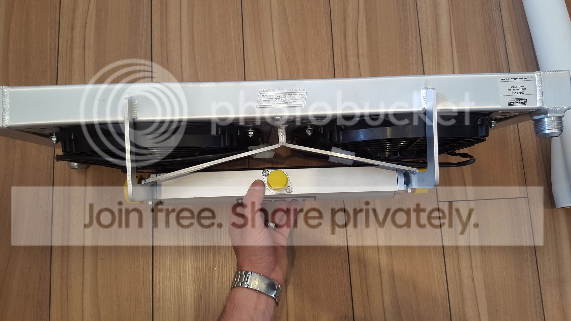

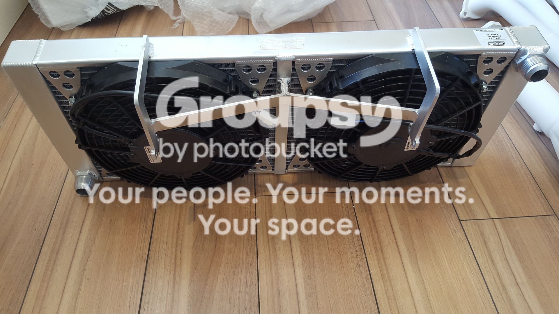

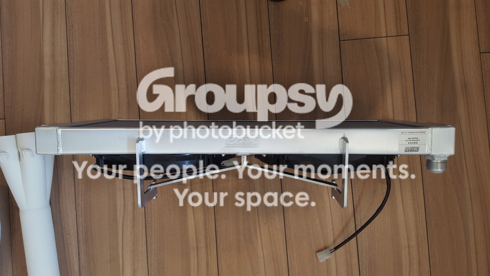

Other delivery i'm absolute stoked with. Due to the air box for the ITB's stock rad won't fit. Hillclimbing doesn't require masses of cooling and the Fluidyne half rad i've got won't fit either with the aribox. Got in touch with Pro-Alloy, took a load of measurements, designed the rad and they built it. 300mm tall, full length, 40mm single row, 2x 10" SPAL fans. Think the core is what the use for tuned VXR's so ample for my build!
Mounting the Laminova seems to be a head scratcher for some and decided to have a bracket made on the rad for it to hang off the back. Coolant will come out of the head into the cooler, into the rad drivers side at the top then out the bottom passenger side feeding the EWP and into the block. Routed it this way as the coolant temp will be toasty after going through the head and heat up the oil passing through the cooler. I'll just need to keep an eye on temps and adjust the EWP/fan controller to keep things peachy.
