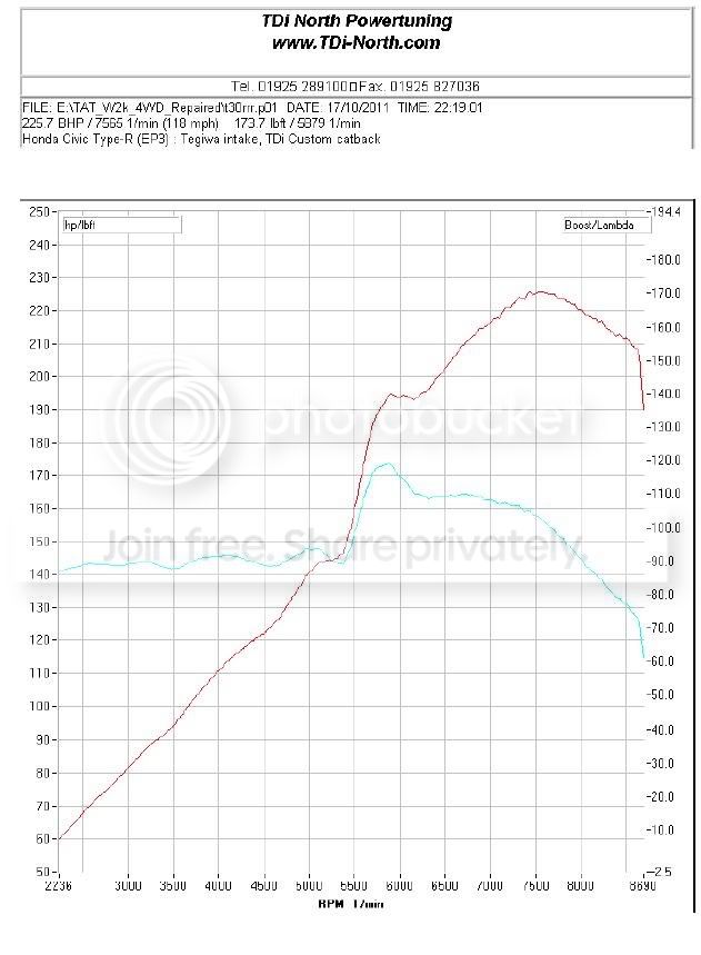

K100 Mapped by Russ at Performance HQ (217bhp and 152lbft at the wheels)

Looks like the car made some good power considering the mods its got and I can imagine how much different the handling is, I remember when I had my coilovers fitted on my old CTR, completely transformed the car.
By D4Z3D
#3122746
Yeah it seems like the 2.5" b pipe really is the key, seems to be a pretty restrictive part of the exhaust system. I had expected that the cat would be the main bottle neck - i only replaced the mid section because the original was nearly 9 years old and on its way out. Pretty surprised it had such a positive effect tbh. The handling is great, feels like a new car - only with less body roll :-D

Just read someone elses thread whos had a k100 done at tdi north with a race header, aem v2 and it had slightly more bhp and less torque hows that possible when this cars got a standard mani and cat.
By D4Z3D
#3339236
I think if it had an exhaust manifold and decat it would be making more power higher up the rev range - while sacrificing a little bit of mid range torque. At the moment i don't really rev it much past 7500 as the power and torque drops off. It's pretty easy to drive fast now but it struggles a bit in the wet with all that low down grunt. LSD should sort this out.
By keithlou
#3339244
D4Z3D wrote:I think if it had an exhaust manifold and decat it would be making more power higher up the rev range - while sacrificing a little bit of mid range torque. At the moment i don't really rev it much past 7500 as the power and torque drops off. It's pretty easy to drive fast now but it struggles a bit in the wet with all that low down grunt. LSD should sort this out.
so day-to-day driving a better b-pipe will do? cos the print out does shows it has massive torque from these basic mods, and lets face it horsepower isn't that important
By D4Z3D
#3339264
It just depends what you want dude, if you go for a nice intake manifold, racing exhaust manifold , decat and catback you will probably see 240 - 250 bhp and around 160 - 170 lb ft or torque. I have toyed with the idea of going with that set up myself - the problem is the new legislation governing cat's. If you get stopped by a roadside test then u get fined - and you have to get a cat put on it. The map might not work very well either if its mapped without a cat - then the law force you to put one on it.
Basically i pussied out and just replaced the really restrictive mid section of the exhaust with a 2.5in unsilenced section. By keeping the cat, std mani and backbox its not much louder than stock unless you are in Vtec - where all you can hear is induction noise from the tegiwa M.
It is much quicker than stock in any gear at most revs, but you can feel it tailing off beyond 7700. I find if i shift around 7500 - 7700 i land right in the big torque zone and make lots of progress [smilie=karls_thumb.gif]. I only go up higher if i need to hang on to an overtake.
If you want your car to make useful power all the way up to the 8600 rpm limiter then you would probably be better going with the more highly modified set up - if you want to take the risk with the cat :wink:
