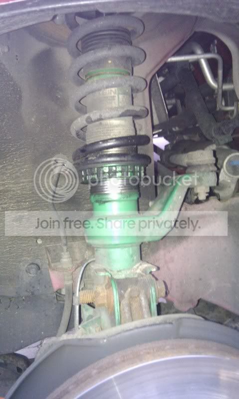

I've had the car a few months now and have done one or two bits to it, but nothing major yet. Still no sign of a supercharger....
I had a problem where both ballasts for the HIDs blew, so I switched them back to standard bulbs (might help it when MOT comes around as well!). I also switched the front side lights over to clear as I had some led bulbs free and the amber ones apparently don't pass MOTs either!
Done a quick oil and filter change (how-to guide on here was REALLY helpful!)
Cleaned and re-oiled the air filter from the Gruppe M
I've got even more addicted to V-tec (and got stopped a few weeks ago for "driving round a roundabout very aggressively" :oops: )
I fitted some hybrid racing bushes to the gearshift linkage in the engine bay. - Slightly improved the feel of the gear change, but think I might get the bushes that go in the cabin too.
I got a set of vibra-technic engine mounts and got the guys at Japtech in Southampton to fit them as it looked a bit fiddly and I need my car for work 6 days a week at the moment so I didn't want to risk running out of daylight to do the job. This was because the whole engine was making some nasty banging noise if I changed down into second over a certain speed without blipping the throttle. This noise has stopped completely now. It's been replaced by the noise of the slam panel rubbing the RBC every time I come off the throttle and use any engine-braking. Must trim slam panel or reposition so it fits nicely. I think the vibra-tecnic mounts must just hold the engine that fraction higher so there's even less clearance than there was before.. :boxing:
I switched over the front and rear tyres to even out the wear - I'll be getting new tyres all round soon and want to replace all 4 at the same time.

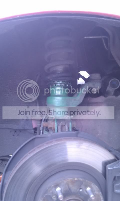

I raised the ride height to the Tein recommended settings on the front and rear - not that far from where Dan had it set to be honest, but it was just too low for the roads round here, and it's made such a difference to the ride. There's this bump on the motorway I go over every day. After I raised up the front I hardly noticed it, and wasn't even sure I'd been over it, but before I did this it felt like the car was going to bounce about a foot in the air!
I did love the slammed look, but it was going to get expensive with the exhaust and my back needing replacing!

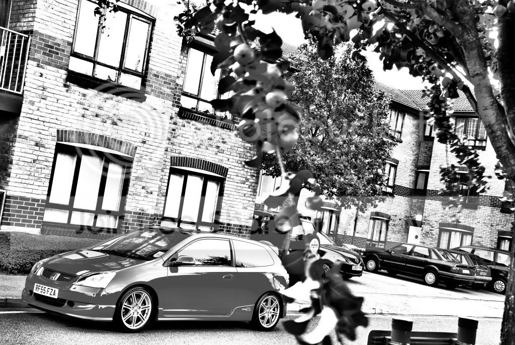

Before:
After:

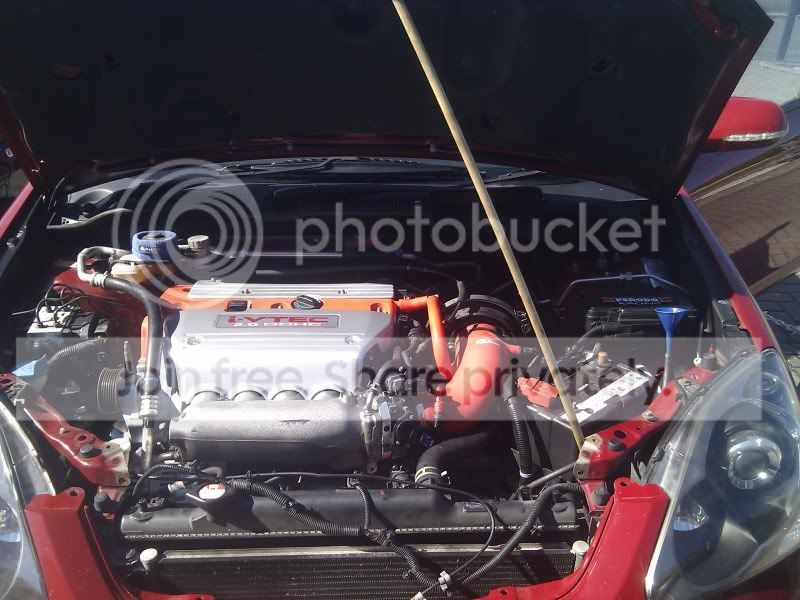

Right, about time for a bit of an update on the car....
As some of you may know I had a bit of an engine problem on the way back from Japfest in May, but it is all sorted now and back to full fitness with a few extras thrown in for good measure lol!
Before Japfest I was just doing general maintenance as it came up and the odd minor mod here and there.

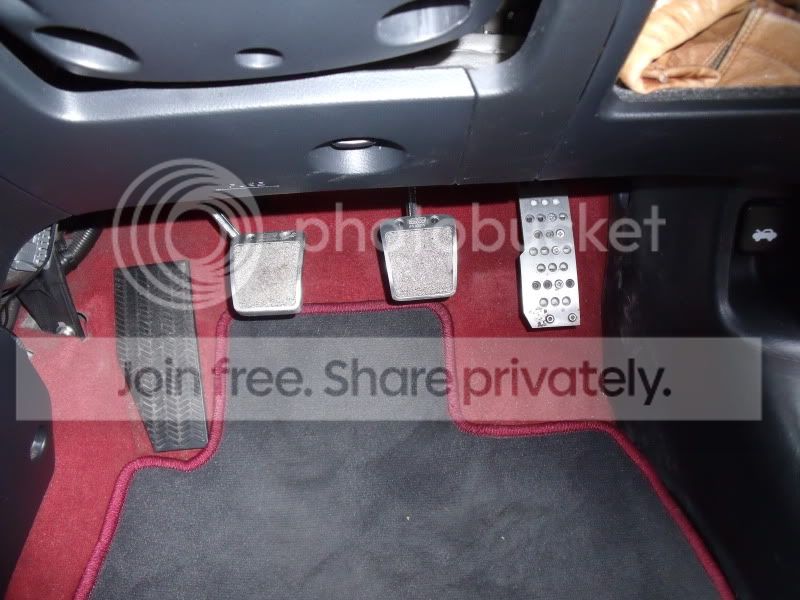

I fitted Mugen-style pedals- I got them off ebay and am certain they are not the real deal, but no-one really gets to see them, and they offer a bit more grip than the standard ones which were needing replacing anyway as the rubber was wearing through in parts. I also got a set of OEM black mats so I can get the JDM ones cleaned up properly, but I've gotten to quite like the black ones:

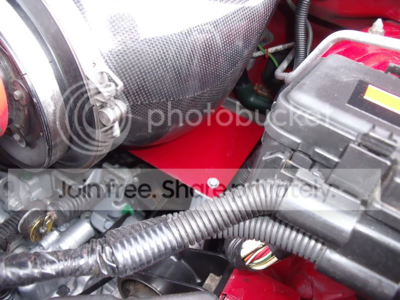

I trimmed the slam panel to stop it rubbing the RBC inlet manifold when reversing.

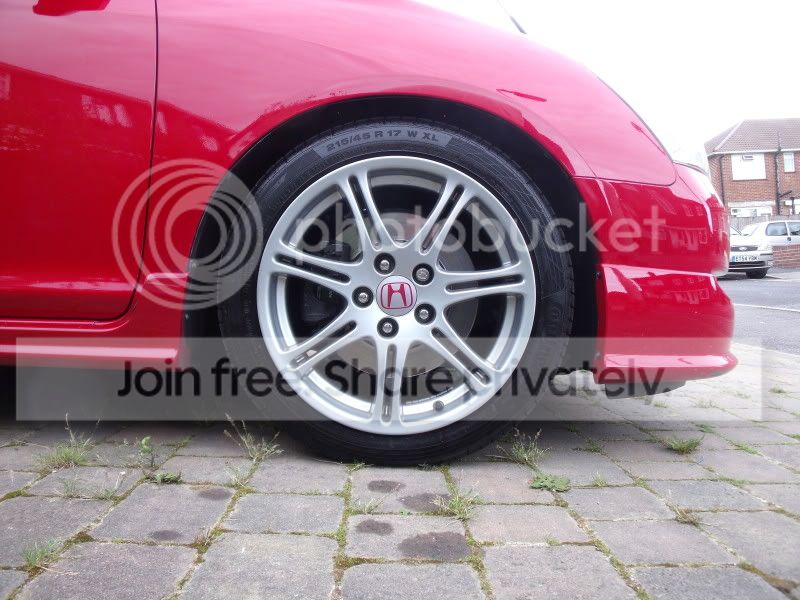

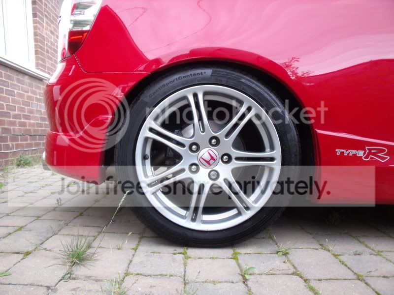

I fitted 4 contisport 5 (215/45 17) tyres to the now slightly cleaner OEM wheels:

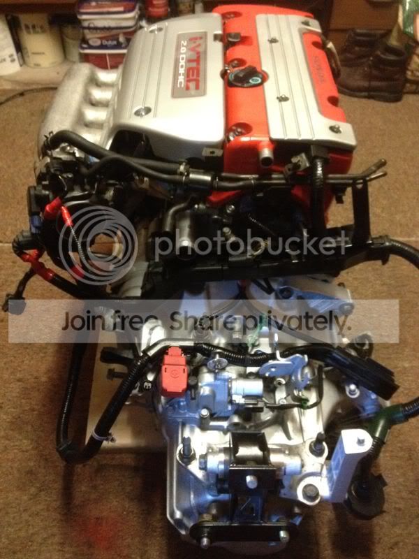

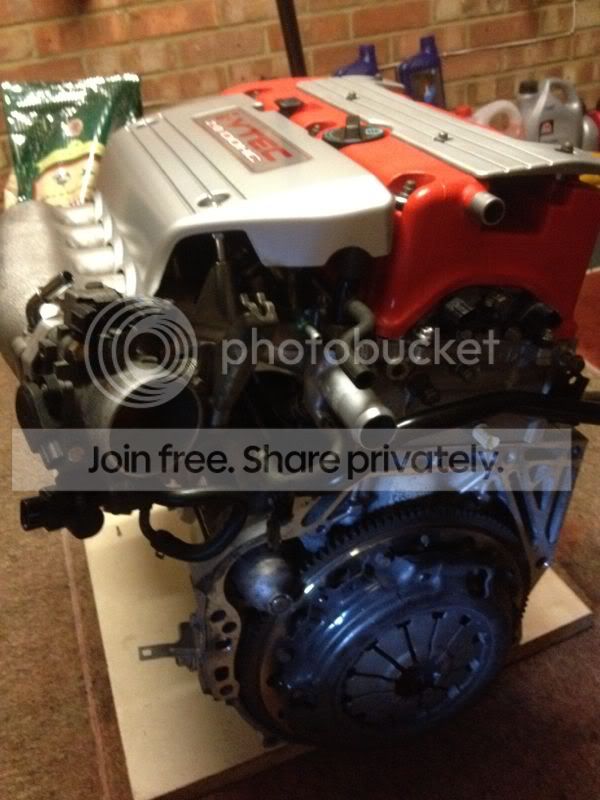

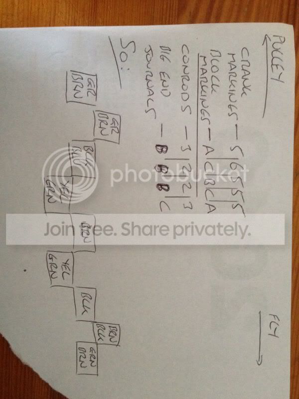

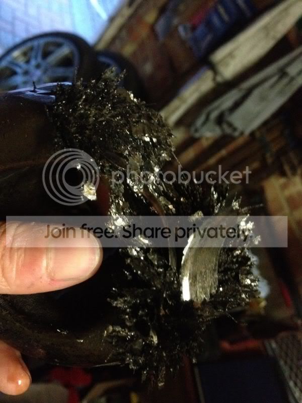

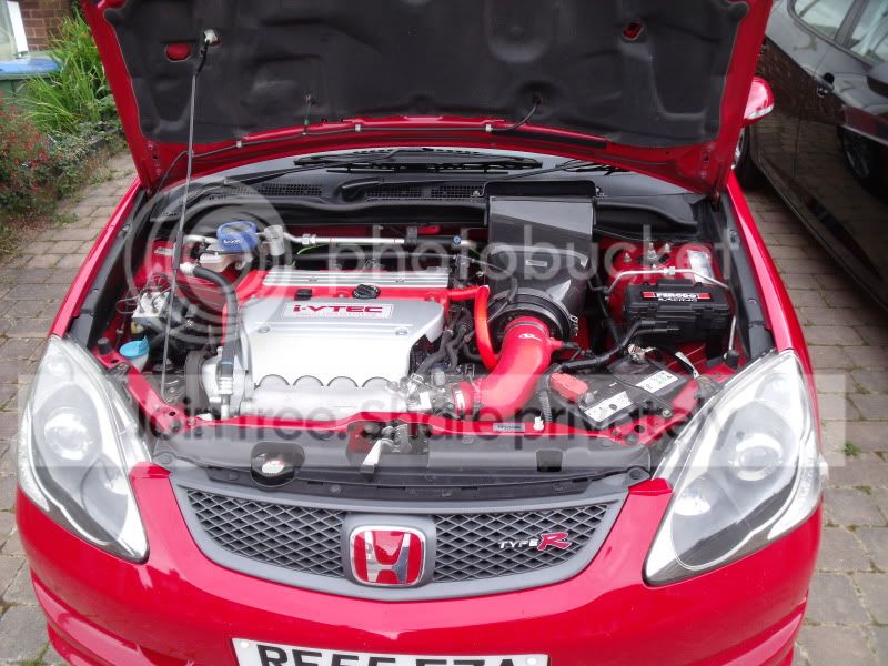

Anyway, after getting the engine out and stripping it down It was clear that one of the conrod big-end bearings had spun, and mullered the crankshaft :bad-words:
A new crankshaft from Honda is silly money (£894) so I managed to get a really good, as new looking one from integrastellar that he'd just taken out of a DC5 along with a Conrod as mine was a bit mullered too.
With the stamps on the crankshaft and the engine case, we worked out what colour bearings were needed
Then double-checked the workings, then got someone else to work it out again, then triple checked it, then made sure it was right.
All new Honda bearings and a new oil pump and oil-pump tensioner were ordered along with a whole load of bolts and gaskets and bits n bobs like hondabond and oil-filters etc. Basically everything that it says needs replacing in the workshop manual, and anything that didn't look 100% was replaced with new parts. This included the piston rings as when we checked the compression it was at the lower end of tolerances. New conrod bolts, new lost motion compensating springs (whatever the flip they are!! :scratch: ), new girdle bolts, new thrust washers. Some bits I ordered from Honda locally, some from Tegiwa, and some from Autofair [soo cheap! :shocked!: ] in the states. We got a local machine shop to fit the piston rings and clean up the head and bottom end as there was a load of mangled bearing everywhere. They also did the lightest skim on the head just to make sure it was perfectly flat and straight.
I also got a new plastic VTec cover that fits the RBC from matt_555 on here as he was selling it as surplus to requirements - I never did like that dirty fuel rail in the engine bay lol!

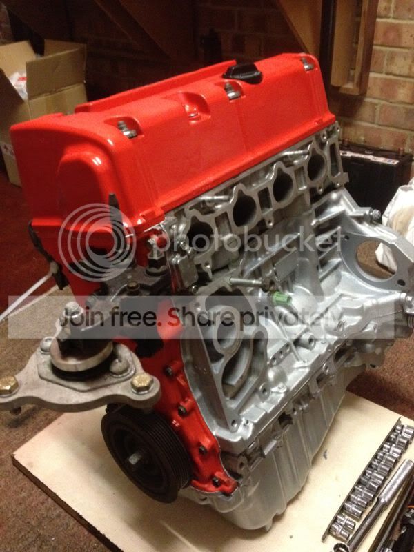

Then came the easy bit, lol! Putting it all back together, and painting it in VHT engine enamel/wrinkle red where needed- I left all this to Stu and stayed out of it.
We changed out the old fuel filter for a fresh new Honda one because we could, and it seemed like a good idea....

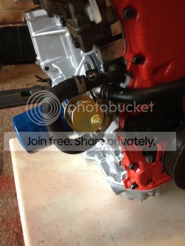

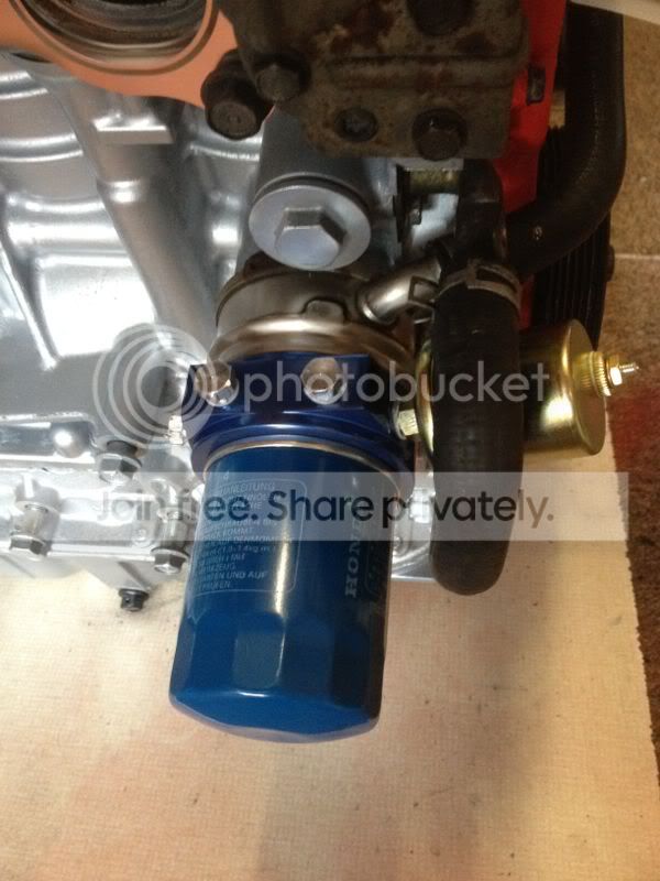

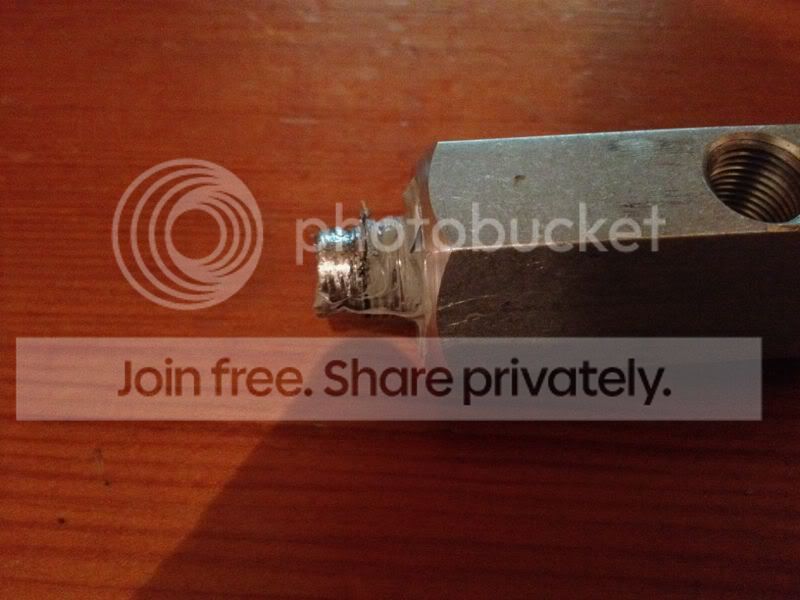

We also thought that now was the time to put a couple of extra safety measures in place to try and reduce the chance of something similar happening in the future. I got the Tegiwa weld-in baffles for the sump and got a local fabrication company where my mate works to weld them in. I got some MFactory magnetic drain plugs for the sump and the gearbox for good measure. I also ordered a Stack oil pressure gauge, and a T-piece from Demon Tweeks. This should enable the oil pressure gauge to run off the same place as the oil-pressure switch, but in the end it didn't work out:
The T-piece was made of aluminium and the thread sheared off under hardly any torque, so we re-tapped the pressure switch thread and went back to the drawing board. I got a sandwich plate from Hond-R which is a much better solution and a whole lot more solid:
My mate Stu fitted the gauge neatly into the centre console so it still looks standard on the inside :wink:
Then we were ready to fit the engine........

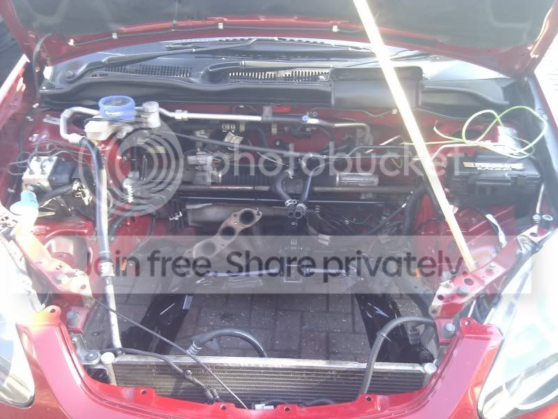

But before we fitted the engine back in we (Stu) did a few little tidying up jobs as well whilst waiting for paint to dry and parts to arrive including new Ferodo DS2500 front pads, painting the front subframe in plain black, repainting the front slam panel in Milano red, fitting a dent-remover scuttle tidy panel for the GruppeM, painting the silver door handle inserts in Vauxhall Silver and fitting an OEM manifold and catalytic converter with a matched cat-back exhaust system (in preparation for the MOT)
Then we had the small matter of getting the engine back in and getting the car MOT'd as my MOT had expired since it had been off the road. We booked an engine hoist from Beaver Tool hire for Monday morning, and I booked the MOT for Tuesday morning.
Monday morning came, but no hoist, Monday afternoon came and went and still no hoist :evilone:
It turned out the hoist hadn't been returned to Beaver in time for them to get it serviced and out to us the same day. Grrrr.
I phoned HSS in Southampton who had one in stock, begged my boss to go and collect it for me, then begged my wife to come and collect me and the hoist from work and drop me off at Stu's house.
I eventually got to Stu's with the hoist at about 8pm :shouldbeinteresting:
So we set to it and by 11.30pm we had the engine bolted in and a few bits bolted to the engine like the air-con, alternator etc, but it was dark and really tough to see properly enough to do anything properly so we called it a night, and stopped to have a few beers whilst we discussed the plan of action for the following day. 5am start and afternoon MOT was the plan, and we stuck to it. To the tune of the A-team, which got a bit repetitive after a while and cracked on, this was at about 10am:
I wish I'd taken more pictures of the different stages, but was trying to concentrate on the bits I had to do as I wanted to do it right lol!
We phoned the MOT centre to rebook the MOT once we had the engine running and the end was in sight. We got the car to the MOT for 4.15 and it passed with no advisories :WOOT :WOOT
