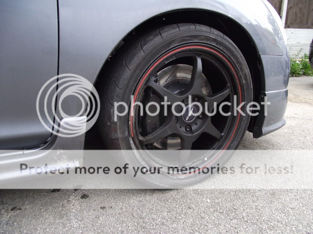

Before I post any pics I would just like to disclose that the cause of the engine failing was due to the hamp oil filter I was running had come lose. I would also like to add that I am running two sandwich plates one for the oil cooler and they other for oil temp and pressure, I know that it isn't 100% ideal that I ran two sandwich plates but for this very reason I check on a regular basis for any leaks etc which I have had non of up until now.
When I was at oulton park the car locked up when they engine partially siezed causing it to spin out and clip the curb on a corner snapping the rim of my alloy but I cannot see any other damage caused. I also noticed a nasty score on they inside of my front stoptech disc I suspect was probably caused by a stone been stuck inbetween the pad and disc. All these problems add up to be a very costly repair so I plan on leaving the car off the road over winter to get it mint.

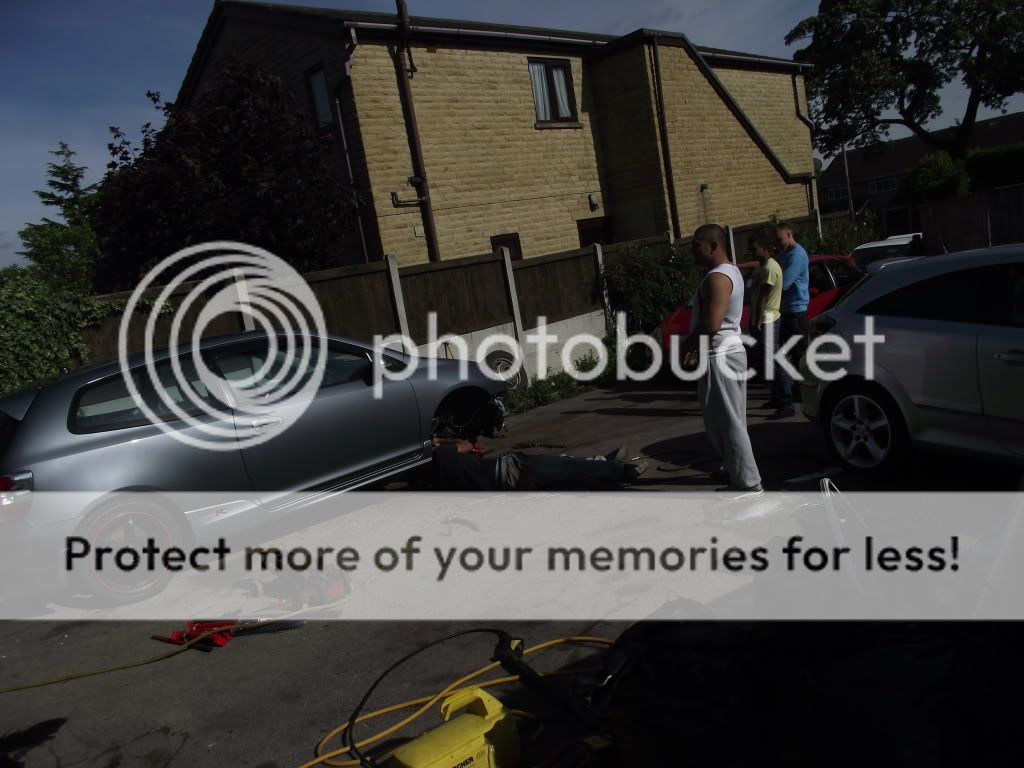

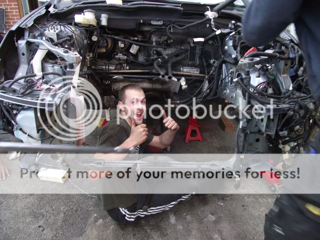

Looking good Luke, alot of work done in one day I must say. Good to see that you have mates that are wiling to come and help you out :thumbup:
So you did drop it out from the bottom on the subframe in the end I take it?

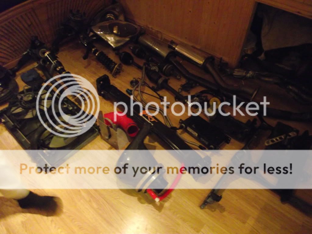

Get all the good parts cleaned up, then make a list of what you need to replace and rebuild the bugger!
Lol at Zak's happy little face lying under the car :lol:

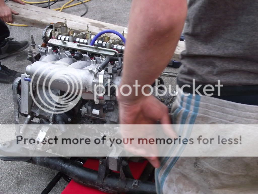

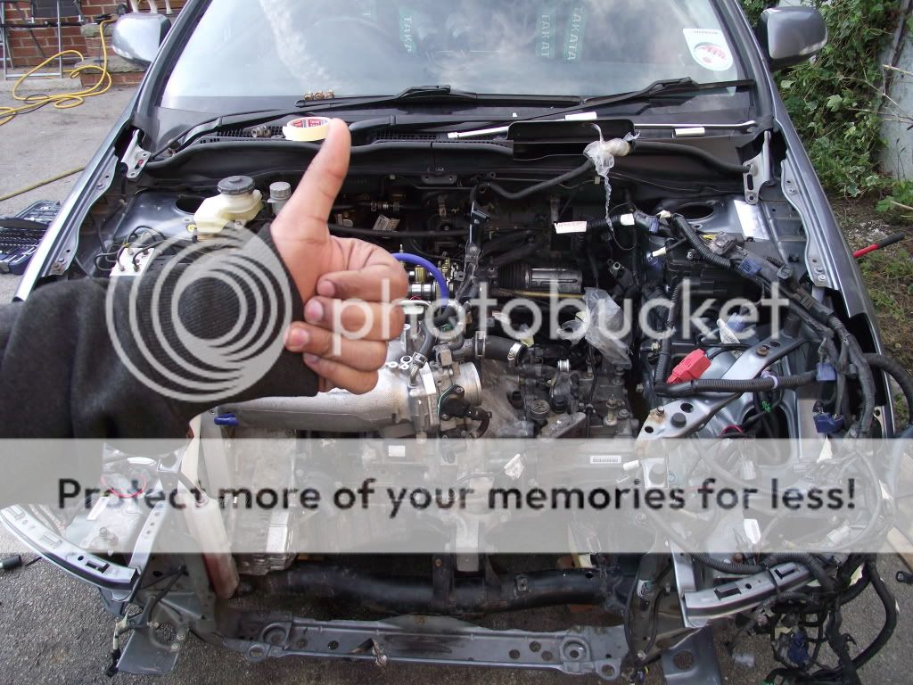

Carlos420uk wrote:Looking good Luke, alot of work done in one day I must say. Good to see that you have mates that are wiling to come and help you out :thumbup:
:salut:
Thanks Carlos, yeah your right I dropped the car as close to the ground as I could safely then we unbolted the subframe,engine mount and gearbox mount.. The next bit was scary lifting the car up high enough to slide they engine out underneath, I was absolutely crapping myself at this point :lol: But luckily we got enough clearance to pull it out of the driverside arch and all was well :thumbup:
