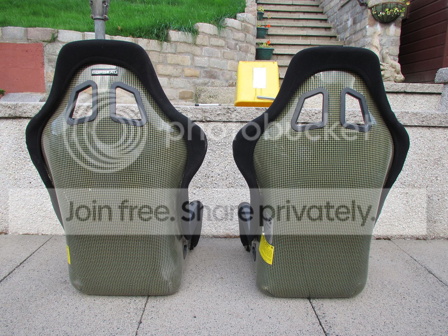

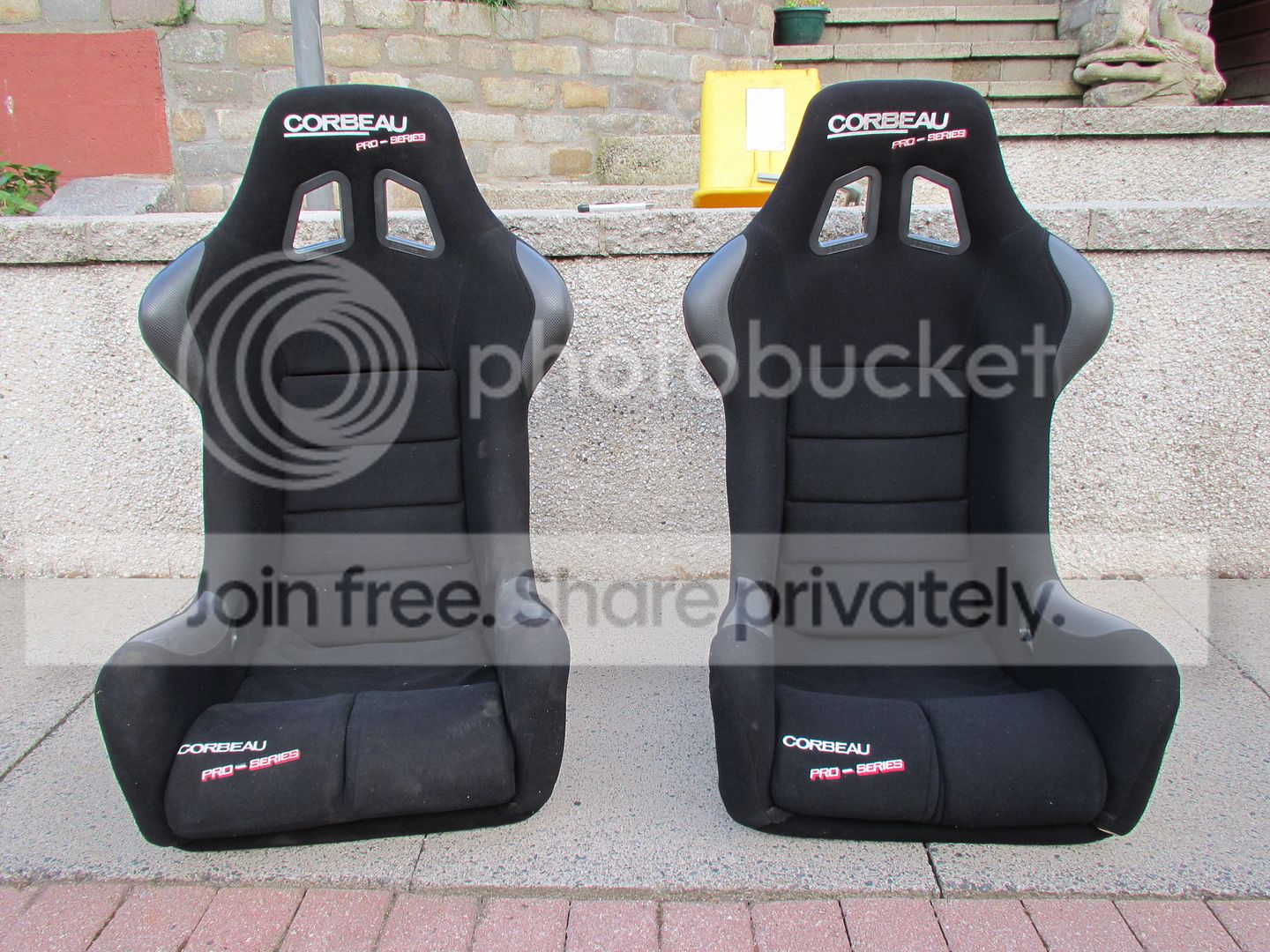

Delivery man came by today with new seats. Can't remember ordering a foot stool though...
Before and after cleaning along with removing half a forrest stage from underneath the cushions...
Was pretty chuffed with these, in excellent condition and thought i had a good deal already till i found this stuffed down the side...
Probably only worth about £15 in Scotland but better than nowt! [smilie=karls_thumb.gif]
Seats are pretty comfy. Reckon they're slightly wider than the Recaro SPA's i had in the scooby which ain't a bad thing although they do feel a lot heavier. The SPA's were ridiculously light though!

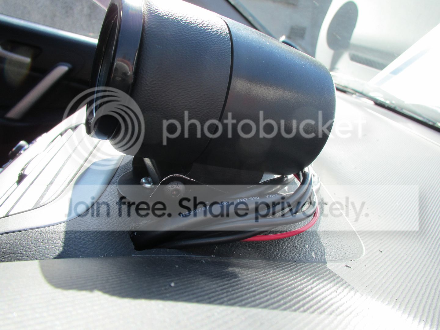

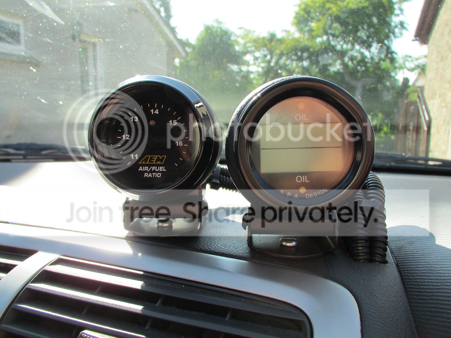

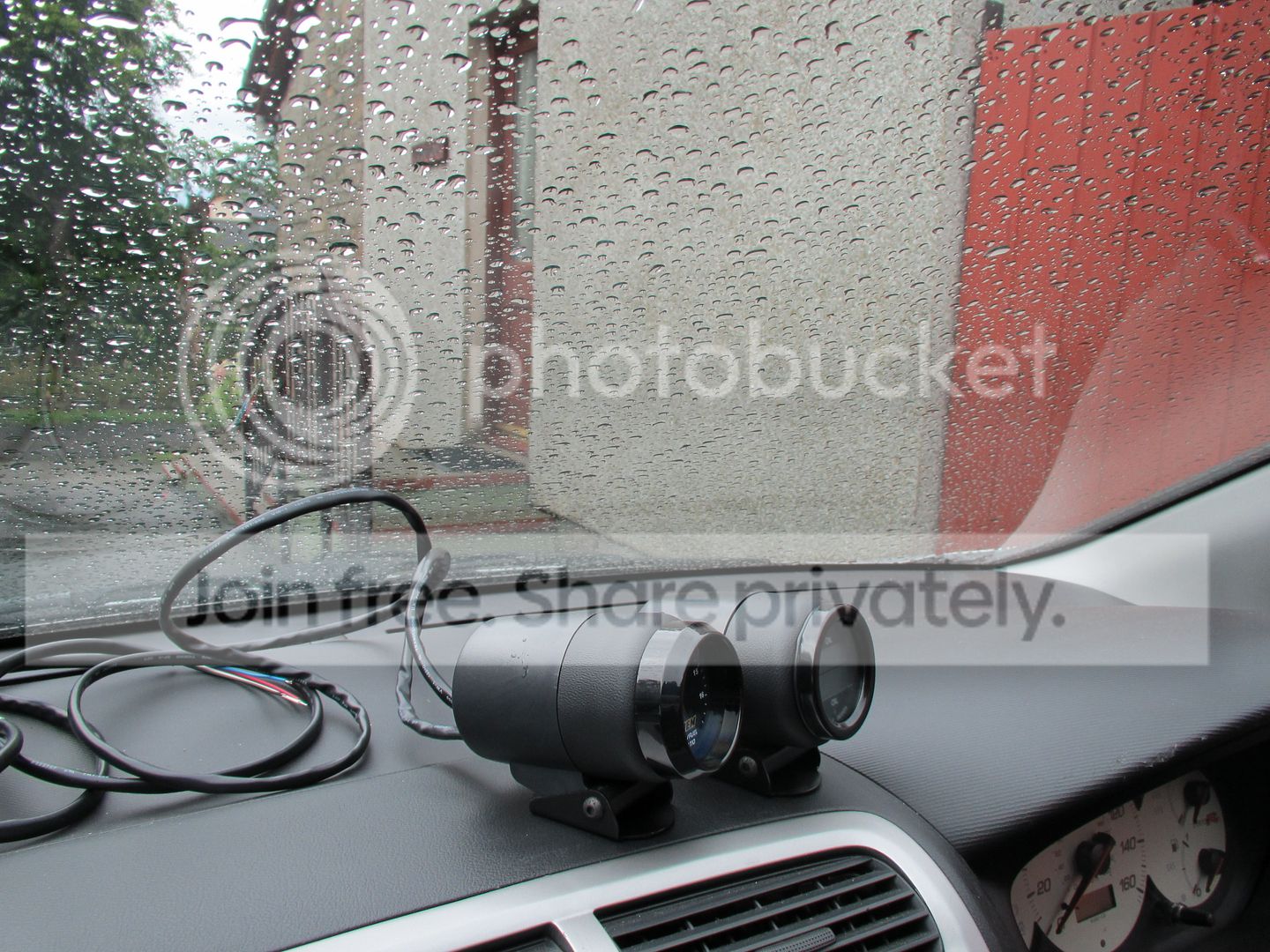

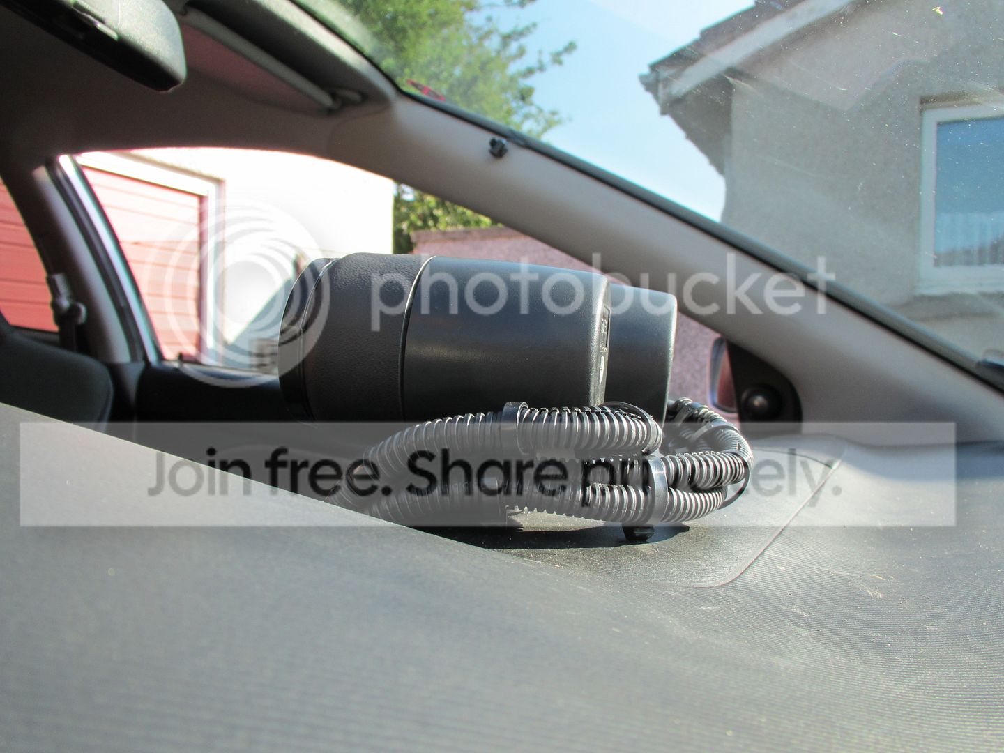

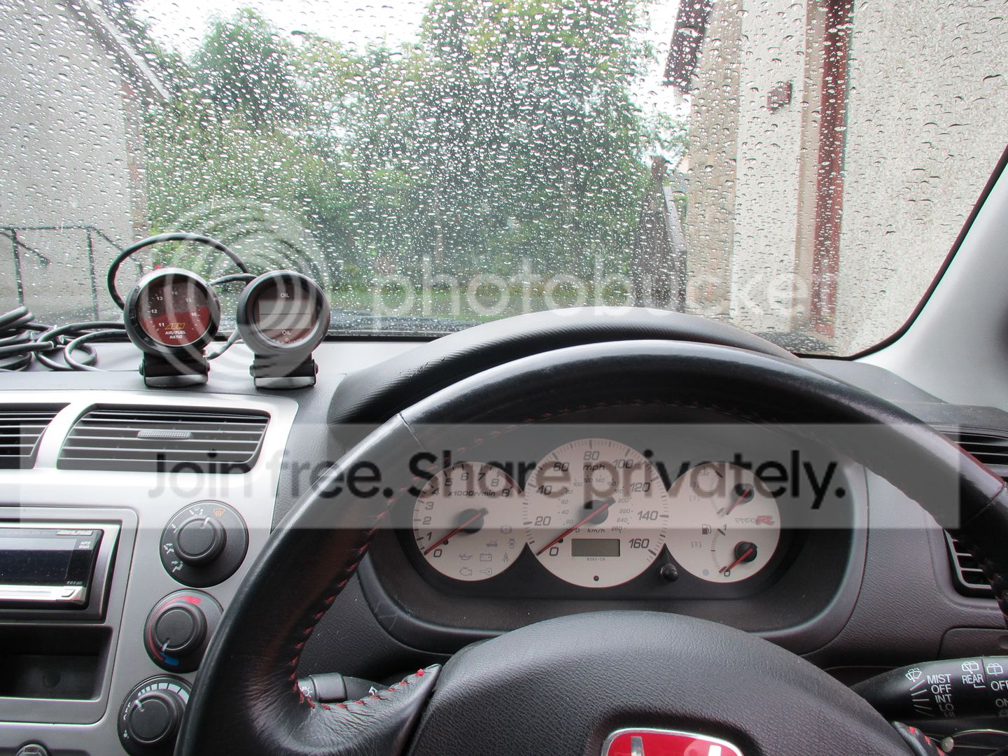

Gauges mounted as per previous pics, viewing's actually fine. Revotech pods are shite if anyones thinking about getting them! Quite a lot of expletives came out of the car in the last hour. Really isn't a job for when the sun flip's off. Still need to fit some cable tidy and get a new nut for the one that went behind the dash somewhere. :roll: Anyway, both fitted with the AFR ready for hooking up tomorrow when the new ecu's fitted and mapped. Bye bye EML, hello horses. :-D

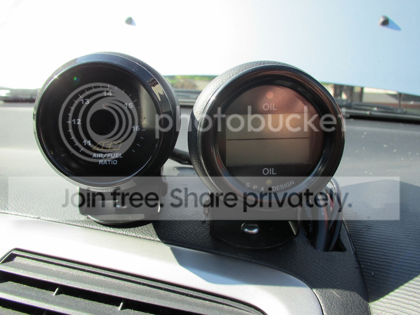

Bit of a shame about today mate but seems like you're really making progress! Gauges look great, how does the afr work, does the gauge always want to be in the middle to indicate the air/fueling is even? (sorry for the noob question! :oops: :lol: )
By doug2507
#3443716
In a nutshell....it replaces the std Lambda sensor with a wideband uego sensor. This gives a very accurate real time reading of the AFR. Running a wideband enables better mapping as its more accurate and faster responding. The gauge is the controller and sends the AFR reading to the ECU (EMS 2). The gauge, just like the oil temp/press. i'm running beside it, will give an early warning for something going tits up basically. With hillclimbing & sprints it's all short hard runs with a good bit of time in between so it's good to know everything's running as it should before and during. :bigthumb:

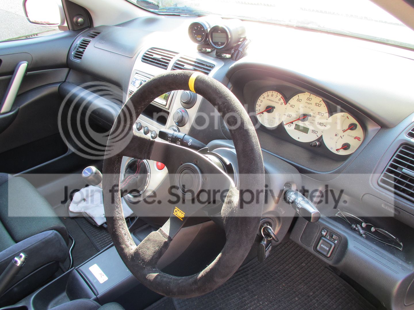

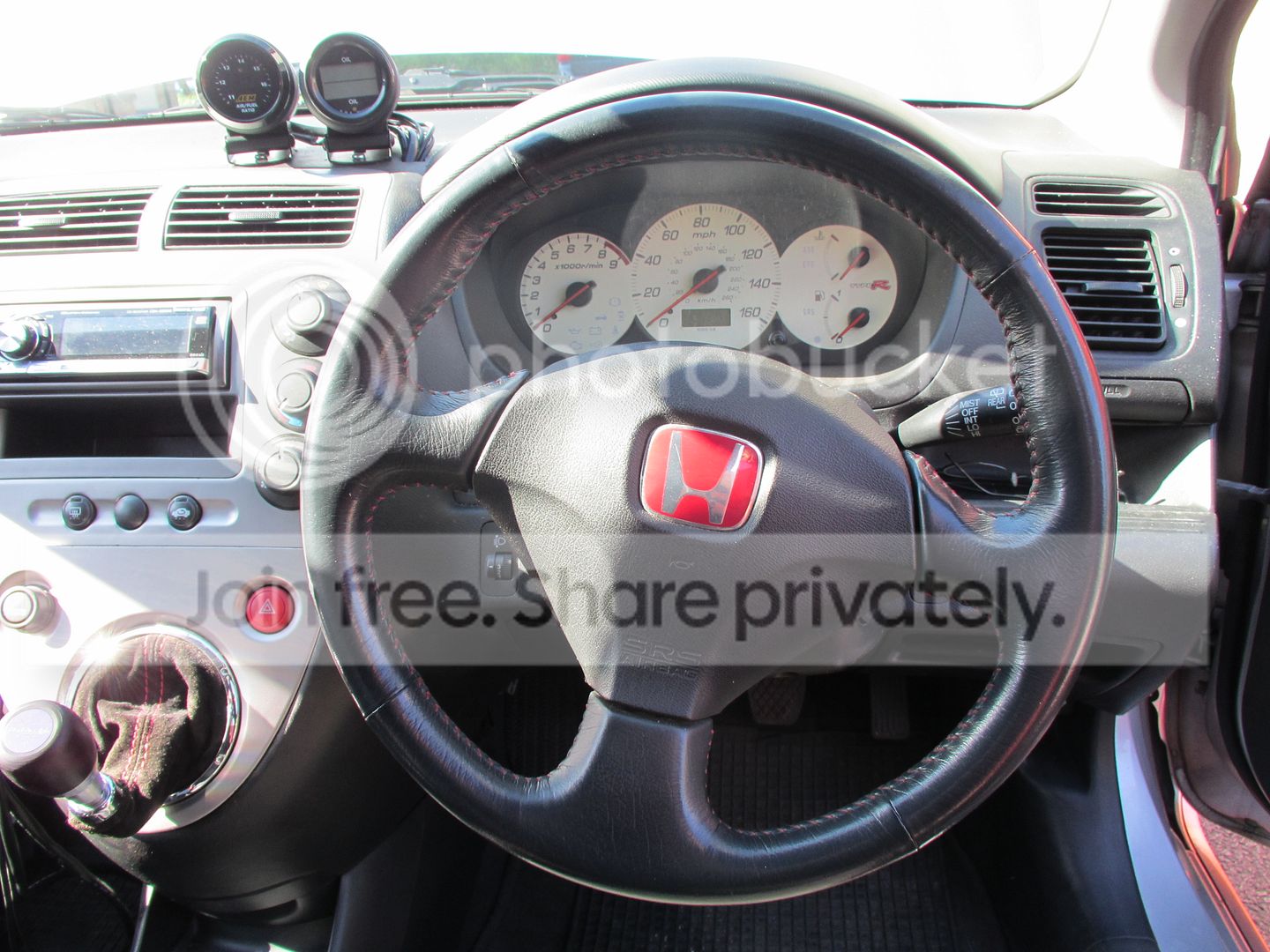

#3444364

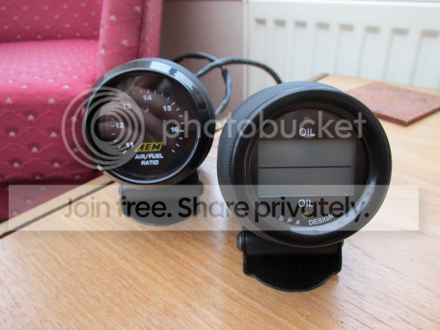

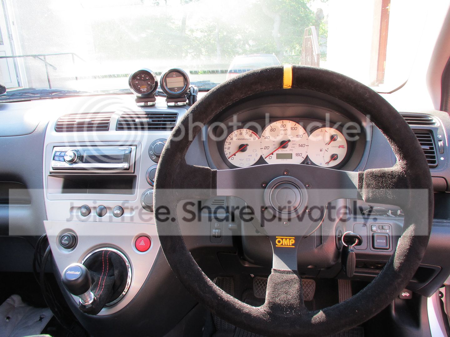

Had a couple of hours free this afternoon so got the wiring for the gauges tidied up and fitted the new steering wheel. Wheels nice, sit's closer than before which is good. Had the car out after and the feedback is far better than before. Better feel for what the front end is doing especially when cornering hard. Change of seats should help as well whenever the rails turn up! Only negative for the gauges is the AEM like's to reflect unlike the SPA which has some sort of coating to stop this. Otherwise pretty happy. [smilie=karls_thumb.gif]
Before:
After:
Before:
After:
