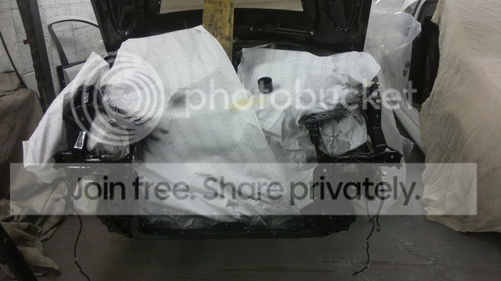

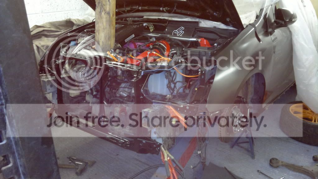

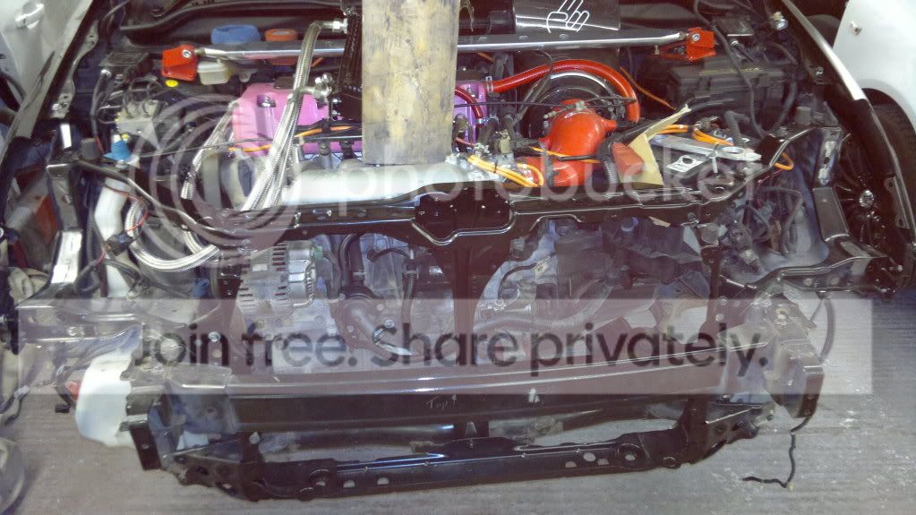

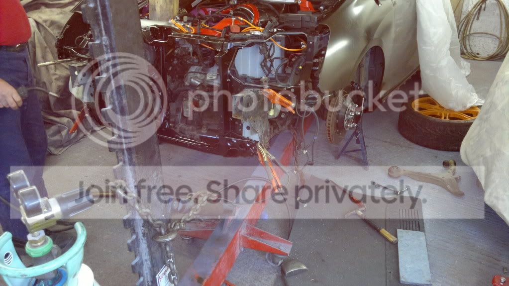

Overdue update......
Well its come a long way since i last updated, but i'll do it a bit at a time.

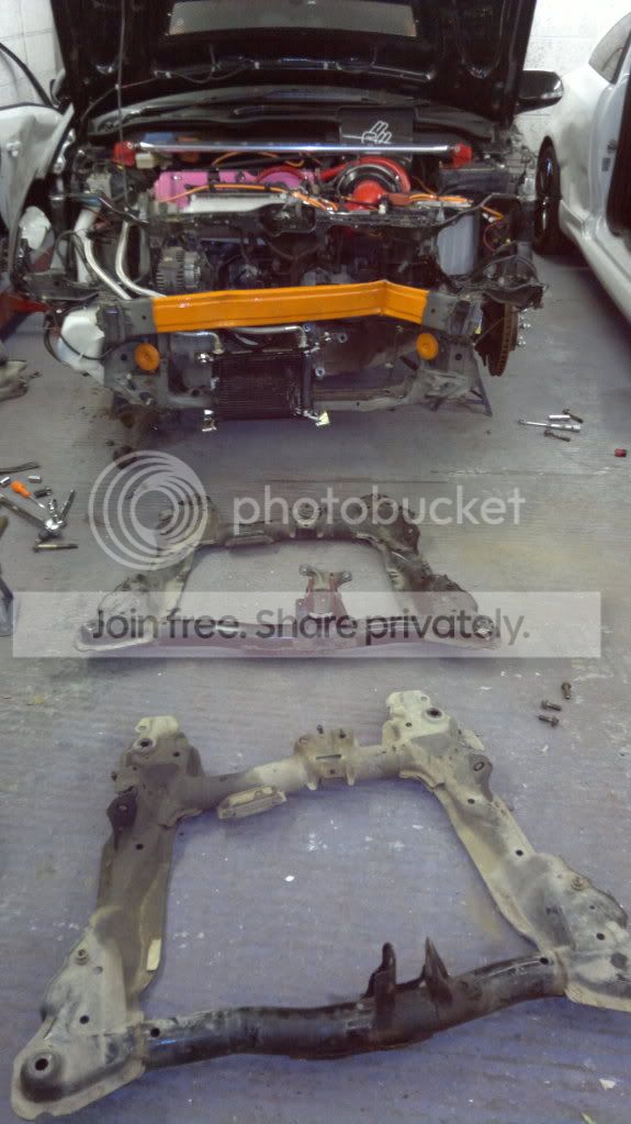

I trailered it from my garage to a mates who does accident repairs. He works for a reputable body shop doing this kind of thing every day, so i was very confident leaving it in his care. He said he had fixed much worse, which took some stress off. :lol: It turns out the front had been pushed back about 50mm, so the subframe was bowed like a banana. I got a new 1 off ebay from Integrastella and it was delivered within a few days. This was then bolted up and the front was pulled out with the jig to line up the bolt holes.
Once it was all straight we cut off the front bulkhead which was mashed and twisted round the bottom of the subframe. We then pulled the forks out to suit the new bulkhead.

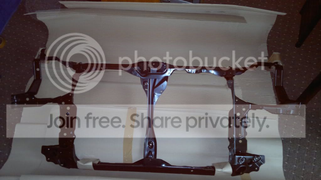

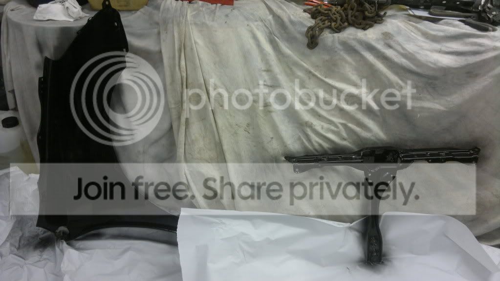

£194 from Honda and next day delivery, this was then sized up and welded into place.

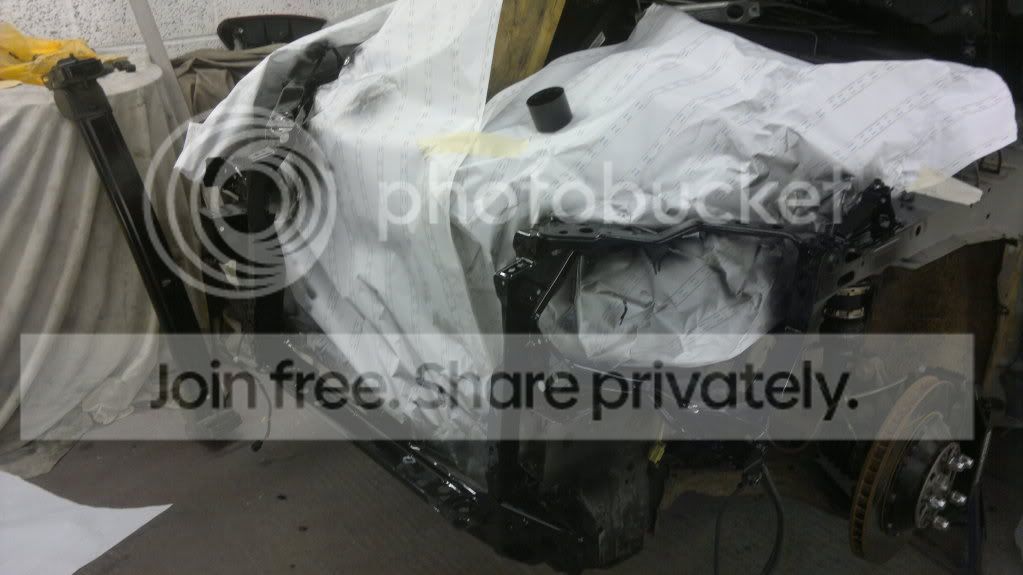

With this then all done i set about giving it a coat of paint as it was just a black primer, and with primer being porous it would rust. I also done the new wing and cut the new slam panel to fit the RBC.

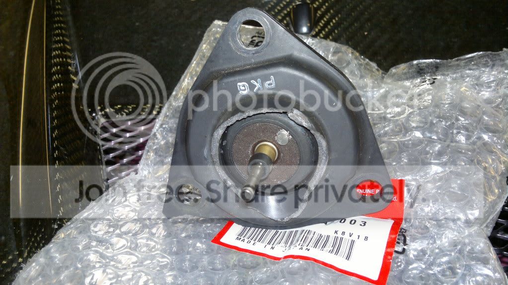

I got a bargain with the thermostat aswell. £9 delivered!! :cool: They're £70 new from Honda!! :shock: The old 1 was a mess.
