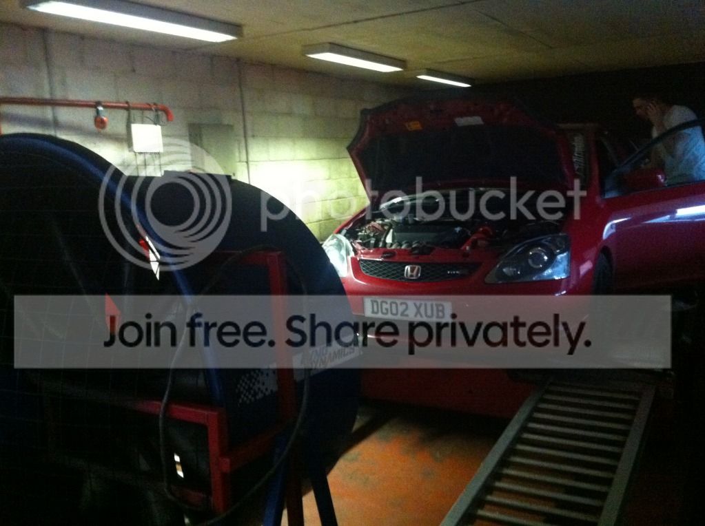

#3478710
Car made a healthy 213 bhp :) was an amazing experience, and Romain was a legend..explained really well where it was restrictive and the power/torque it was making.
The car is like an animal now, completely different feeling to it! The midrange power it has now is incredible!
Will post graphs up once i have overlaid them

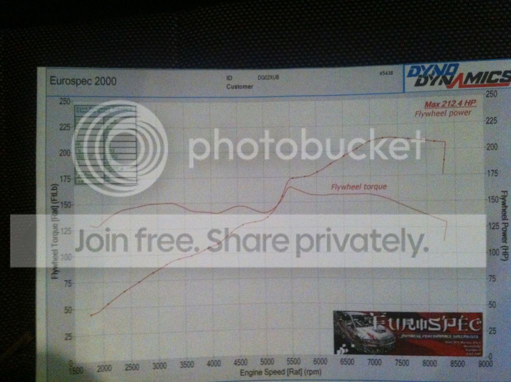

#3479396
Just after her base run:
The graph:
Spec list:
K100
Japspeed 4-2-1
Silenced r8byb bpipe
Magnex oval backbox
ITG induction kit
Im really impressed with the mid range power, and disappointed at the same time at the peak power, first thing on my new shopping list is a teg M!!
Any recommendations of what to do next?
I was told that the itg is really restricting peak power, the japspeed manifold is slightly more restrictive compared to a DC, and the mix and mash exhaust setup is a little restricting. Not really sure where to go with this now..
Im happy with the noise levels at the moment, but could be that little bit louder. I have had an unsilenced bpipe with the magnex but it is just that little bit too loud. So a point in the right direction would be awesome :)
#3480083
hmm yea me too, but looking back over the K100 group buy thread and i seem to be making the same power as some of the other guys with similar mods.
Also if you look at the graph, the curve at peak power is just diving straight down!! This is down to the ITG making mid range power rather than peak, so am on the hunt for a tegiwa m.
Even though the peak bhp isn't as high as others, mid range it made over 45bhp difference compared to standard and you can definitely feel it!

#3480130
Maybe it the rbc manifold that make the difference up to 240ish
Can't see a different induction making it up to that much power?!?
Yea agreed, I think i will be looking to getting a dc exhaust, tegiwa m and an rbc before the next map :)
it all depends where i want the power, the itg is amazing at mid range torque, but up in vtec where the peak power is really made, it is sh-t :)
#3480164
C2AXG wrote:I would have thought it would of made more than 213bhp with all those mods??
nomally when you see 240-250 dyno results they are done at tdi north which has a rather "happy" dyno when it comes to result.
as for getting more out of it, change the filter for the aem cai if on a budget and rbc inlet manifold [smilie=karls_thumb.gif]
#3480178
cheers for the advice :D
it is a new k100, but through the group buy not too long ago which included supply, fitment and mapping sesh
Although the aem cai is a good alternative, i have wanted the tegiwa m for a long time, and i know if i dont get it, i will always be regretting not getting it.
And yea i have heard tdi have happy rollers compared to eurospec, which is why many think tdi are the 'better' mappers
