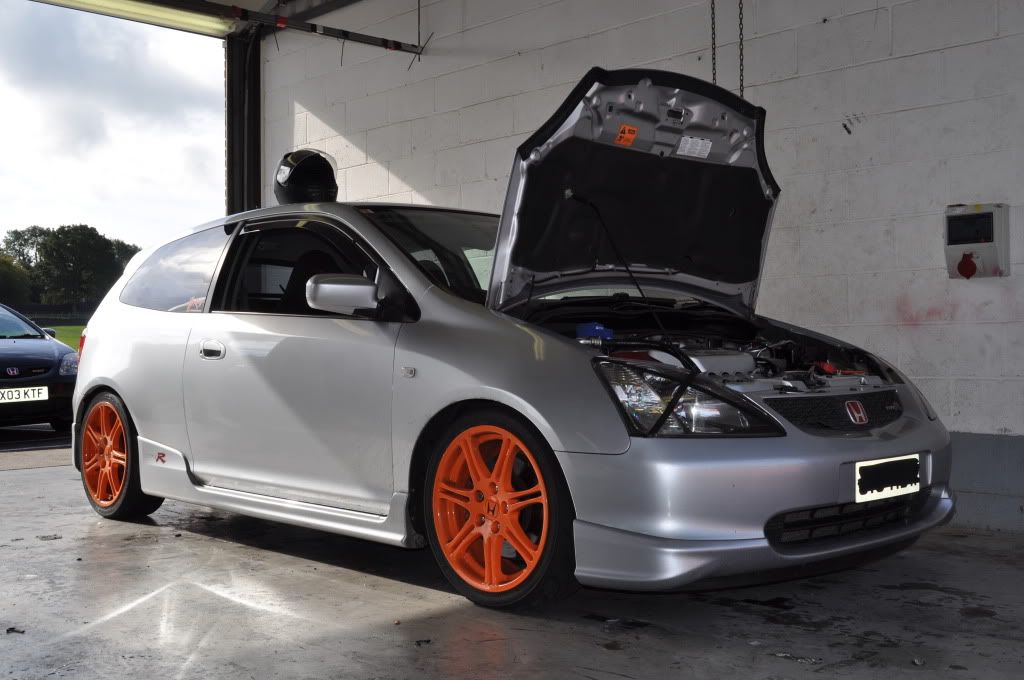

bluntcap wrote:Awesome car mate, takata green will look brilliant, but as mentioned orange will also work great with cosmic :thumbup:
Cheers dude, I also thought takata green would look really nice although orange would look cool too. I'm in a dilemma now :-| ... :-D
I was the same while trying to choose my wheel colour, settled on midnight purple, but takata green was a very very close 2nd.
I know its never an easy choice is it, I just want a wild colour for a set of track wheels but who knows ill most probably stick with the buddyclubs for now.

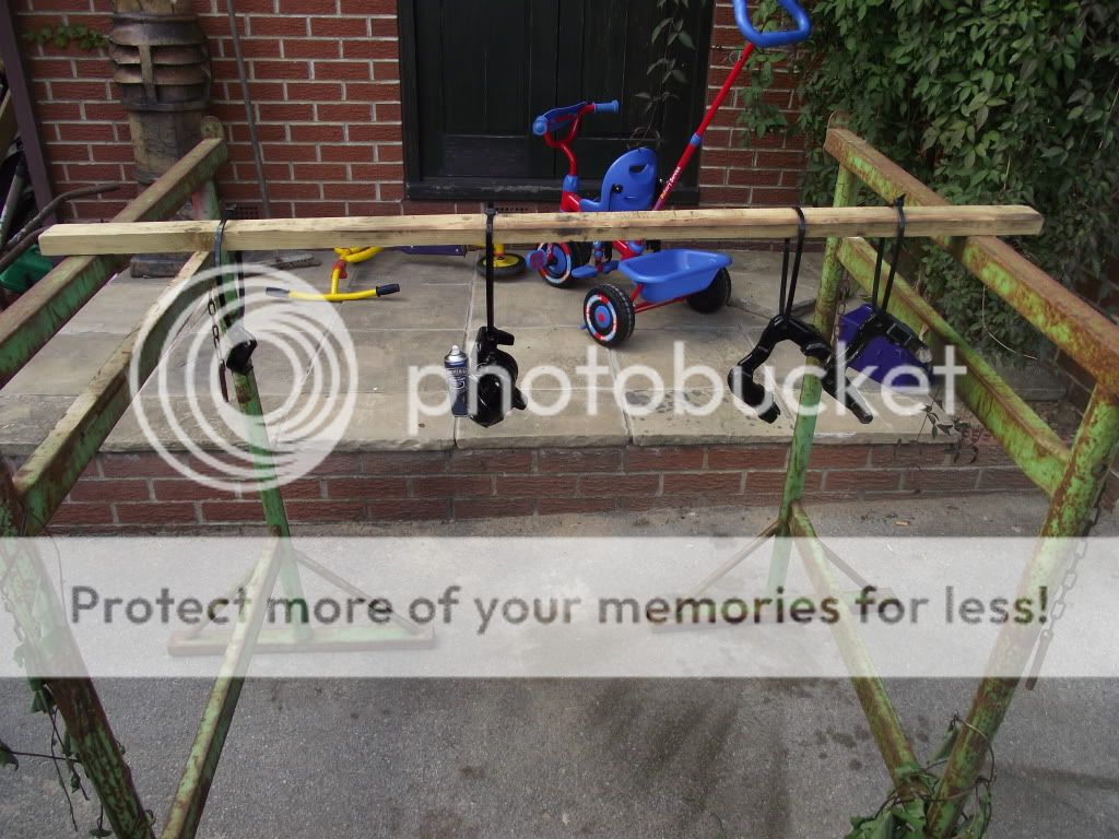

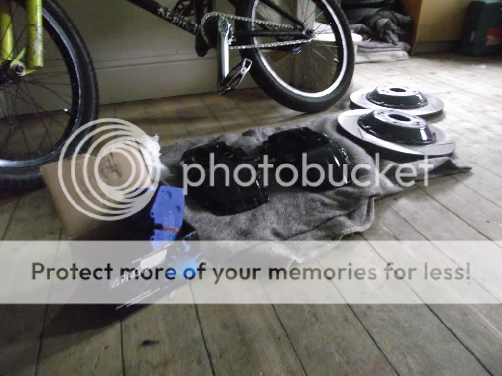

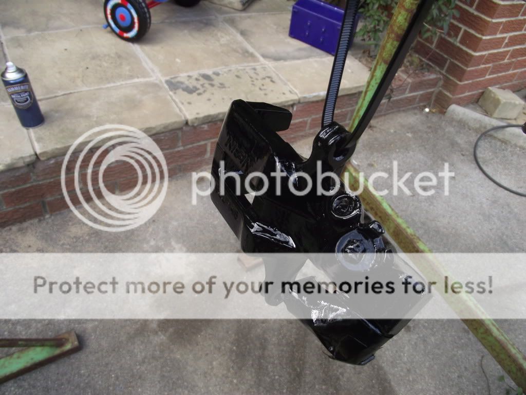

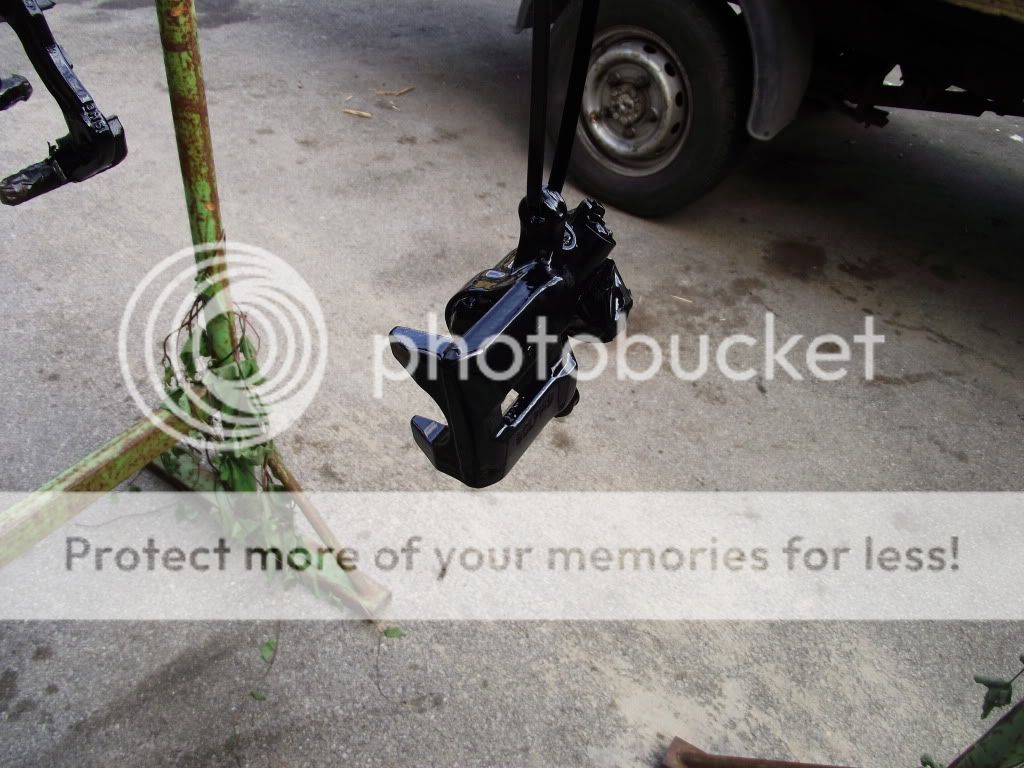

I've been quite busy with the car this week stripping callipers and painting them aswell as putting new pads, skimmed discs and some rbf 600 in. It got a little annoying at times due to the paint been so soft :scratch: I ended up painting some bits again but I got there in they end anyways only got a few pics will upload shortly :thumbup:

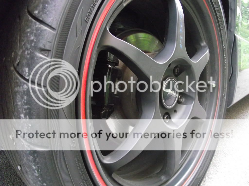

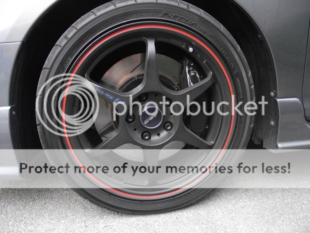

if these pics are as they are now then you have fitted the discs on the wrong side.the slots should be facing the other way.the slots should be pointint to the front of the car.the vents in the middle of the disc are shaped to aid cooling so it does make a difference.
#3024168
no worries mate.also the vent in the caliper plate that you refit after fitting the pads with the 2 long allen bolts has to be a a certain way too,vent at the top of caliper..cant see from the pics which way you have it as it will fit both ways.
