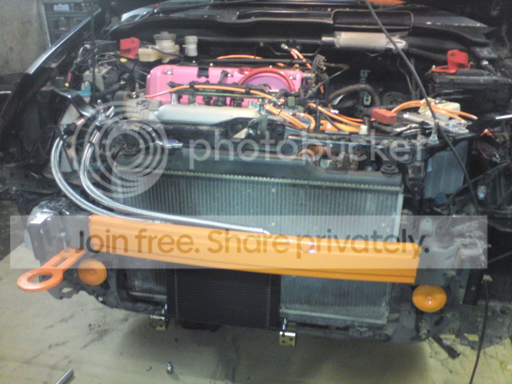

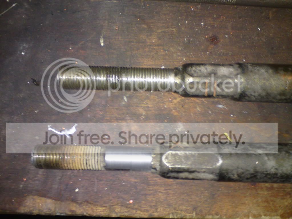

Update.......
I had the steering rods lathed so i could extend the thread further down and chop a bit off them. This is needed to run -3 degrees camber. :cool: I then tapped them further down.

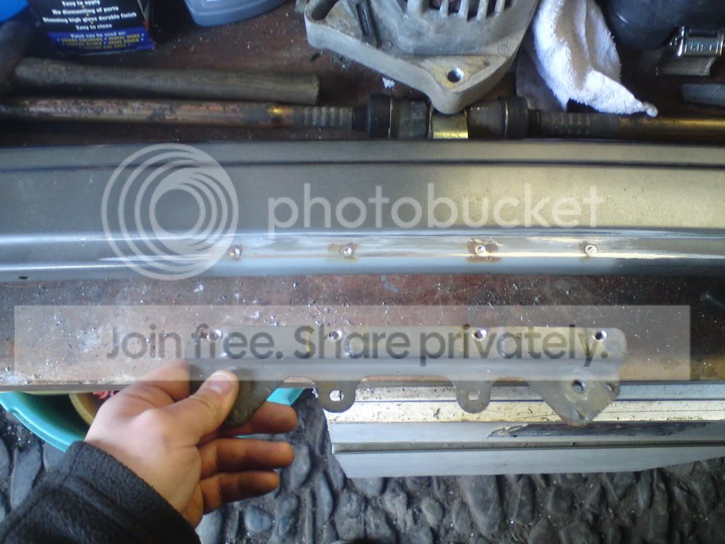

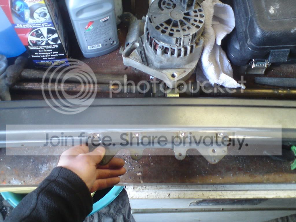

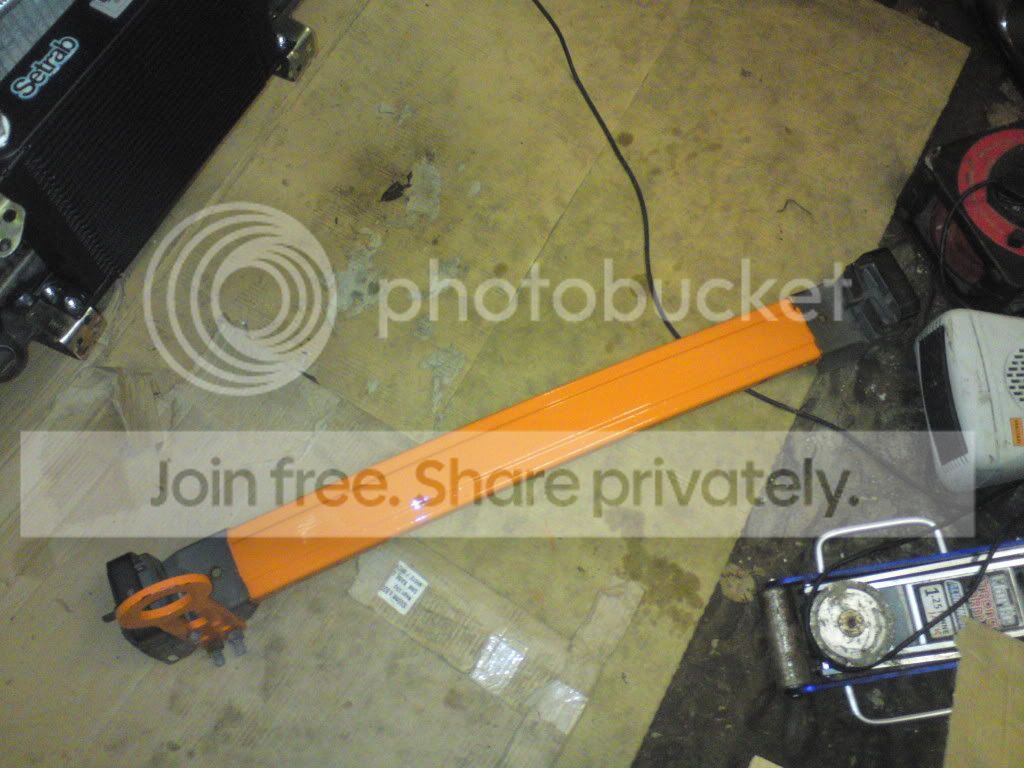

To fit the oil cooler the crash bar had to be modified. The horns and bracket would have rubbed a hole in the rad, so it was removed.
Then, in my drunken state, thought it would be amazing to paint the horns and crash bar hammerite orange so you could see it through the holed bumper!! :lol: :roll:

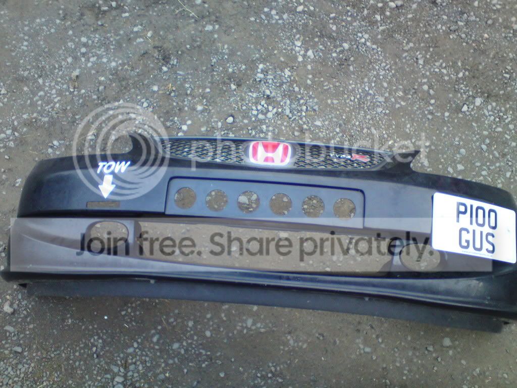

And the holed bumper..... And i offset the plate so it wouldn't interfere with cooling.

Carlos - Yea, we have. I've just fitted the exact same new track rod ends aswell. :lol: I think you've been stalking me. :P The steering is mega heavy now without the motor!! But then again, ive only drove it round my yard a couple of times at low speeds. If i'm not liking it i'll fire the motor back on.
