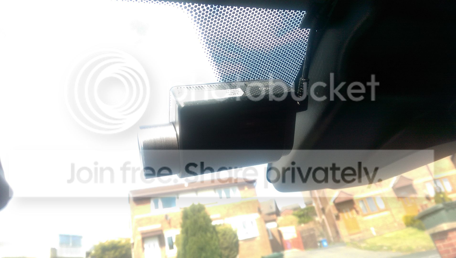

Thinkware F750 with rear camera option.
Sticky pad mounted on the passenger side about 4" down from the top of the windscreen and 1.5" to the left of the plastic housing behind the mirror, basically just where the edge of the wiper cuts across.
You can't see it sat normally in the drivers seat.
Hardwired it using the hardwire power lead to a self wired/crimped OEM connector into the option connector on the internal firebox. 12v constant for park mode and 12v switched on ignition to start normal continuous recording when moving. Tidy job, better than fuse splitters IMHO.

thanks for the pic mate, i def need to look for a long thin one instead ,
bugger as the Mrs just got it for my birthday but not even sure it'll fit in her mazda3 as they have a big nasty cowl round the mirror too with pimpled glass just like the FK
