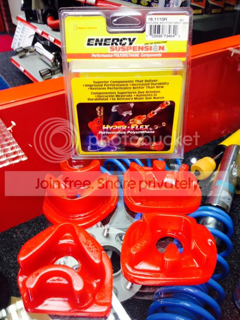

does it not have engine mount inserts? can get a second hand header for around £200-£250 depending on what it is. there were a few for sale around xmas, haven't seen any recently except some piper ones

as far as I know you only need 1 set of energy suspension engine mount inserts. I think only the rear are fitted but not sure? It's said that only 1 set are necessary, with both sets the car will vibrate alot. they cost around £25, think I got mine from ABP motorsport although you can get them from loads of places.
As for manifold, it wouldnt be too difficult to get a hold of a 2nd hand DC sports, as this would not affect your mapping too much. Failing that, I think japspeed are of similar design? just trying not to alter the flow too much is it will impact your map somewhat.

*nub* wrote:mine doesn't have a flexi and isn't designed to. don't fit the manifold without the inserts though or it will crack again!

Lewisgame wrote:Regardless what you do, you'll need engine mount inserts. Otherwise you'll wreck the new flexi or if it's welded solid you'll crack the manifold.
Iv got them mate ... So what you recon is best ? Weld or new flexi ?

*nub* wrote:as far as I know you only need 1 set of energy suspension engine mount inserts. I think only the rear are fitted but not sure? It's said that only 1 set are necessary, with both sets the car will vibrate alot. they cost around £25, think I got mine from ABP motorsport although you can get them from loads of places.
Yes we keep the front & rear engine mount inserts in stock for the EP3
These are Energy Suspension products so very good quality and the only type we fit when fitting the DC sports or Piper tubular manifolds
£26
Hope this helps?
Dave [smilie=karls_thumb.gif]
