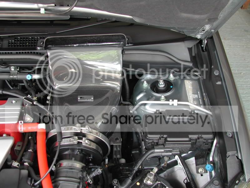

That's a matter of opinion , at the end of the day the OEM airbox works fine . If you can spring for an expensive induction kit then by all means do so . It has rave reviews and is proven to be one of the best kits for the EP3 . Obviously there are plenty of other systems to choose from so do your homework .
Is it difficult to fit ?
No , all parts are supplied with the kit to fit straight into your engine bay . Its a simple job and takes 30 min's tops . Most of that is figuring out how to build the Lower case and adaptor :oops: . Few screws and the OEM box is out , assemble the Gruppe m , then bolt it all in .

Make sure your scoop clears your bonnet before slamming it down , some scoops STILL foul the bonnet and may need minimal shaving off the edges . It's a £50 mistake so be careful

Next thing would be the OEM breather hose . The Gruppe M does move about in your engine bay so the OEM pipe tends to split . Other pipes can be sought like so ....

How do i stop it from shifting about ?
There's tons of fixes for this and it's all trial and error , here are some examples ...
