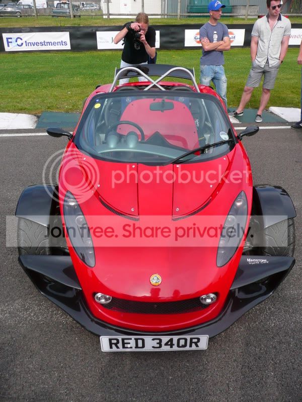

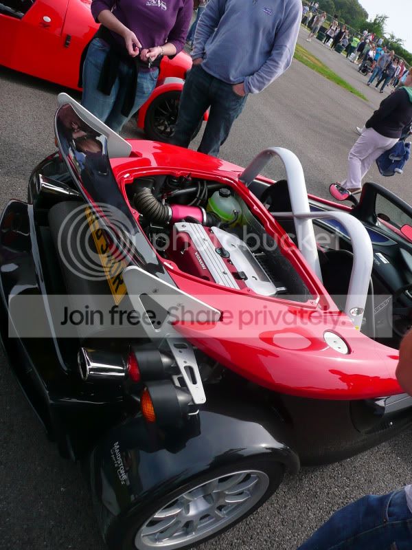

Looks like a toy car in that pic :lol:

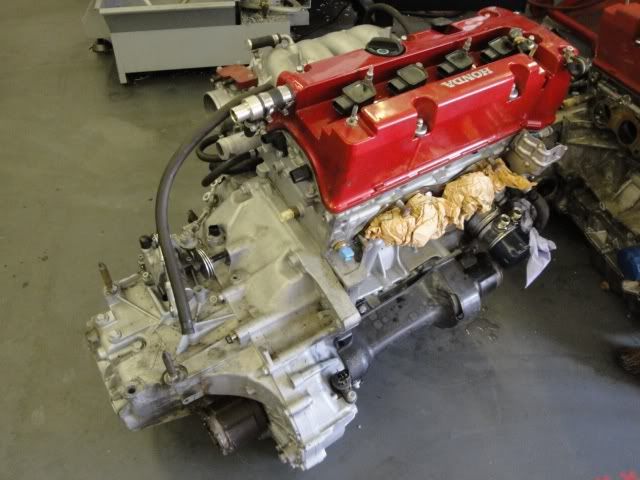

You have to wonder why Lotus didn't go with the K20 engine in the Mk2 Elise rather than the Toyota engine.

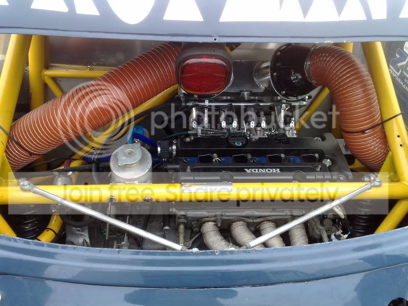

jymmm wrote:do i spot a pipercross venom in that lotus ?
And..?
By jymmm
#2895509
And..?
:scratch:
is that a yes or a no ?
By dandemoraliser
#2895683
And..?
don't really matter when you can get the cold feed out that easy!

DANCTRs-o-t wrote:You have to wonder why Lotus didn't go with the K20 engine in the Mk2 Elise rather than the Toyota engine.
Indeed.

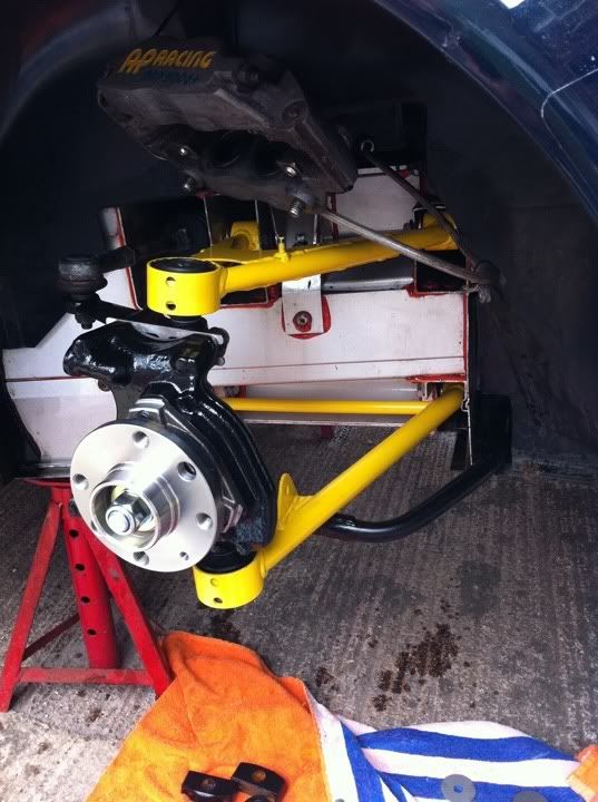

have started on a fairly major rebuild...
engine out....
charger sold to be replaced with a slightly larger one ;)
along with...
and to cope with the extra power ive decided to fit the uprights and wishbones from an S2 elise K series car so i can run the bigger GM bearing packs...
have fitted the two pot calipers from the front to the back and retained the handbrake calipers...

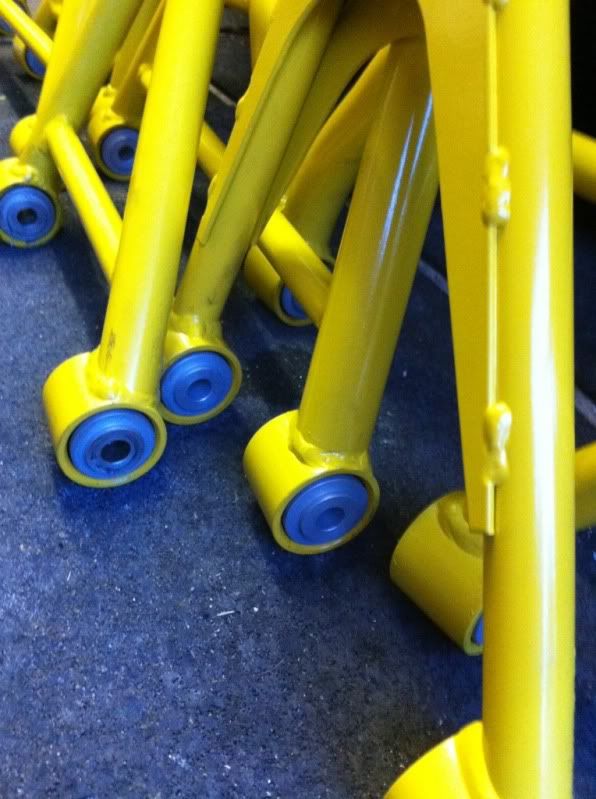

rose jointed wishbone bushes...
marc.
