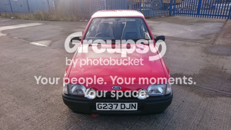

Sold the mk3 as I wanted something I could drive. And couldn't justify the price of a pro paint job.

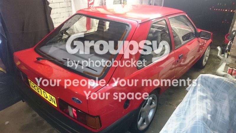

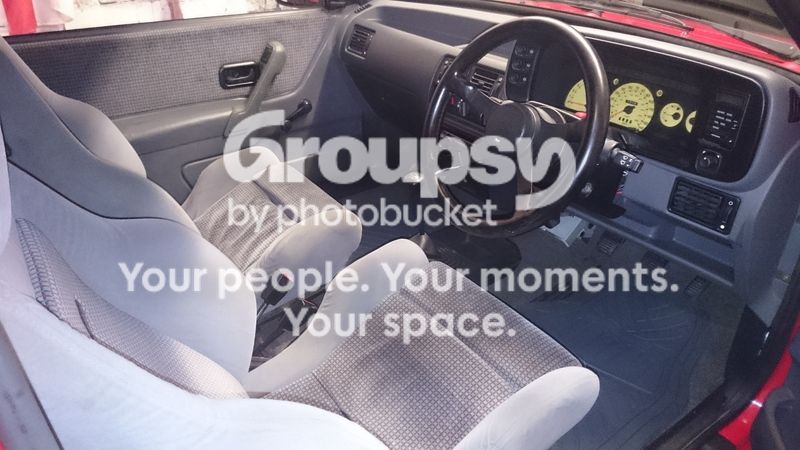

Picked up my new toy today. 1990 mk4 Escort 3 door 1.3 popular. Running a 1.6 efi engine, Rs turbo full interior, steering wheel, and brakes. Apex suspension and 16" alloys.....slight misfire to sort on engine, alloys will be changed for 15" alloys.....swapped the spots for some smaller ones I already had, and gave it a good clean.
Interior
Lovely Rs 4 spoke
Exterior after a good wash and wax, and spots swapped over. Looks good in pics, but has a few battle scars.

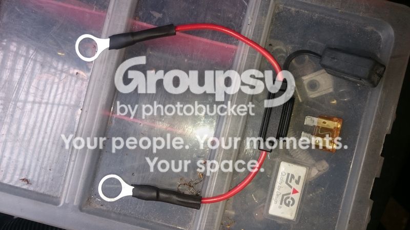

Made a lead with 5amp fuse, to fit on isolator switch so I don't lose any memory in the electrical system. If you try to start the car, the fuse will blow.

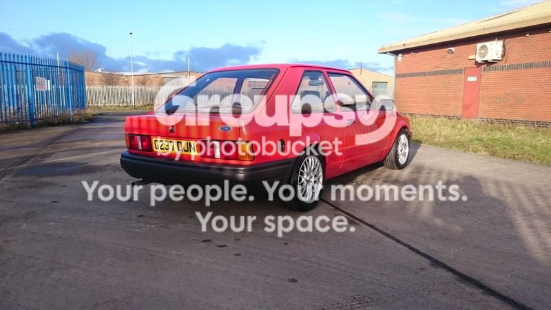

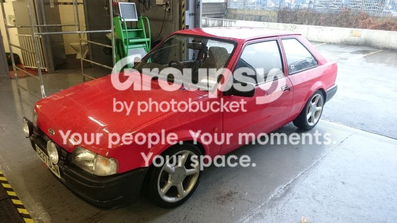

Well, worked 120hrs over the last 2 weeks without a day off....so dropped the Escort off at my brothers work to get shocks fitted, rear brake cylinders and flexi hoses. And set up on the diagnosis machine. :)

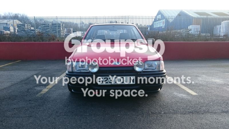

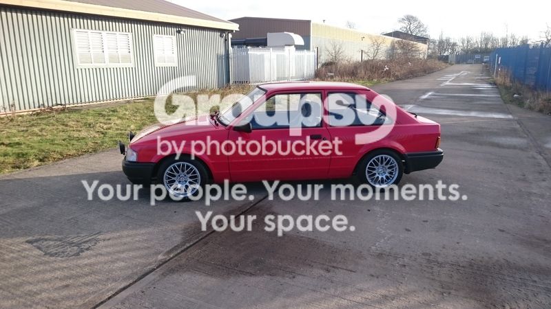

Some better pics of wheels.
Overall pics, love the way it looks. :D

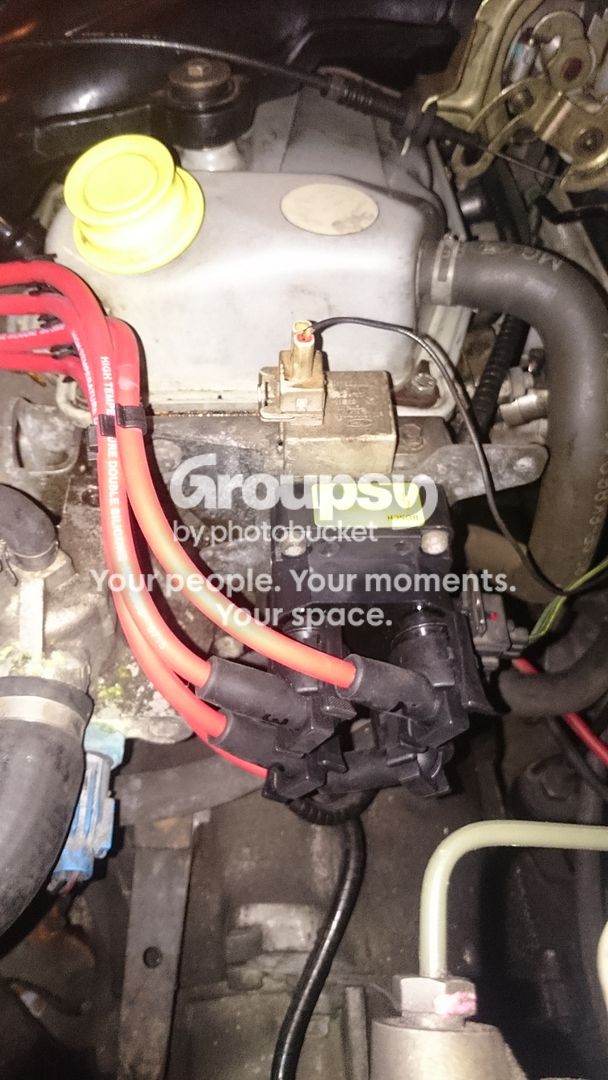

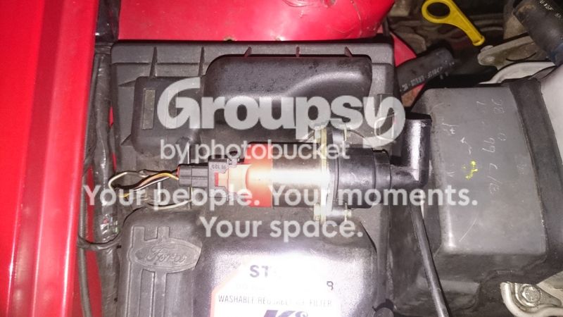

Decided to replace the cheapo coil pack with a Bosch one, as leads kept pinging off.....fired her up, ran loads better and when warmed up leads didn't ping off! Revved up a bit, backfire has gone, and idles better but still a slight misfire.

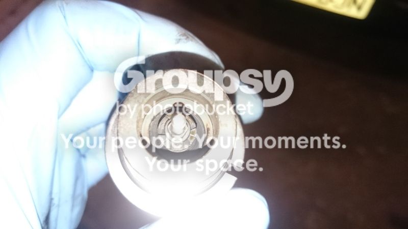

So, as mine is a early efi it has a Weber idle speed control valve that is meant to be cleaned every 10k miles....don't think this had ever been done!
All clean and operation checked.
Then I checked the breather hoses, the crankcase breather filter had broken down and blocked the hose between breather filter and air filter housing.
I have unblocked hose and cleaned it out, all other hoses are fine. Will get a new breather filter and put it all back together. Have also checked all electrical connections and cleaned with contact cleaner. Hopefully the car will run ok now, and I can get the co2 and emissions set up on a diagnosis machine. Fingers crossed. :)

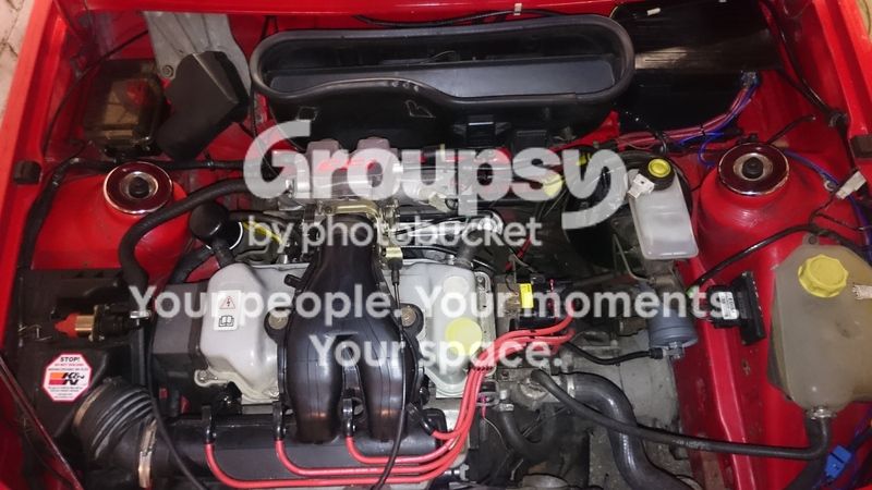

Happy now, car runs smoothly (for a cvh lol), idles smoothly, gets up to temp and fan kicks in, no misfire or back fire. :D
Just need to change rocker cover gasket for rubber one, clean engine bay, clear old faults on ecu (when reader arrives), got a new oil cap on order (seal starting to go one old one), going to change cam belt too (just to be safe). :)

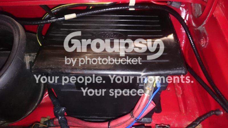

Fitted my battery cover.

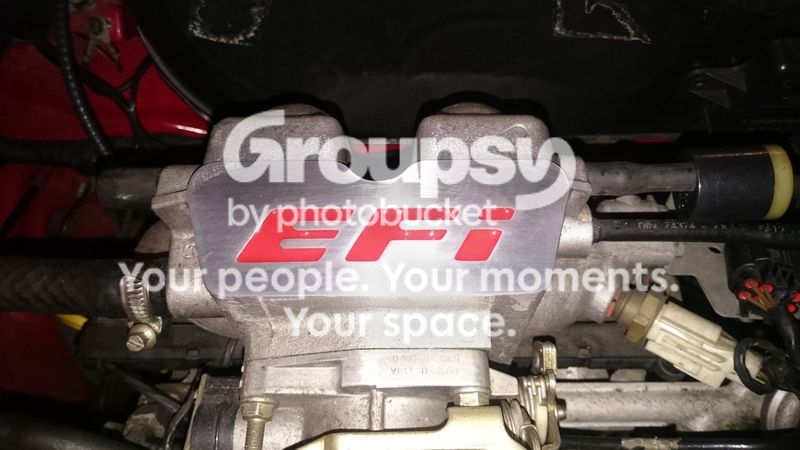

Painted efi bit red.

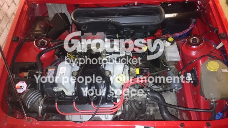

Top half cleaned, and tidied up.

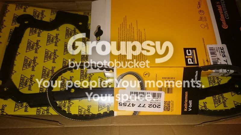

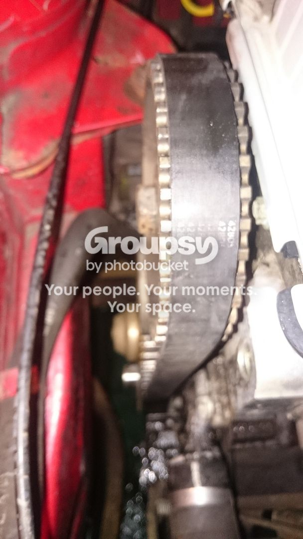

Started on the car again after work, stripped the intake, airbox, cambelt cover etc.....and cleaned head off. Got new rubber rocker cover gasket, drive belt, cam belt and a new oil cap.
Drive belt and cambelt look like they've been on a while, will get some more pics tomorrow.

All back together now and ran up, seemed to struggle to start with but once warmed up it idled ok. :)
Old belt, starting to get a bit thin!
All back together again, gave everything a good clean too. :)
