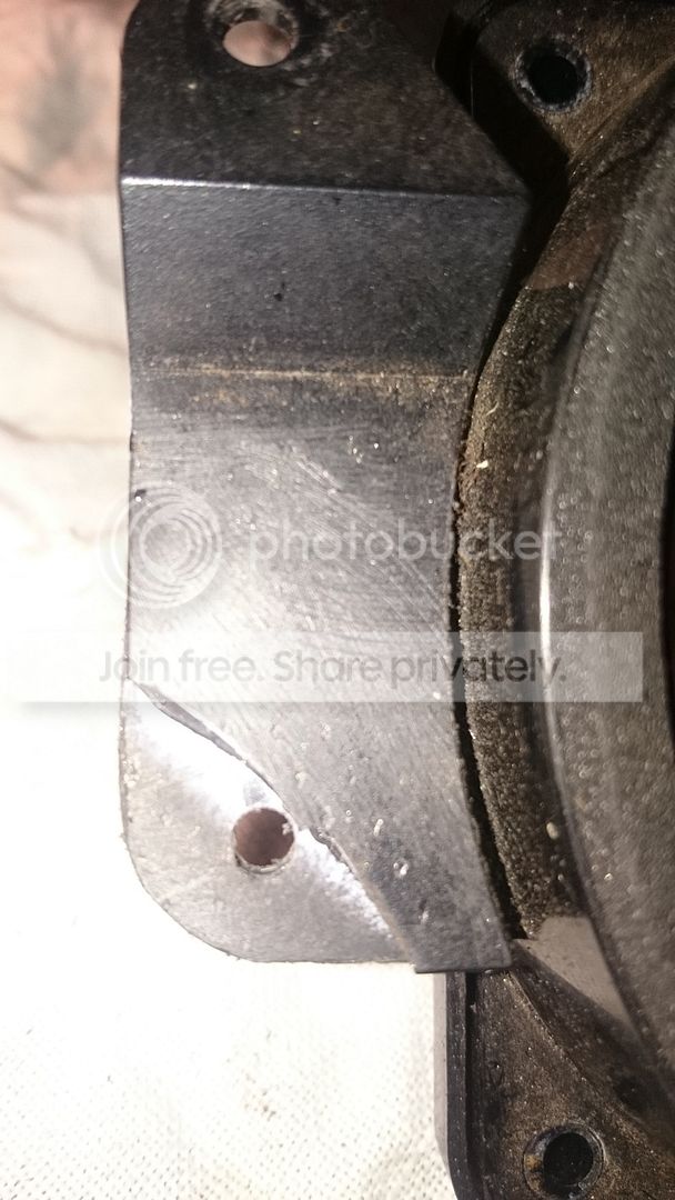

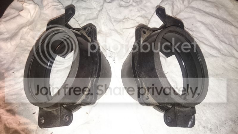

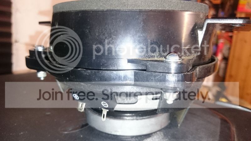

Speaker adapters finally arrived today. :D
One had a broken corner, so had to make a new piece and bond it in place. Will leave it to set before mounting the speakers.
Also needed 5" speakers not 4" so exchanged them for these.
Need to get some m4 screws tomorrow to mount the adapters to the parcel shelf supports. :)

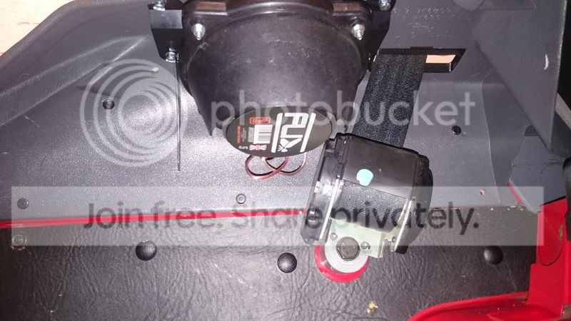

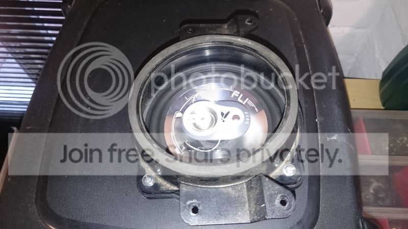

Rear speakers fitted. :D
Did make a little mistake though lol :D
Sorted now though, so set it up playing Faithless - insomnia.......hope my neighbours enjoyed some old school tunes lol :D

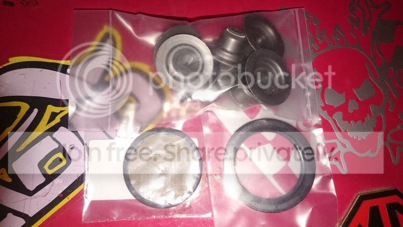

Engine flushed. Sump plug, and new filter fitted. All ancillaries except cam cover removed, ready to fit new cam, followers, and valve stem seals. :D

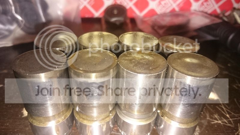

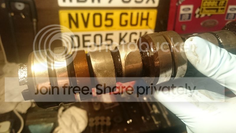

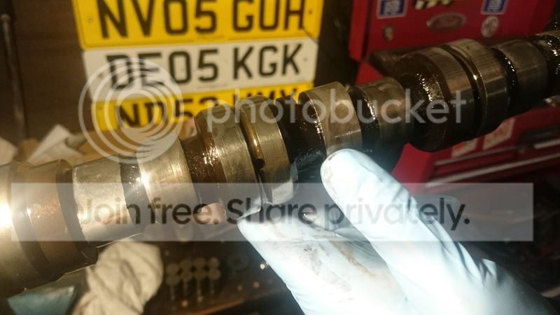

New camshaft and followers fitted, well happy......so much better. :D
Old followers, most are bevelled at the edges and one is badly dished.
Camshaft is knackered, one lobe has worn right down!

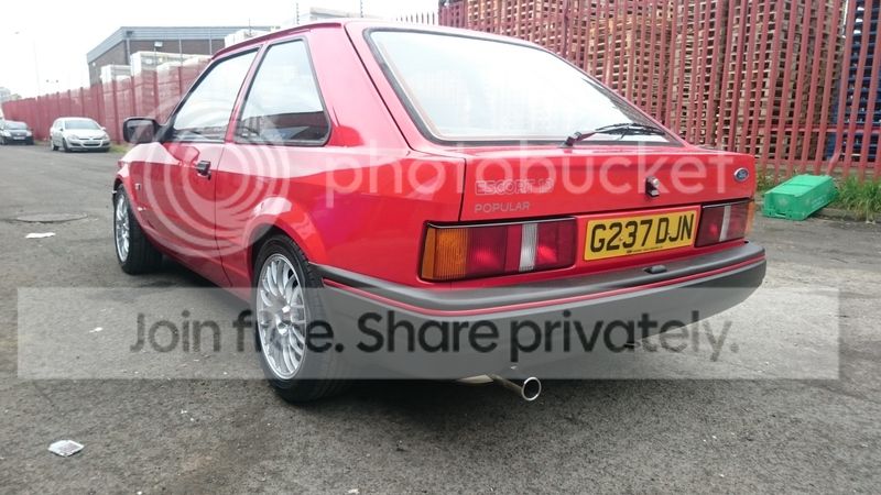

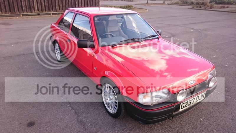

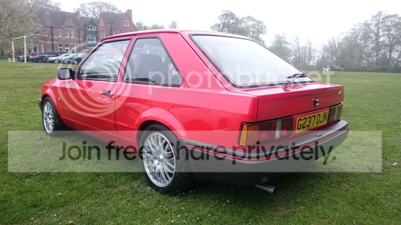

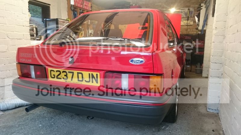

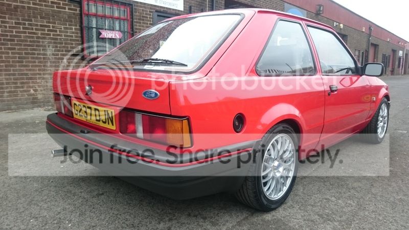

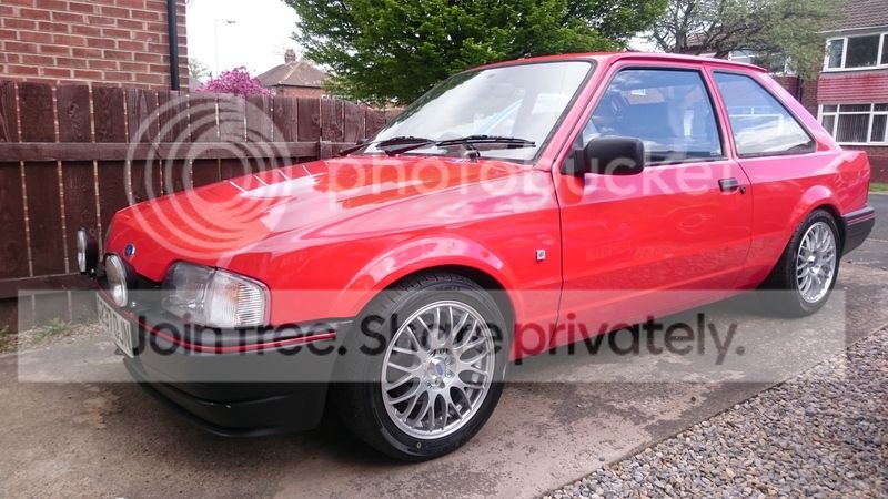

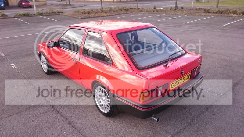

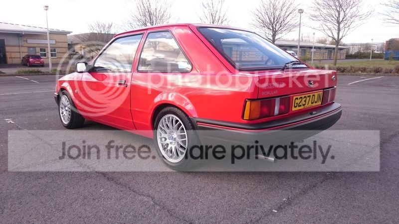

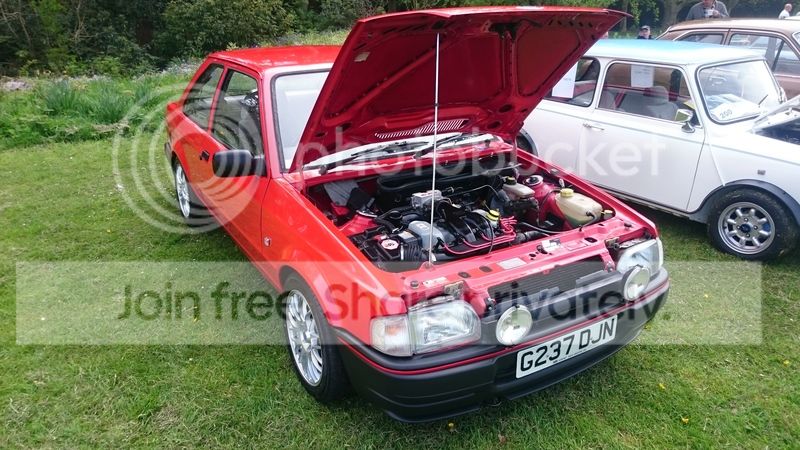

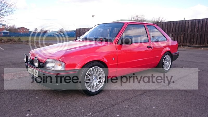

Took the Escort for a test drive this morning, what a difference......really quiet, smooth, and a little flyer now!!! Soo happy!!! :D
Few pics after lol. :D

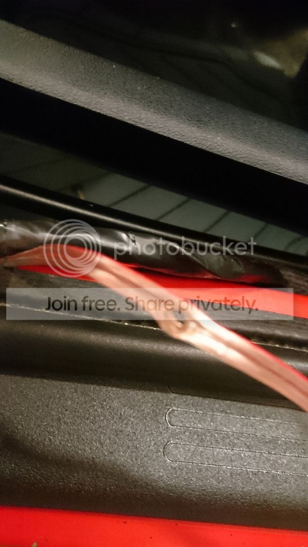

Failed it's MOT today, horn decided not to work on test! :cry: :roll:
Will be fixed tomorrow, think it's blown a fuse.....as yesterday the isolation switch threw a hissy fit, flattened the battery, and lights etc were going crazy....so I went and took the cables off the switch and connected the main cables direct to the battery how it should be.
Just need to remove switch and fill the hole in the scuttle panel. :)

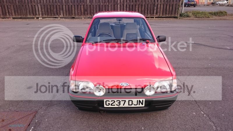

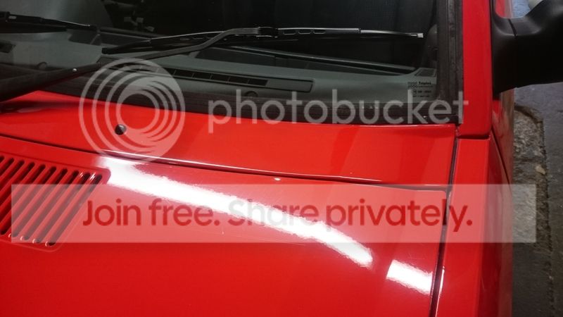

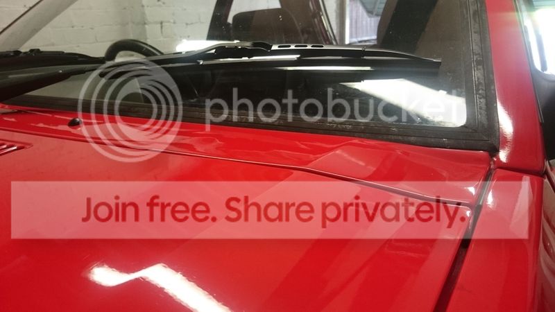

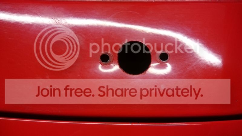

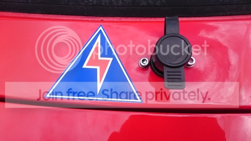

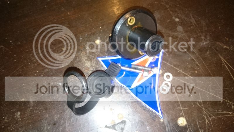

The last pic of the car with
This stupid thing
And off

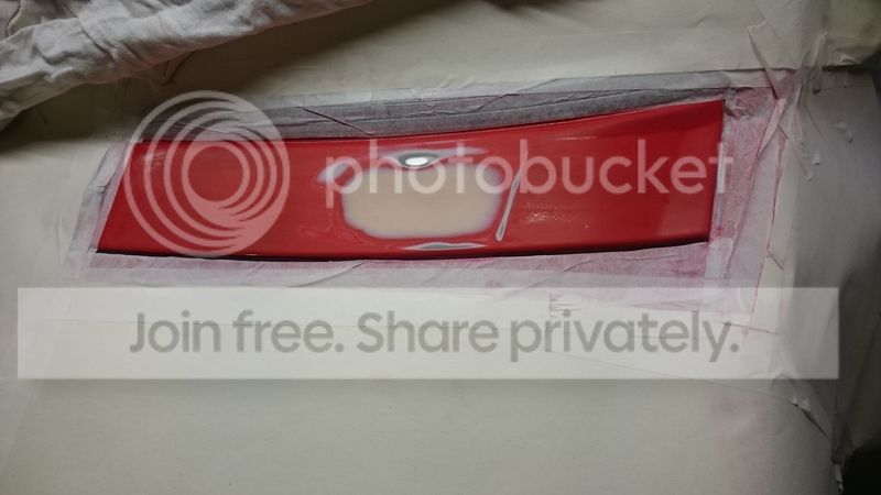

Hole filled, and sanded back.

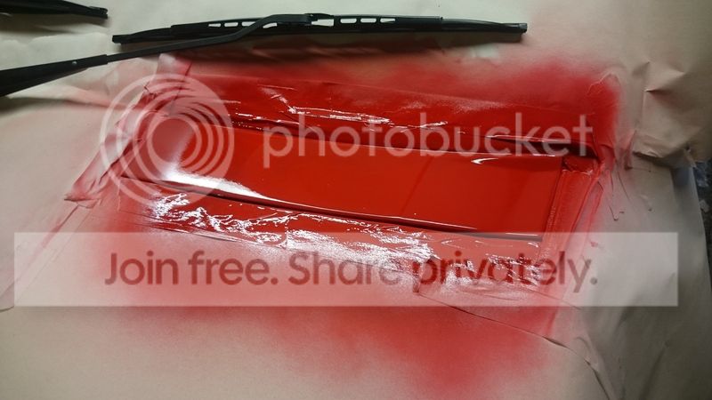

And painted
Just need to let the paint harden, then blend it in. It's not perfect......but first time I've filled a hole in on a car, and better than that switch lol :)

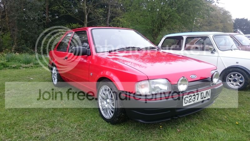

First of all, a pic with no switch in the scuttle panel. :D

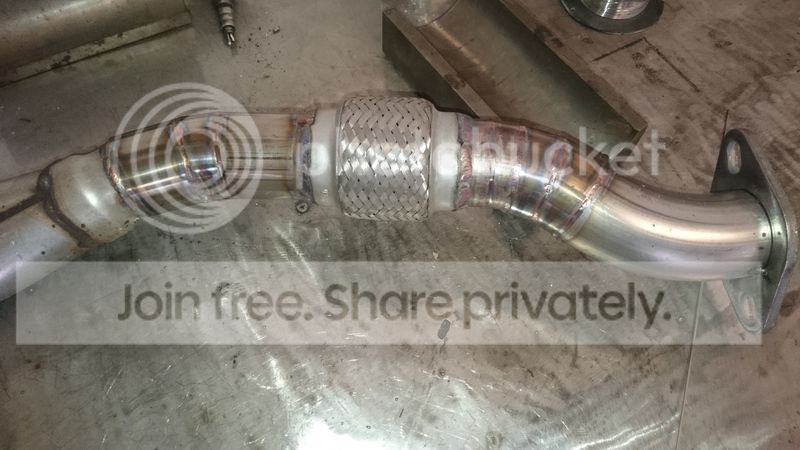

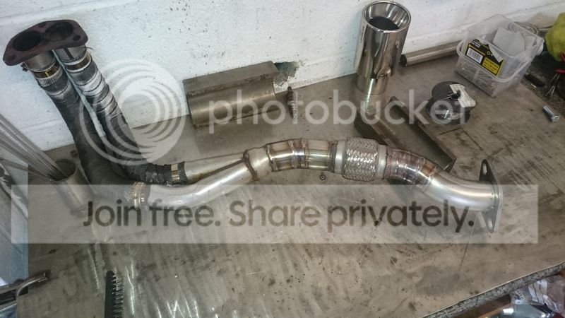

Then, got a custom longlife exhaust system made. :D
Downpipe silencer cut off, 2 1/4" bore to flange.
2" bore from downpipe back with 2 x silencers.
2 1/4" rolled out tip.
