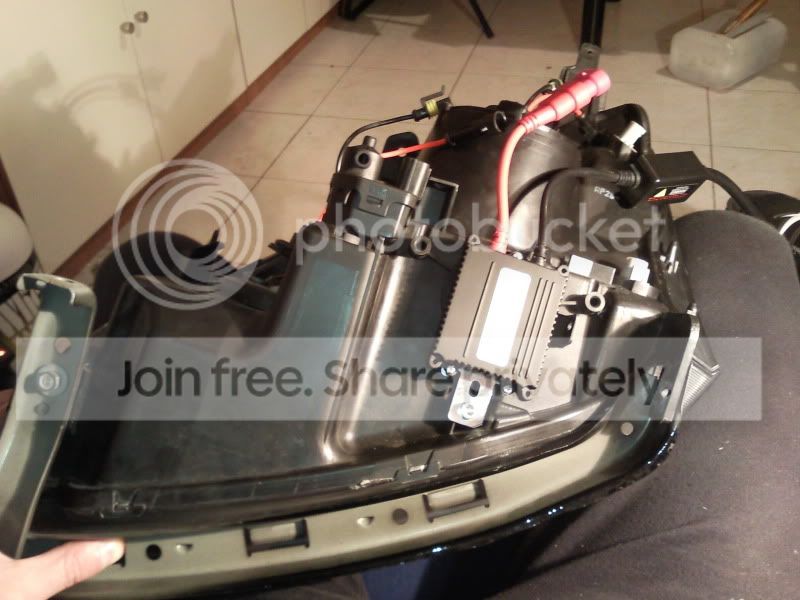

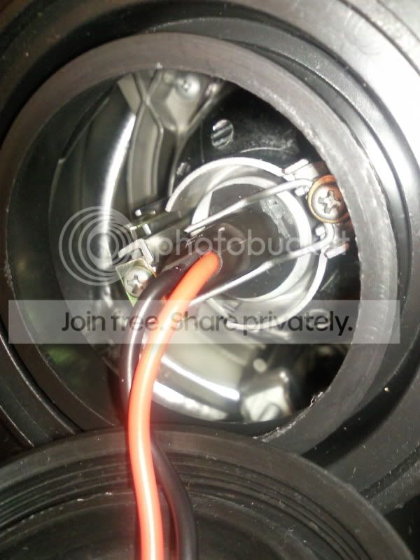

By sendai
#2466922
crooky88 wrote:I fitted an 6000K 55W kit from hidsdirect.com today, it wasnt diffilcult to do, not even that awkward so dont be afraid and looks really good, a worthy upgrade!
I also fit a 6000K 55W for low beam/PIAA leds and a HB3 35W 6000K slim kit for the hi beam. for the hi beam I used the original oem ballast location:
I also bought new proper headlights from DEPO cause the crap honda ones got some condensation. the DEPO units are better built, have HB3 conversion in metal not in plastic and more important they have better lents and proper vents. :thumbup:
I don't use adaptors, instead I put some bulbsprings that I made.
The bulbs sits perfect now:
