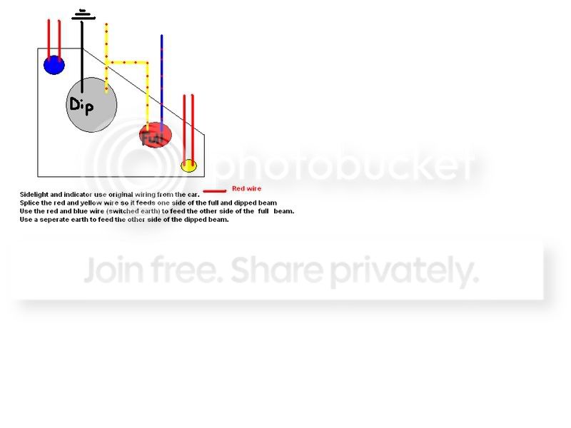

#2029020
Following this guide here: http://www.civictype-r.co.uk/forum/view ... 7#p1925267
Didnt use a relay though as it's not needed IMO
i couldnt find parts needed, connectors for indicators and full beam bulb holders from scrappy so what i done was bought some bits from halfords to wire it all up. didnt use a relay, just split the possitive feed (red/yellow cable) to the (+) on each full beam and dipped beam bulbs, then the original switchable earth from full beam (red/ blue cable) to the (-) on the full beam and ran a permanent earth to the (-) of the dipped beam to stop them going out when full beam is selected, so taped up the red and white cable as it wasnt needed
I got mini spade connectors and some 8amp wire and a cripming tool/wire strippers from halfords and bullet connectors to join and extend wires. put the mini spade connectors on the pins of the hb3 full beam bulb and the indicators then taped them up to water seal them and keep the cables from coming off.
On the last pics, you can see all i need to do at that stage is twist-fit all the bulb holders into the lights and plug the HID cableing in, with the kit, the wiring for the (+) and (-) are spade connectors so thats why i have spades on the end of my cableing from my split live and perm earth :)
was all quite easy really :lol:
Hope i'd be able to help anyone with questions as i've learnt alot doing this, so feel free to PM me
#2506253
tankskun wrote::? :?
Sorry but still dont understand the diagram. Im a dummy at the electricals!
This is what I assume needs to be wired. What about the Highbeams(Flashlight)??? how are they supposed to be wired in the circuit?
Im stuck! Any help will be apprieciated.
so is this diagram right?? :scratch: :scratch:
