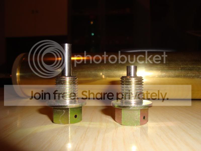

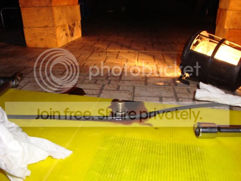

I opted for Motul :thumbup: and Spoon Magnetic Drain set as brands. the oil syringe I buy it from a local shop.

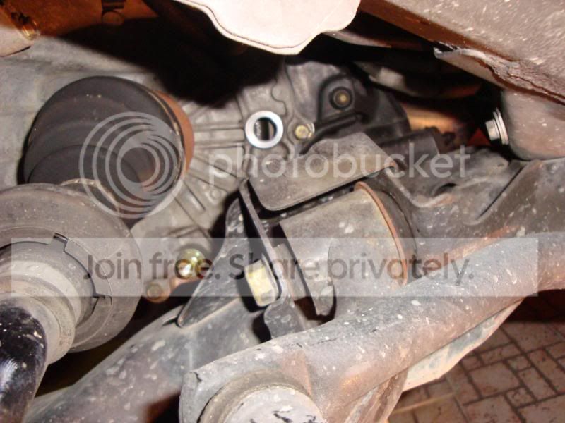

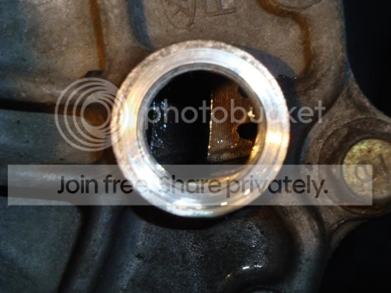

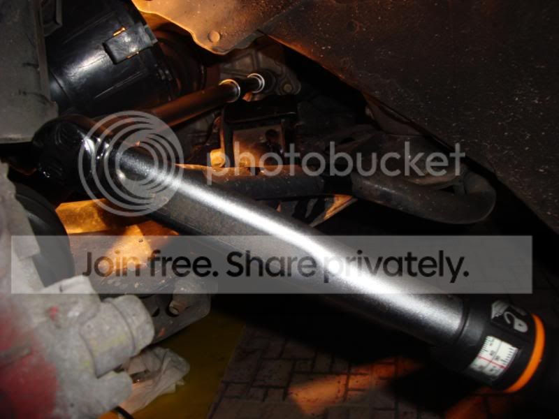

the drain bolt of gear box is located just under the right driveshaft. open it up, drain the gear box oil and replace it with the magnetic one. in the gear box will "go" the bolt with the short magnet .

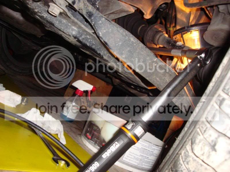

gear box drain bolt torque is 39Nm

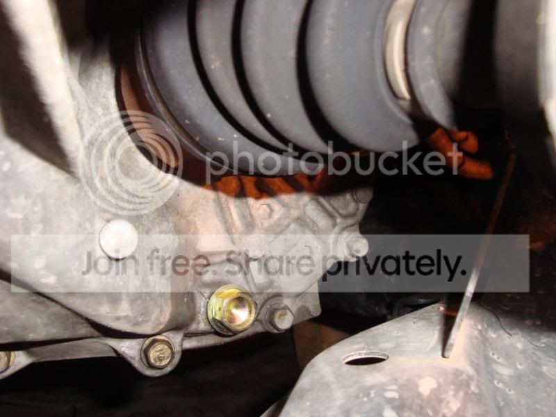

the fill bolt is located above the same right driveshaft,
so fill the gear box with oil using the oil syringe. the car must be at straight level to fill it right. the quantity is 1.7 l. you must fill it, until the oil inside the gearbox reaches the fill drain level.
put the fill drain back. bolt torque is 44Nm

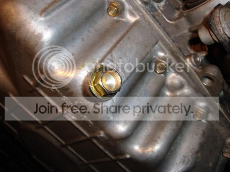

as for the engine oil I remove the drain (with the oil inside the engine) and very quickly taped the hole with my finger and replace the drain with the magnetic one, with the longer magnet.
I manage to waste litlle quantity of oil.
bolt torque (oil pan) is 39Nm.
