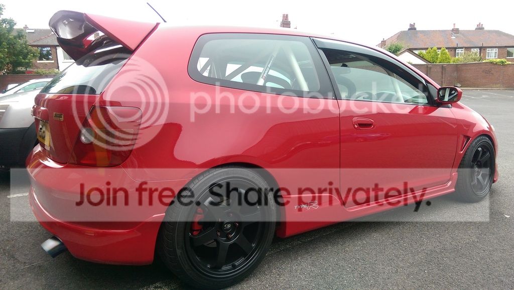

Travelled up to Grinspeed on Monday to collect car.took it for a spin on some country roads and it felt like a totally different car it almost felt comfortable. On minor road imperfections it absorbed them with ease yet when pushing on in the bends the stability and feedback was still there even with the damping set halfway, it feels like the tyres are being worked in balance with the dampers.
Also went for slightly different toe settings on the front,it used to have 0.5 mm toe out each side but gone with zero toe now and it's almost eliminated torque steer compared to before.now it's just the diff working for grip.once I got home on my local roads I really felt the difference compared to the buddy clubs, I could push on a lot more without the car skipping all over the place.
Shifter light works really well too but will come into its own on track I just need to fiddle with the settings to get it how I want.now the valve clearances are done it sounds sweet and lost that little ticking it had.
