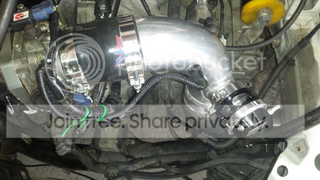

Im going to order a 90 degree pipe and run a big filter behind headlamp . Will have alot more space there
I fit the iat sensor to pipe today and cleaned out all pipes and fitted with all clamps .

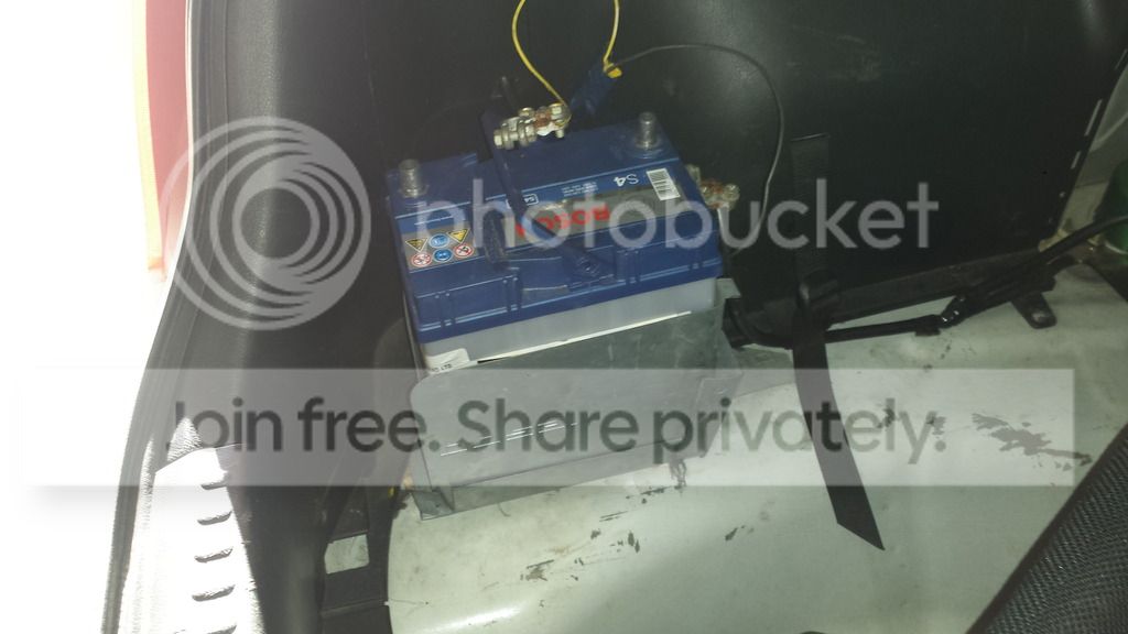

Looks great now comin on great. Any pics of the battery relocation?

going to set up the waste gate and solenoid dis week .
its a 3 port mac solenoid and turbo smart hyper 45mm gate has 5psi spring in it now .
theres a few different ways in the manual to connect gate up .
what way you have yours done jonezy ?
ill need to go to the top pipe for the controller to keep gate closed for more boost over 5 psi yeah ?
and do i just leave bottom open or run that to boost/vacuum pipe direct hhhmmmm
By jonezy
#3829023
This is the normal one to use with all solenoids so they work normally.
Some hookups work with some but cause boost creep and other issues on other as I found out!
This way will work every time and is safest if the solenoid fails will just run spring pressure
Also the springs for the gate are just a guide, it will likely run 2-4psi on that spring.
Hope those pics help. Any bother Or explanation required then just ask

Conalmcn heres few pictures of battery relocation setup
im going to redo the earths in boot and that .
Iv extra earth straps on engine and gearbox i made up aswell .
The cage its in at moment is only temporary. But has done the job . Will make new one
after ya do it do voltage drop tests with multimeter ensure its as little as possible
live should be less then 0.5v and earth 0.2v
