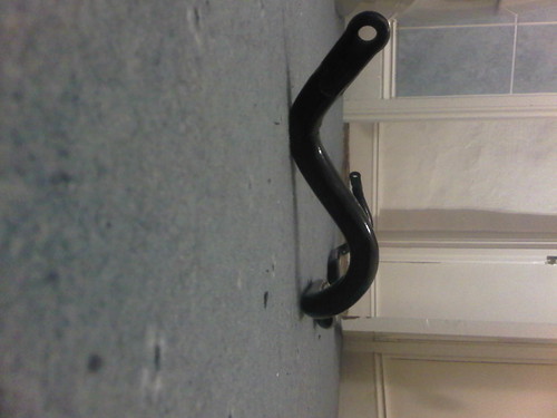

does this arb look right to you, it is a jdm rear, just looks a bit aysymetrical to me. check out the ends seem to be bent differently, wouldn't want to put this on my car in case it fk's my handling up, assuming it will even go on. what do you think.
sorry dont know how to get the pictures to work so just links.
http://www.flickr.com/photos/48282078@N07/4424936789/
http://www.flickr.com/photos/48282078@N07/4425701830/
http://www.flickr.com/photos/48282078@N07/4424936411/
http://www.flickr.com/photos/48282078@N07/4424936209/
http://www.flickr.com/photos/48282078@N07/4424936055/

Dude, that looks like it has been in a bad accident and freshly re-powdercoated just to sell on.
throw it in the bin...it's fcuked

hmm, came wrapped with honda genuine parts sticker on, maybe just messed it up when they made it and thought they'ed chuck it in with the rest anyway, seems plausible, definitely when considering the made in spain lable. But either way i agree its fu#ked. will try to get replacement, too expensive to chuck.

ARB should be perfectly symmetrical buddy, thats definitely been bent by something.
The end nearest the camera looks ok, the other end is fcuked.

yeah would have to agree, my brother has just bought a front and rear nuespeed arb for his S3 and they are perfectly symetrical (and well made might i add) on this the bends are to differing degrees and in directions as well as having different distances between the bends.

Thanks for the comments guys :roll:
Have any of you ever actually looked at your roll bar?
This is correct, they are asymetrical.

Front and Rear together:
Come on guys, maybe check things out before typing comments that are potentially harmful eh?

Unit 8 wrote:Thanks for the comments guys :roll:
Yeah, I fitted mine..shows how much notice I was taking of it.. :lol:
I honestly never knew the rears were asymmetrical, I thought the fronts were, but I've fitted several rear bars to different CTRs and swapped out droplinks countless times and never noticed that....whys that then steve..?.to miss the exhaust or something..?
Or is it asymmetrical, like a golf..? :wink:

I guess as the ARB can also sometimes be referred to as a 'torsion' bar this would make some sense
Torsion: Torsion refers to the twisting of a structural member loaded by torque, or twisting couples.
The humps in the middle are the torsion/twist load points...
I bet (and am interested if someone would check) when put on the car and loaded up the bar is symetrical.. so this loads it with torsion stress so when one side of the suspenstion moves this is amplified to the other side to improve reactive response... :sleeping:
God.. I really am talking bollox now but it makes sense in my old engineering head.. :lol:

It probably would be installed with some load just to make sure it is firmly in place, but not to the extent that it becomes symetrical. with stevies reccomendations i had a look under the rear of mine and from what i could see it is still asymetrical (the EDM one, havent taken it off yet). i can see what you are getting at but at 22mm thick that would be some extreme loading. but then i may be wrong, again. :salut:
