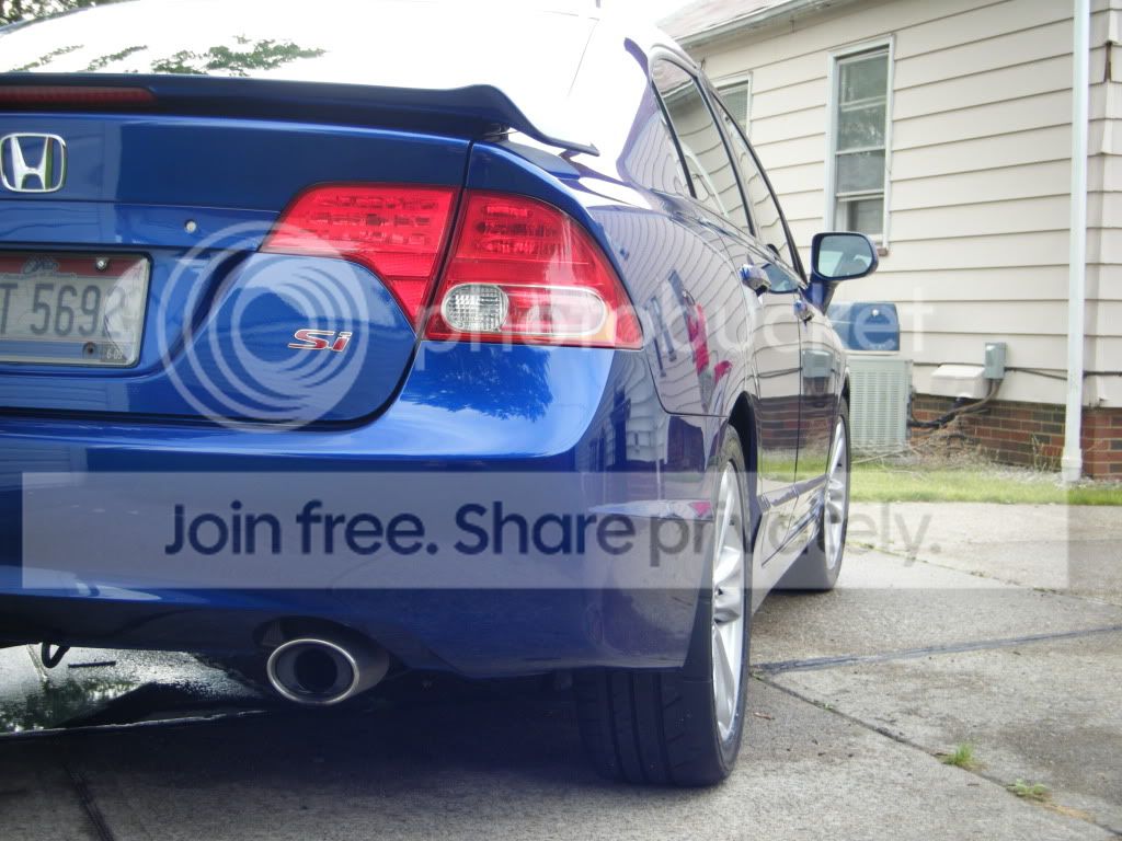

pic of 225/45 in 7inch rim , they don't bulge too badly
The WRX does indeed have 17x7 rims, but the OEM size is not 225, it's 215/45. The WRX STI has 17x7.5 with 225/45 tyres.
Like Julian has pointed out. Very few, if any manufacturers fit 7" rims with 225 tyres as standard. The mass bulk of cars running 225 as standard have a 7.5" rim. Our very own Honda's for example. FN2 and FD2 both run 225/40's and both have 7.5" rims.
